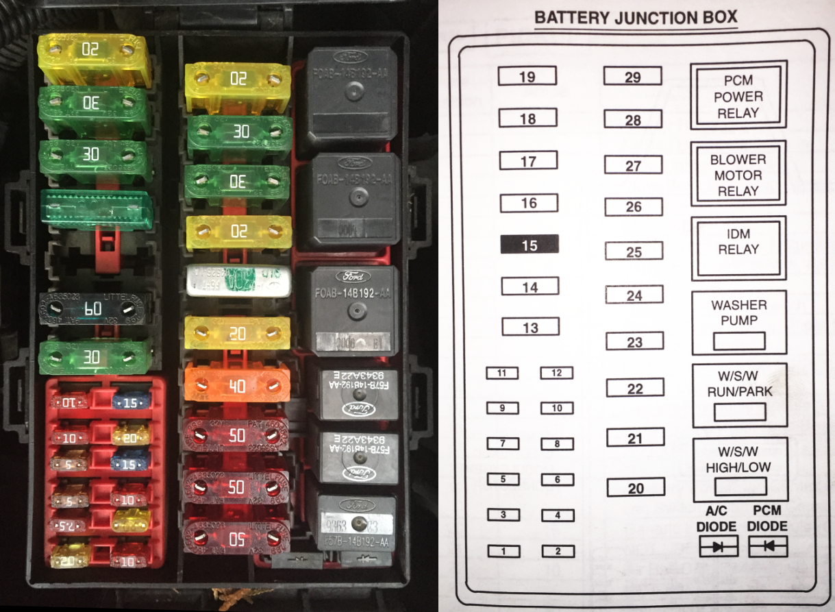

Not sure if the 2002 is the same in this area, but I had a similar issue and it turned out to be the IDM relay. Swap it with the blower motor relay to check.
