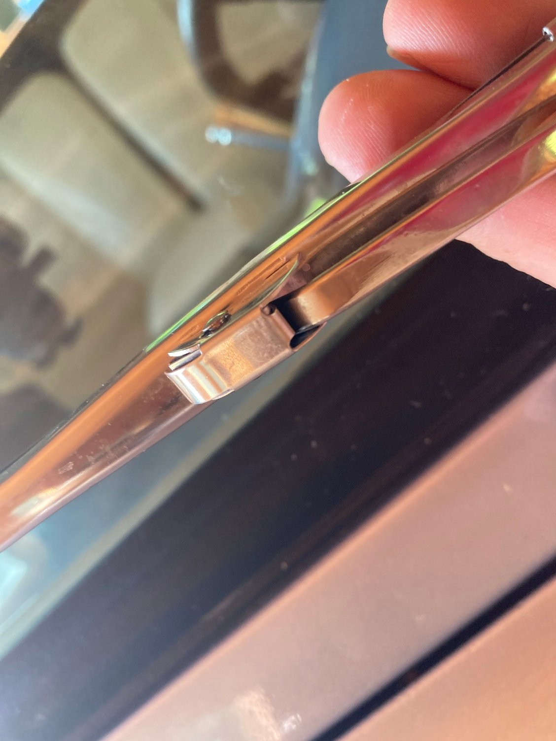

Ok….I surrender. How do I get the wiper blade assembly off the wiper arm? I’m guessing there is a release inside the place where the arm connects to the blade?

These are on a 56 F100 by the way if that’s helpful.

Looks like a "Dipped End" wiper arm. They look like this:
While pushing the blade in the direction of the arrow, rotate the blade off the end.
Edit: After much thought, I went and tried it. It doesn't always work like that. If you insert a small screwdriver and slightly pry at the arrow below, while rotating it off, it always works.

Thanks! I figured there was something hiding in that part of the blade. I appreciate the help.

Don't you push down on the opposite end of where you insert the arm..?
