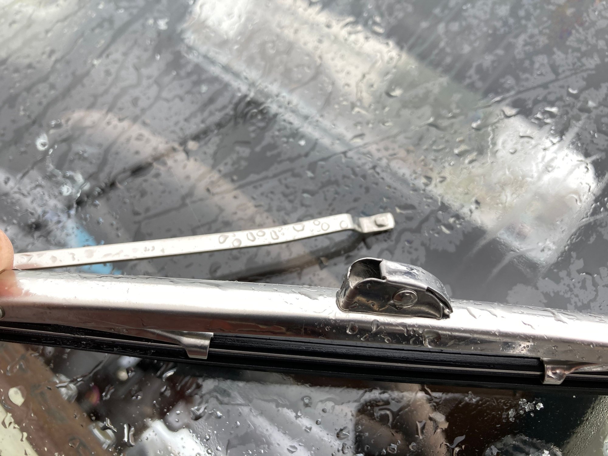

So by far the weakest link on this build has been the windshield wipers, which, unfortunately, are important about half the year here in Colorado…
After hobbling together my own motor/linkage Frankenstein solution (which isn't ideal, but it works), I bought new wiper arms and blades I believe from LMC truck. They were listed for the '52. Having never seen the original OEM hardware, I don't know how these compare, but I can tell you they're horrible! The end of the arm just kind of slips in a big opening in the blade, so that they just kind of flop around and wobble from side-to-side … WHEN THEY'RE NOT FALLING OFF! I lost the passenger blade last fall and wouldn't you know a car behind me ran over it before I was able to go back and get it. I've been running the single driver wiper this year and using very sparingly, but today as it was snowing on the way home the driver blade fell off three times! Luckily each time it just fell onto the cowl so I was able to pull over and re-install.
So, is this bad design? Am I doing something wrong? The only thing I could imagine is that you "mash" the opening down over the end of the blade with a driver pin and hammer, but even then there would still be side-to-side play.

After similar problems, I bought a set of Trico arms and blades at O'Reilly Auto. They are excellent. The arms are adjustable for length, and the blade angle can also be adjusted. They have a much better spring to hold them against the glass, too.
O'Reilly's p/n's: Arm: TRI 51-062 Blade: TRI 33-101

+2 on the better arms and blades, but I used Wesco arms and Bosch evolution wiper blades with mine... the new arms had the "U" hook on the end and held the wiper securely. I had the same problems with the aftermarket repop junk
