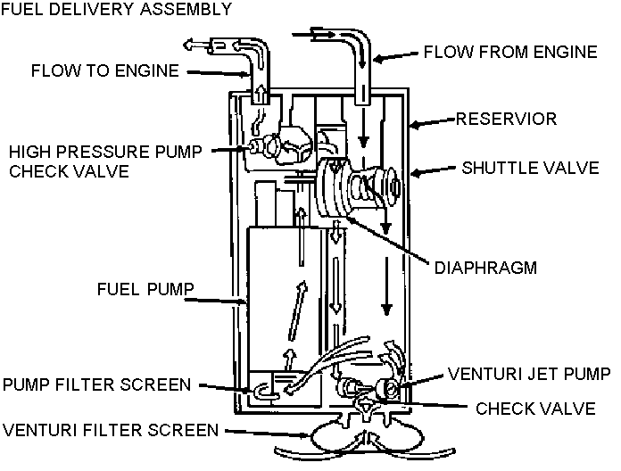

Hello, I got a problem with the 1995 ford f250 460cui gas. The problem is that when I'm running on the rear tank it constantly pours fuel into the front tank. I have looked there is no fuel tank selector. No check valves on the lines. I'm been trying to find the problem but not having luck.
Fuel pressure regulator and both fuel pumps have been replaced. Im wondering if the pumps have a check valve in them or not?

Your front tank has a stuck shuttle valve. It normally closes when the pump is not running. Unfortunately there's no way to repair it. Dropping the tank the tank and replacing the FDM unit is the solution.

Did you buy the pump or the whole delivery module? The pump is only the electric pump. The fuel delivery module includes the pump, hanger, oring, check valve, shuttle valve, sock, float sensor, and reservoir.

I have replaced the midship/front tank pump and it fixed it. There a new problem I have new on the rear tank. When running on the rear it wants to cavitate on the rear after running for a couple minutes. I'm wondering if I had the same problem with the front pump having the shuttle valve being open or not.
