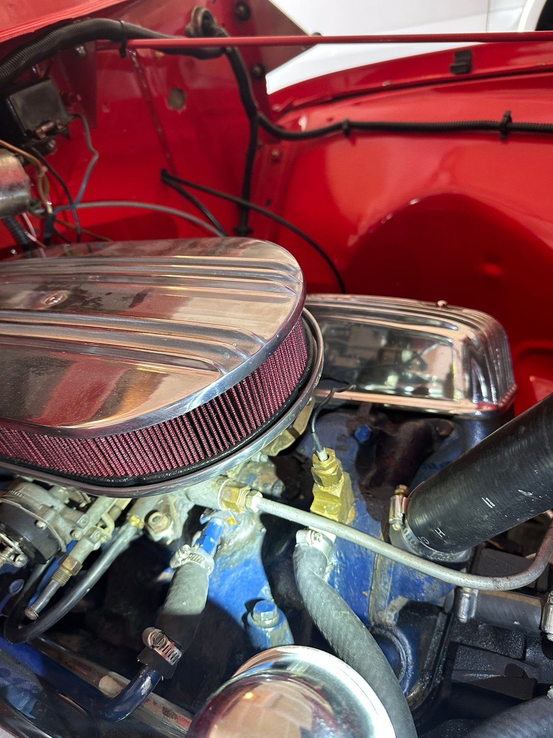

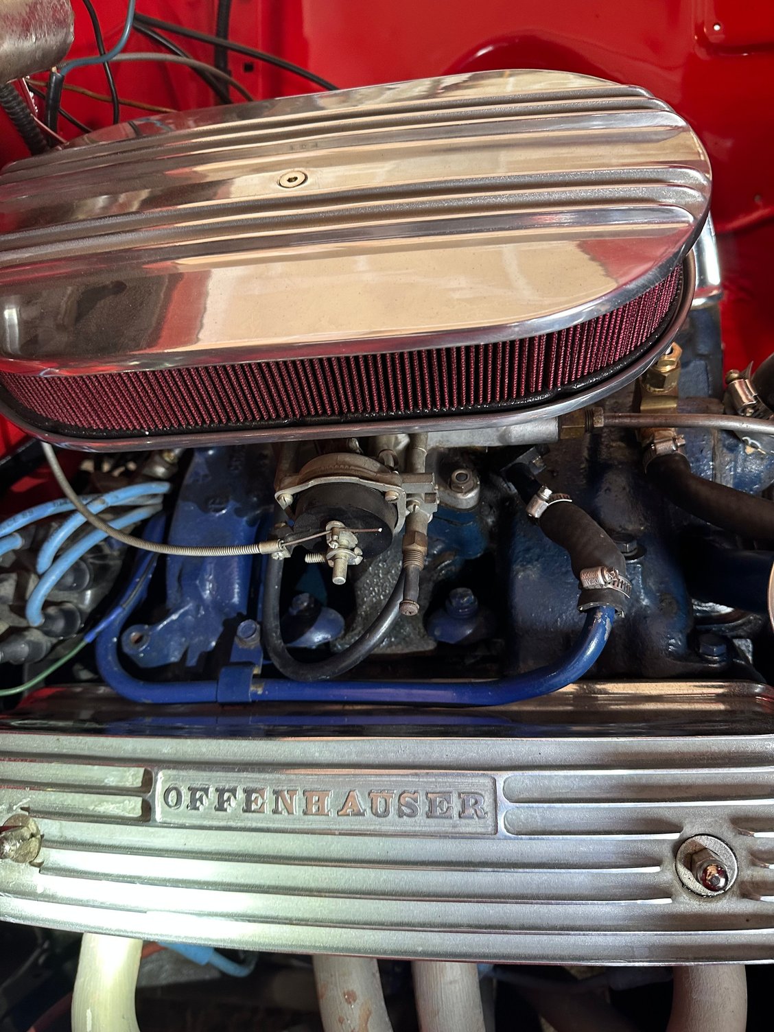

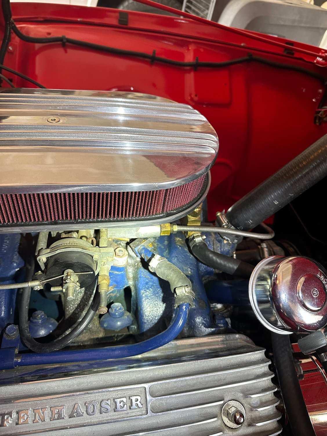

So there is a bit of a mystery to this problem. On the front of the intake manifold there is a fitting with a pipe and inside the pipe is a spring and a ball bearing(check valve) that runs around and then goes back into the back side of the engine. Is this necessary?
Old Sep 9, 2023 | 10:28 PM
mOROTBREATH's Avatar
mOROTBREATH
Joined: May 2008
Posts: 2,491
Likes: 337
From: Bakersfield, CA
PCV valve?
Can you post some pics?
Old Sep 10, 2023 | 12:46 PM
Awuwish's Avatar
Awuwish
Joined: Mar 2021
Posts: 45
Likes: 19
From: Hanford, Ca
Ok here are a few the blue pipe has the check valve just before the rubber tube then goes into another blue pipe into the back.
