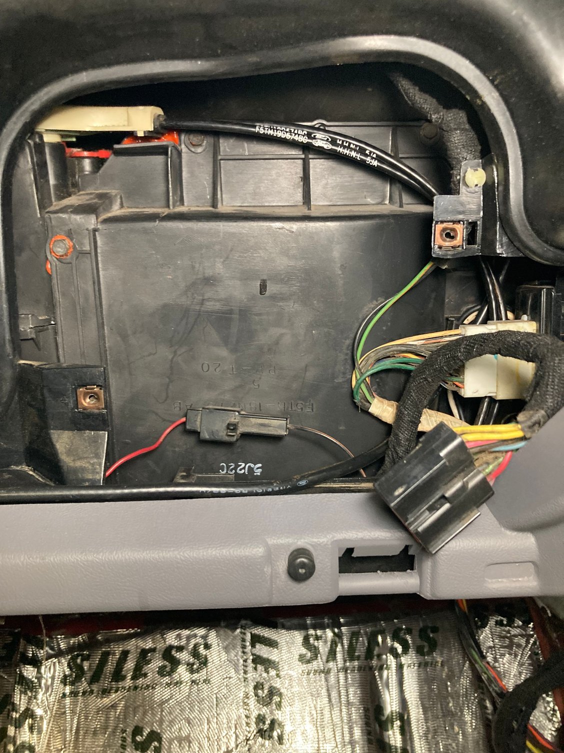

I’m putting my dash back in after pulling it out a few years ago and trying to find where or what goes in these holes.
First one is behind the dash pad. It looks like something should attach there. The other two are the copper nut inserts behind the glove box.

I’ve found the answer to the brass nut inserts. They are for the Rear Anti-lock Brake (RAB) module. Still not sure about the hole behind the dash pad.

My buddy who has an obs said that hole behind the dash pad is for a long brace that runs to the firewall.

This subforum in particular is for 3 different generations of Ford Pickups, all with very different interiors. The copper inserts would not be relevant on a "Bullnose" truck, since they didn't have RABS...so knowing whether or not your truck was that generation would have been helpful. You literally posted a picture of about 3 square inches of dash, and expect us to know all the details of your truck. There may be some have enough knowledge to pull that off, but I am sure most of us do not.
On another note...is that sound deadening on the floor? If so, what brand, and other pertinent details? Never seen that name before...

Siless sound deadening. Has good reviews. I bought a box from someone who sells Amazon returned products. Has gone on well. I’m hopeful that the cab is quiet enough to enjoy my music and do business calls if needed.
