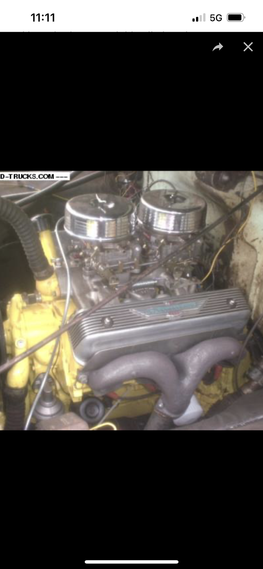

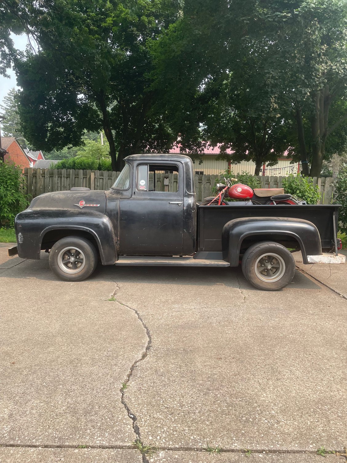

I'll have to disagree
my 56 panel with y block 2v carb, ram horns, dual exhaust, 3speed with overdrive and 3.92 gears will pull numbers of 18 mpg @ 70 mph.
I carry a coil, points, condenser, and I don't worry. It's been extremely reliable
my 56 big window with 272 4v, ram horns, dual exhaust, 3 speed and 2.72 rear gear will do 20 mpg @70-75mph and run all day long
same thing it's been extremely reliable
both vehicles still run points and condenser ignition
but when I did the big window I installed everything new or rebuilt (fuel pump, water pump, generator, starter, clutch, pressure plate , motor mounts, hoses, ignition components and carburetor. It really has been like driving a "new" 1956 ford truck. And to think it was all done OVER 30 YEARS AGO!

Those are beautiful trucks that you certainly can be proud of.
