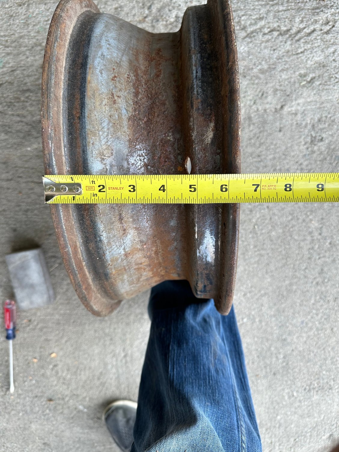

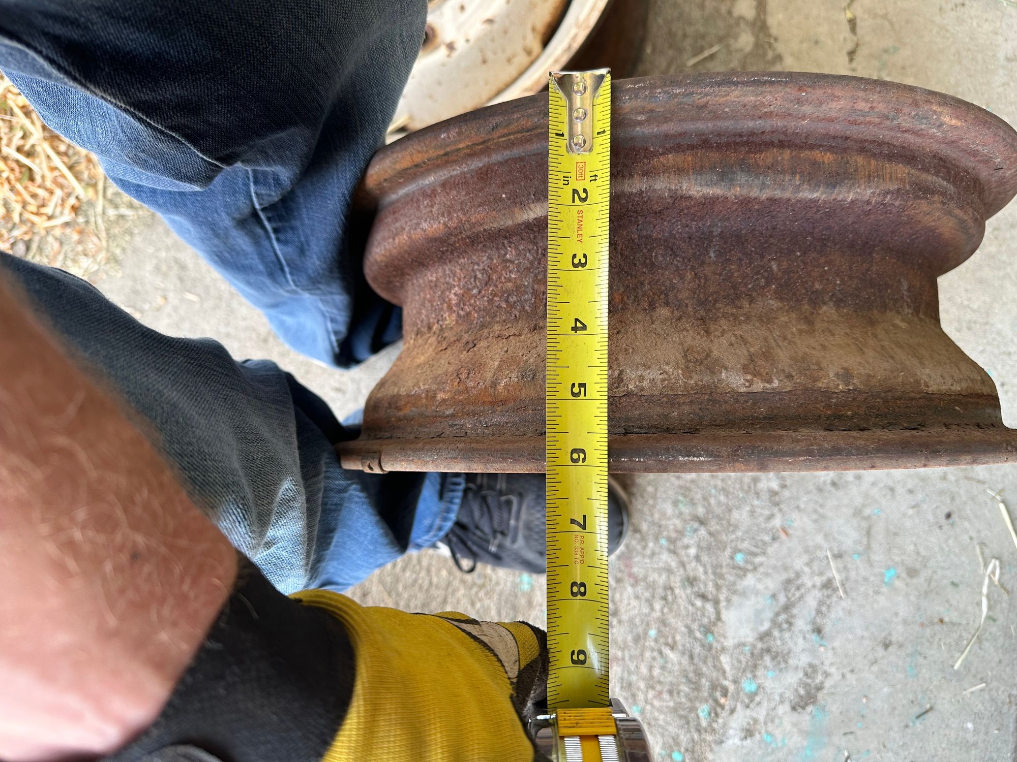

i rescued some 15” rims from the scrap yard the other day, and am not sure what i am looking at. They were intended for my ‘66 f100, but am not sure what i have, besides two incomplete sets.
I have two 15” outtie type rims that measure 6 5/8” wide edge to edge.
i have three 15” innie type rims that measure 6 1/8” wide edge to edge.
both rims are 5 lug 5.5” bolt pattern.
What am i looking at, and what width is correct for my application?
thank you in advance for the education!

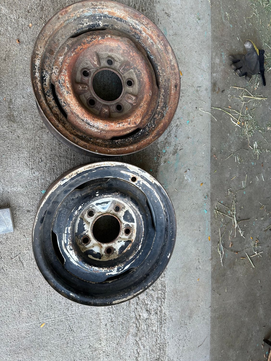

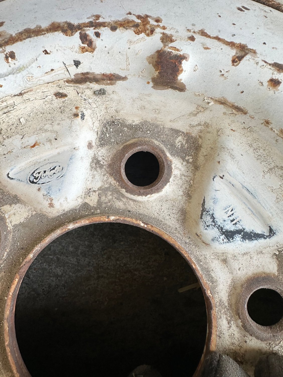

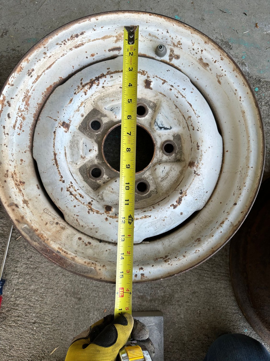

here are the 3 “innie rims”
just discovered the all are “Fomoco” and “NT” marked.
they appear to have tubeless stems in two of them

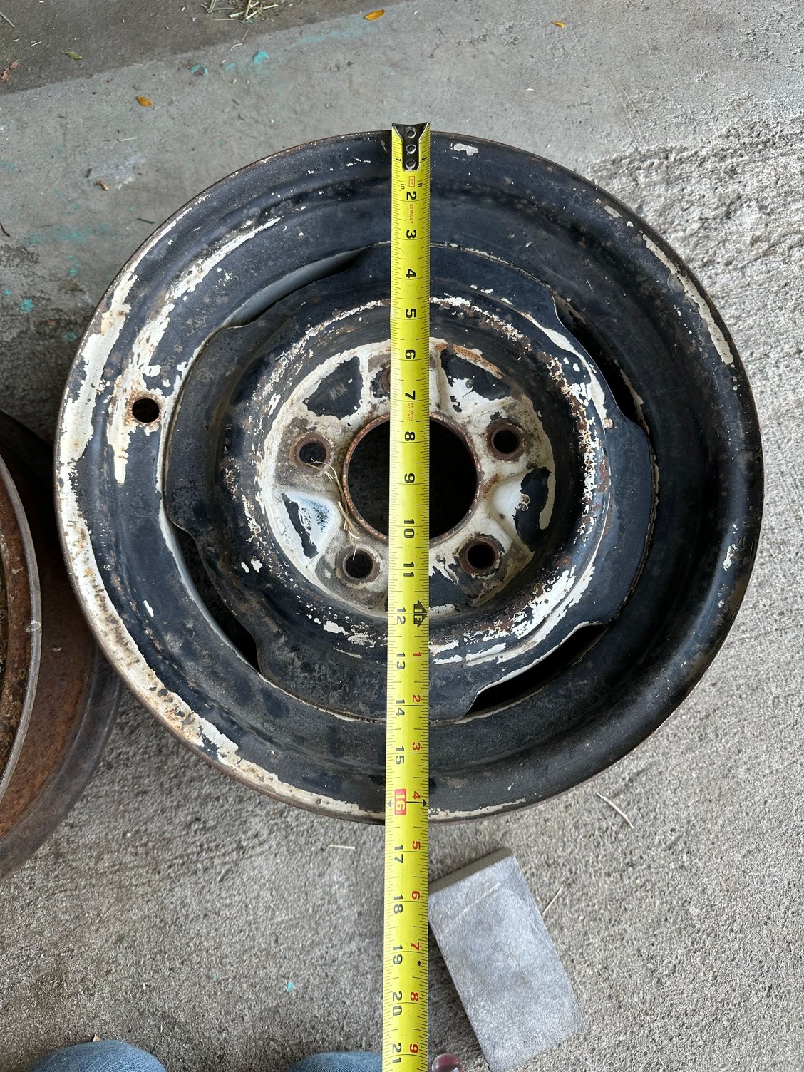

Here are the the outtie rims. Different styles but same size. One has raised ridges between the lug holes, the other has triangles.
the black/white one has “Fomoco”, “KW”, “6”, and “66” on the raised triangles.

I understand the 5 on 5.5 inch measurement regarding the lug fitment.
Correct me if i am wrong, you measure from the bead flats on the rim, making these 15 inch rims?
i don’t know how to properly measure for rim width, or proper nomenclature; “these are a (fill in the blank) inch wide rim” ?
i don’t know if these would be correct for my ‘66 f100 ??

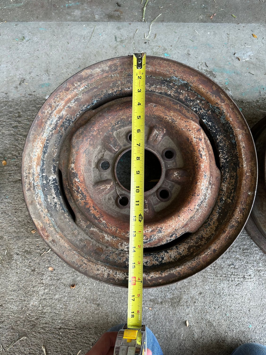

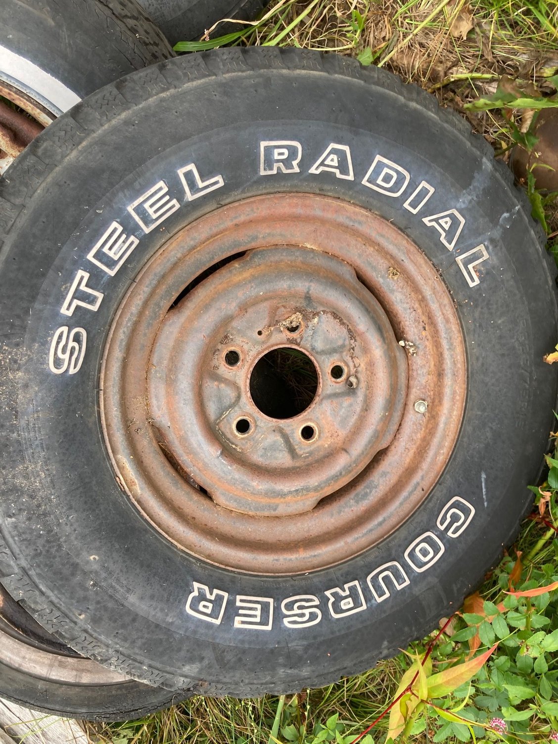

Here is another style innie rim, whats this to?
I found this, which would make me think OP has 1949-1964 rims in first picture?

Ford measured their wheels from inside the beads. The one with the tape measure looks like a 5.5" wide wheel which is what you want for the trucks. The cars came with narrower rims of 4" and 4.5" on some.
Thank you! Thats one of the pieces of info i needed, and i can now sound halfway intelligent.
so….
The three innie rims i have are 5 inches wide.
The outtie rims i have are 5.5 inches wide.
Am I totally wrong to run the innie rims on my ‘66? I presume they are still truck rims, not car rims?

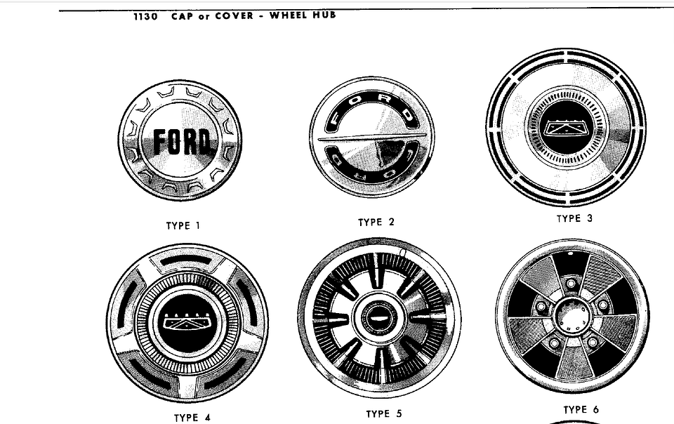

I’ve been told they stopped the “bottle cap” style hubcaps (innie rims) in ‘65…..earlier based on the link posted earlier in the string….. i have a reprint of a Ford sales brochure from 1966….. has pictures of both types of hubcaps.
Both types
Innie rims.

In 1966 the F250 and F350 series only came with Type 1 innie hubcaps. 1966 F100 had more options. They could come with either Type 1 innie or Type 2 outie hubcaps as well as Type 5 full wheel covers.

Here's a 1966 F100 2WD with the Type 5 full wheel covers. For the F100 4x4 they removed the centers on the front covers so the hub could protrude through the caps.
