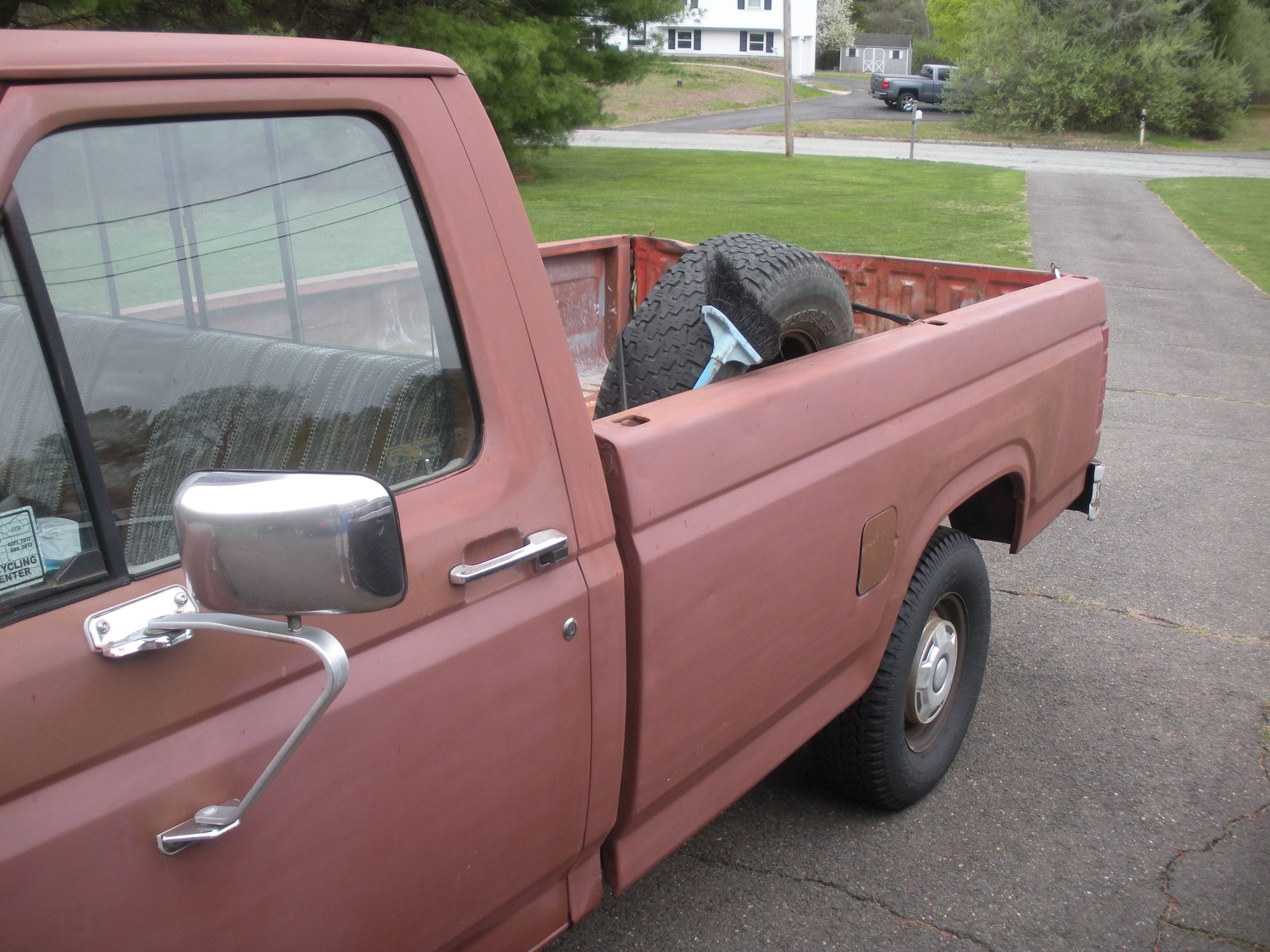

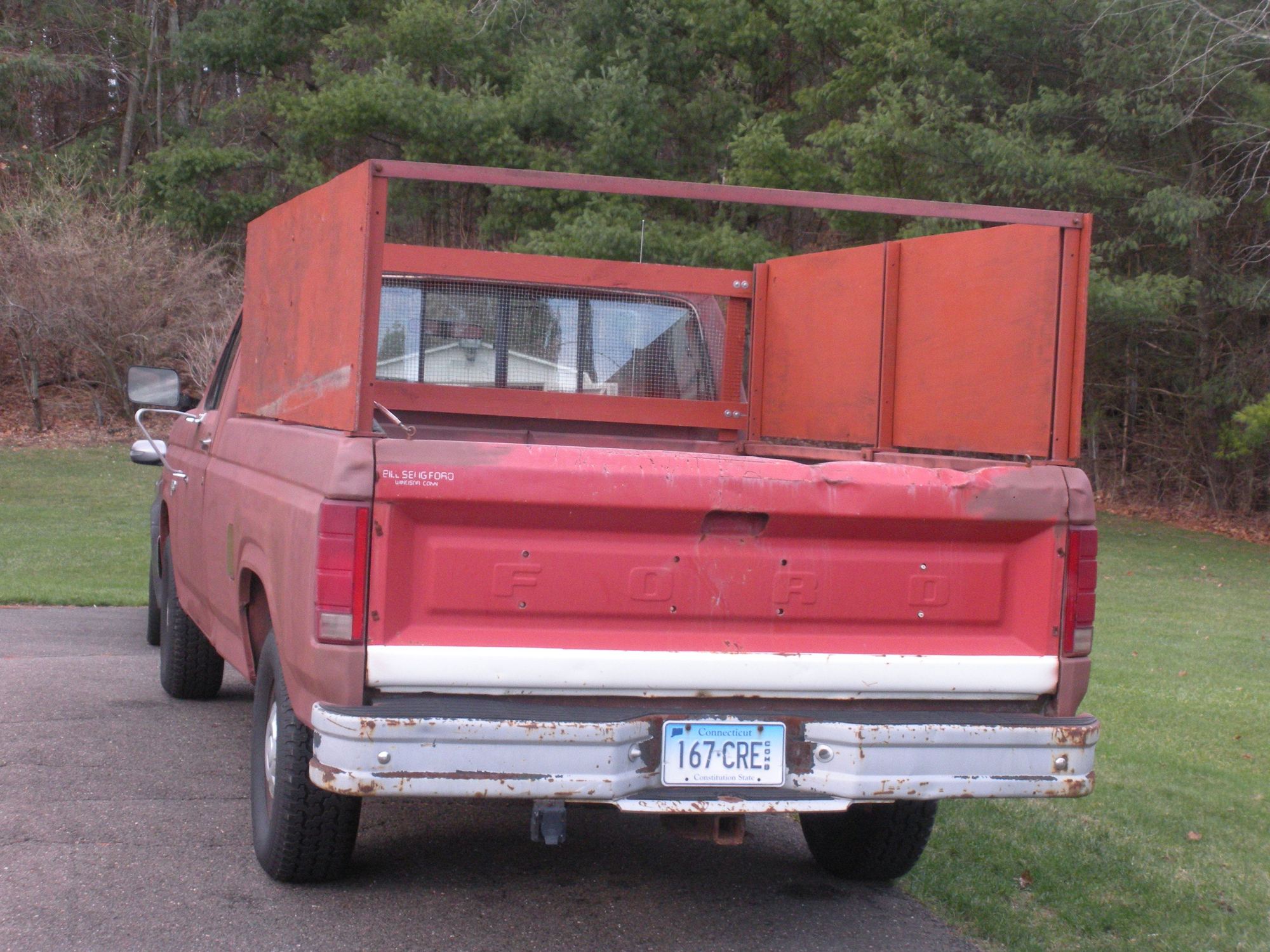

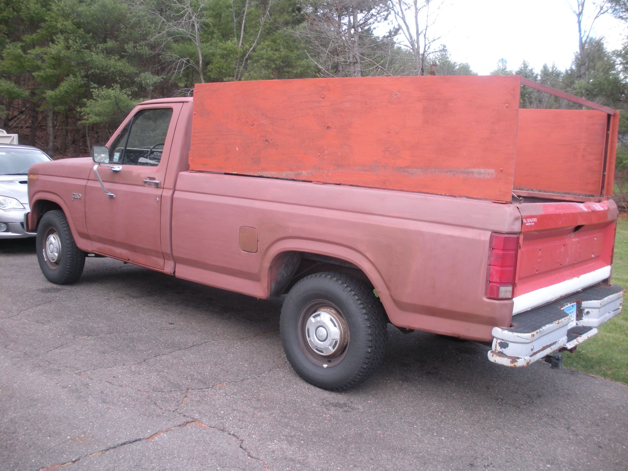

I'm thinking the side are straight from front to back. Let me know if you need more or better pictures.

I did go out and measure the distance from the top, inside rail, on the bed, its 65" wide front and rear.
