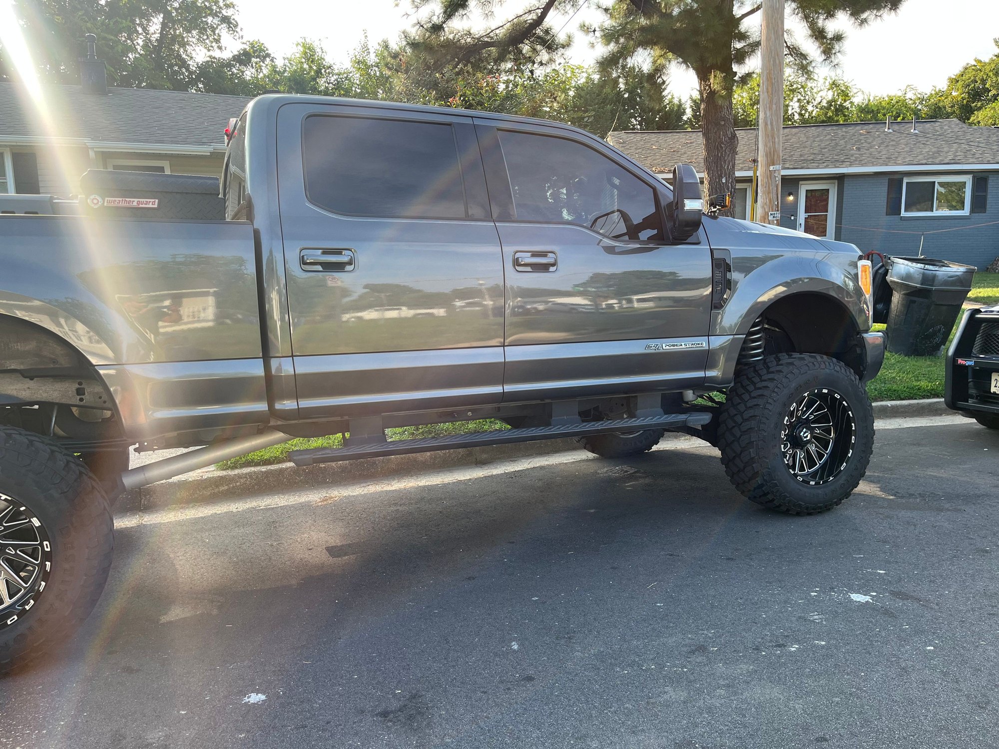

40 years of age. I feel like it’s a low rider compared to my daily driver
2018 250 powerstroke, 7.5” and 37”
