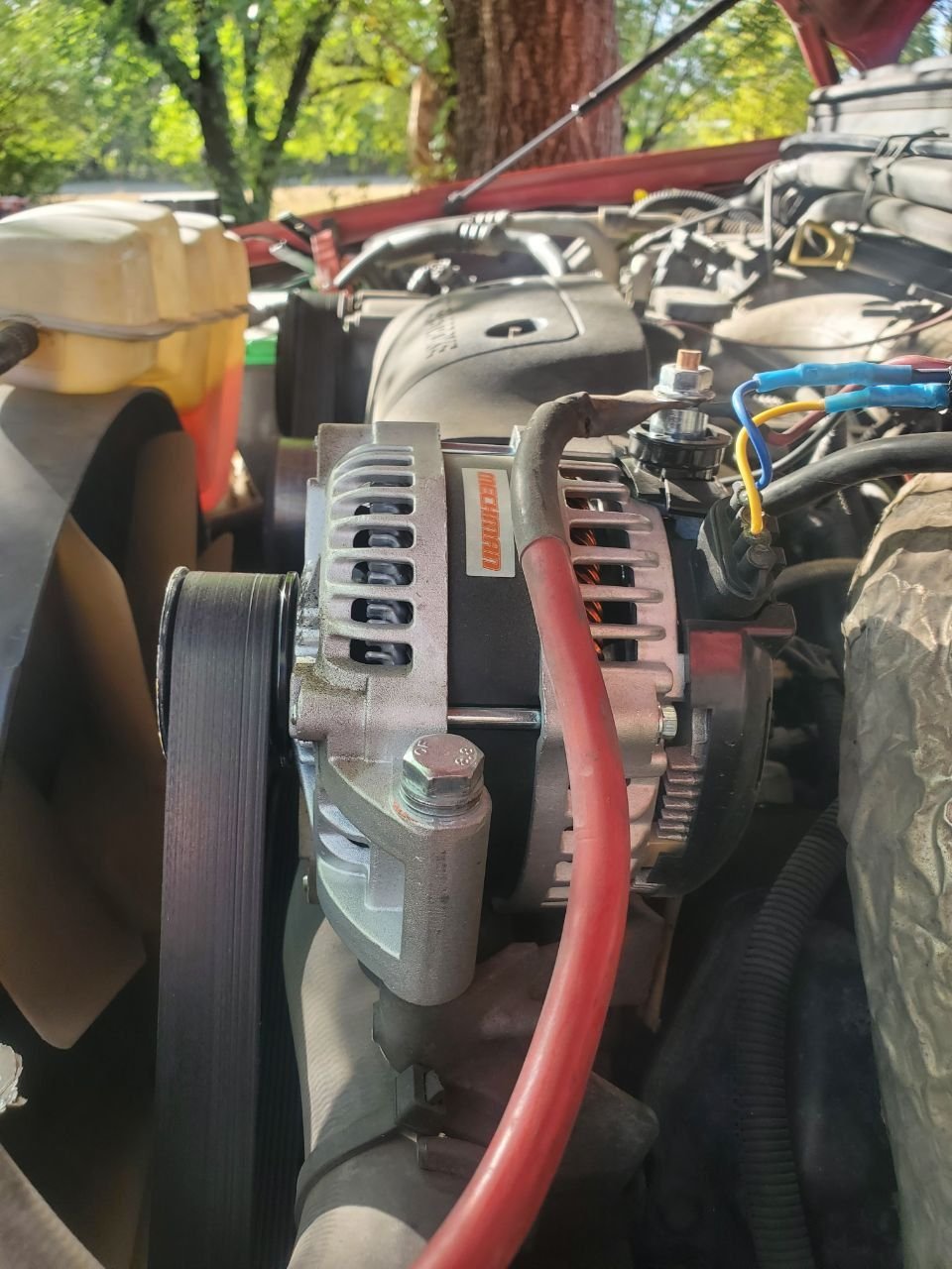

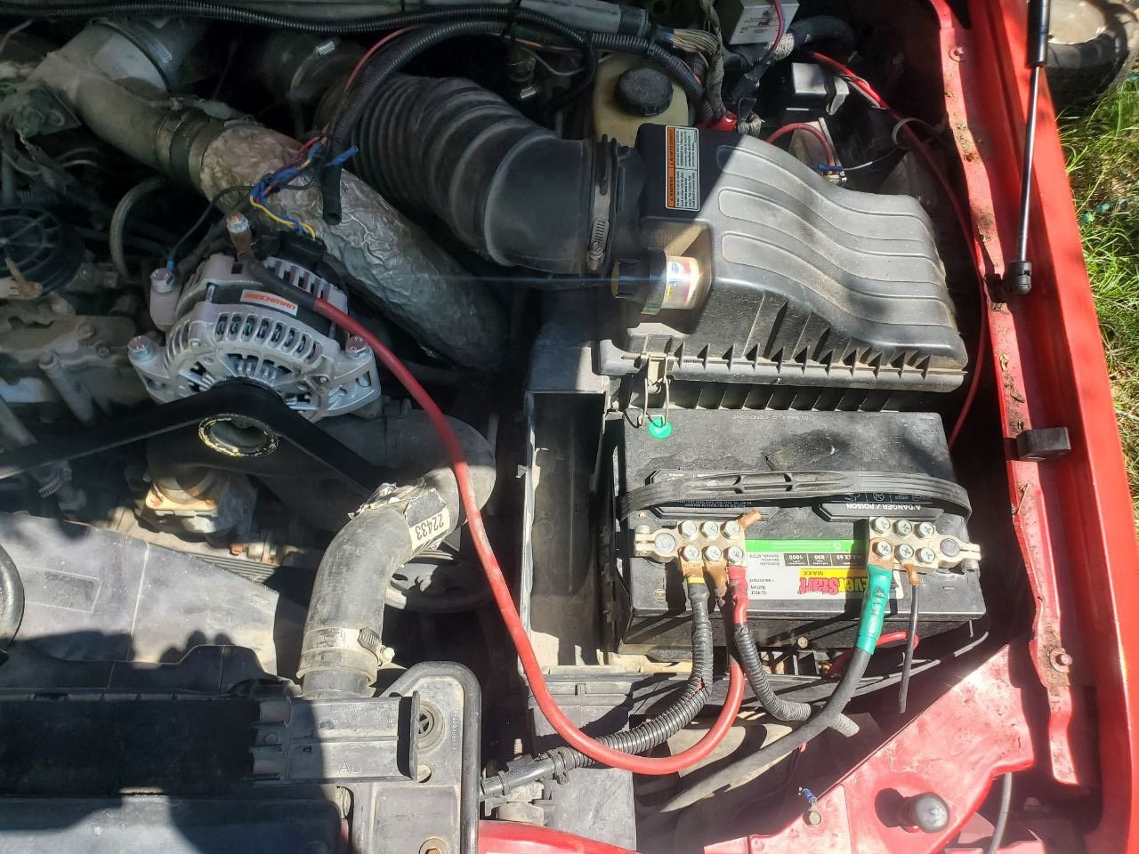

the stator on my alternator was shorted to ground, had a 2 amp draw.
replaced the Alternator with a bigger one,
MechMan 320A and trouble is gone.
I made sure all cables are clean, and tight
OBS-MD
