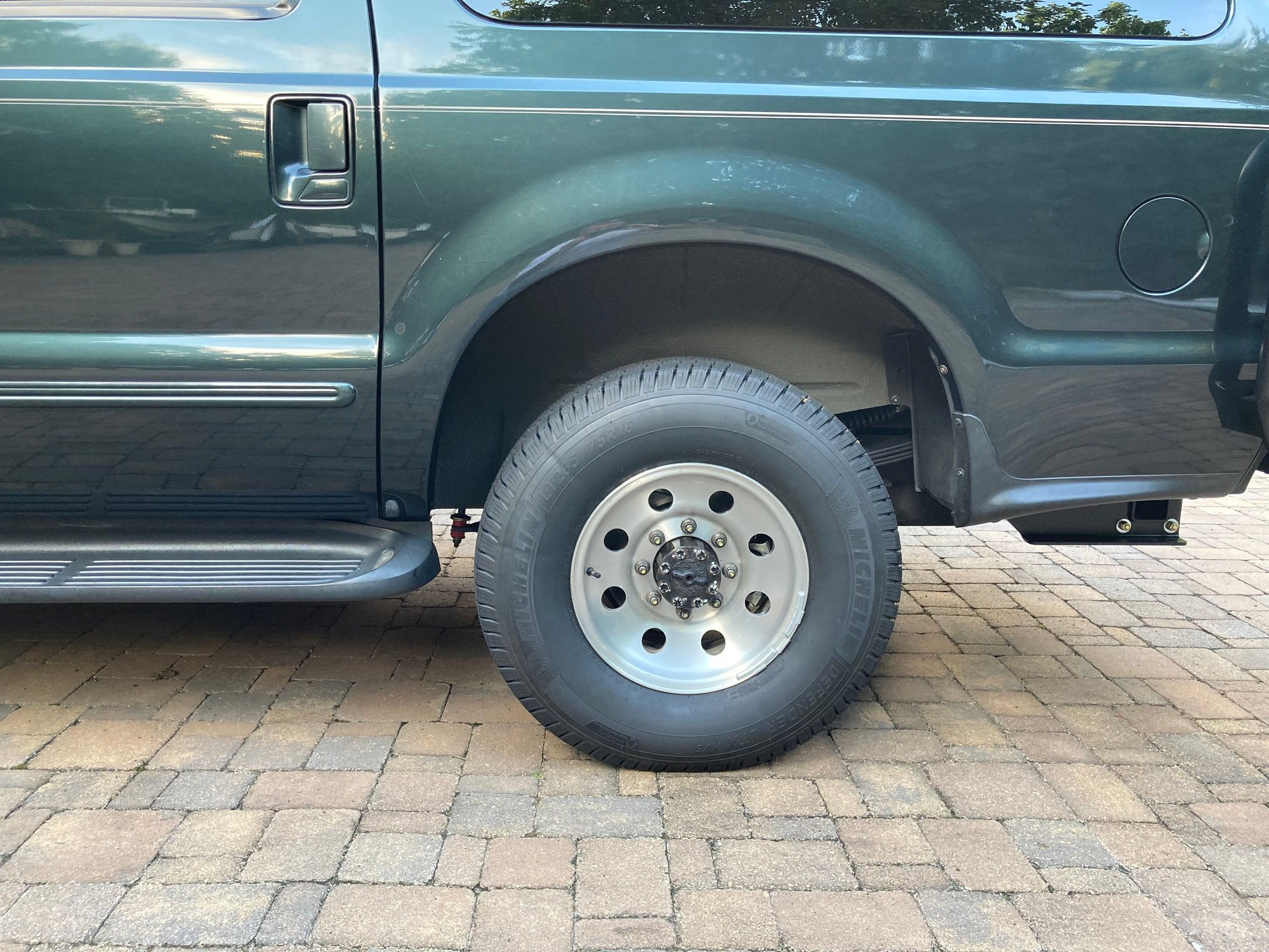

My 06 X is mostly stock. I replaced the stupid high lift on it (it's 2wd, previous owner wasn't going four wheeling, he was mall crawling) with back to stock spec springs. Issue was the front coils are not exact. They couldn't find stock spec coils at the time so I ended up with slightly stiffer and taller coils, equivalent to slightly less than 2" lift. The rear I balanced out with 1" leaf spacer blocks. Anyhow, it's near stock and I have stock sized tires on it 265/75R16 (I tow an airstream, so wanted stock size). All that said, I'm thinking of going slightly larger on my next set of tires. Something equivalent to 33" diameter.
Has anyone put 285/75R16 tires on a stock X? Any issues with clearance at full turn?

Both my Ex's are four wheel drive, so may be different, but I've run 285/75/16 on them both for 20 years.

285’s will fit your wagon just fine without any rubbing, most larger tire rubbing issues, like my 35”s at full steering lock are rubbing on the front leaf springs, RWD rigs have more clearance due to the coil spring setup so you will be good to go.

I have a 2000 2wd Ex with a 2" lift and tried 295 tires and they rubbed the front trailing arms so I went with 285 Cooper AT3's, great all season tires.

I've been running a 285/75/16 on both trucks including the wife's 00 Excursion 2wd for years with no rubbing issues. When I tow though, it's with my 00 F350 4wd. The last time it needed tires I notices the 16's seem to not have as many choices as in the past, so I decided to go to 18's on both trucks. For her Excursion, I installed 275/70/18 Goodyear Wrangler with Kevlar and have been happy. They fill up the fender wells nicely and also picked the truck up a little to boot...maybe 3/4". The 285/75/16 is just shy of 33" and the 275/70/18 is just over 33", while it's also a bit narrower. I put 295/70/18 on my F350 and would be willing to bet they'd clear on the Excursion...
