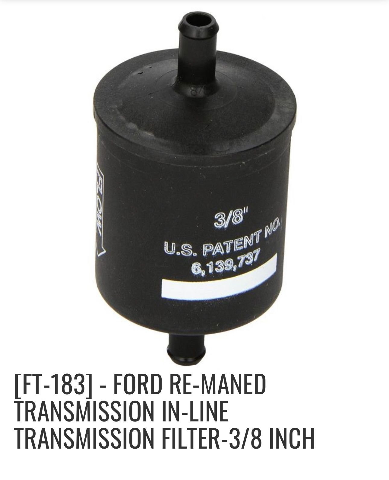

I got one of these for my transmission and was thinking might as well add one for the hydro boost. Anyone running a filter on their system looking for recommendations on where to place it.
Thanks for the help

If you are thinking about the power steering system many have done so with it near the cooler.
I have a screw on Hydraulic Oil Filter mounted prior to the cooler and it adds about an extra 1/2 quart to the system as well.

I installed something similar on the hydro booster fluid return line. In hindsight though that is about the lowest traffic spot to put it. I mean in theory all the fluid will pass through the filter, it just might cycle through the rest of the system once or twice before catching that fork in the road. Of course there's the fact that it would be the least effected if the filter was ever to plug up or become restrictive, so... Coin toss I guess.

I believe I put mine in the same spot but I installed it up by the master cylinder on the return line. I installed a magnefine filter several years ago and no problems to date.
