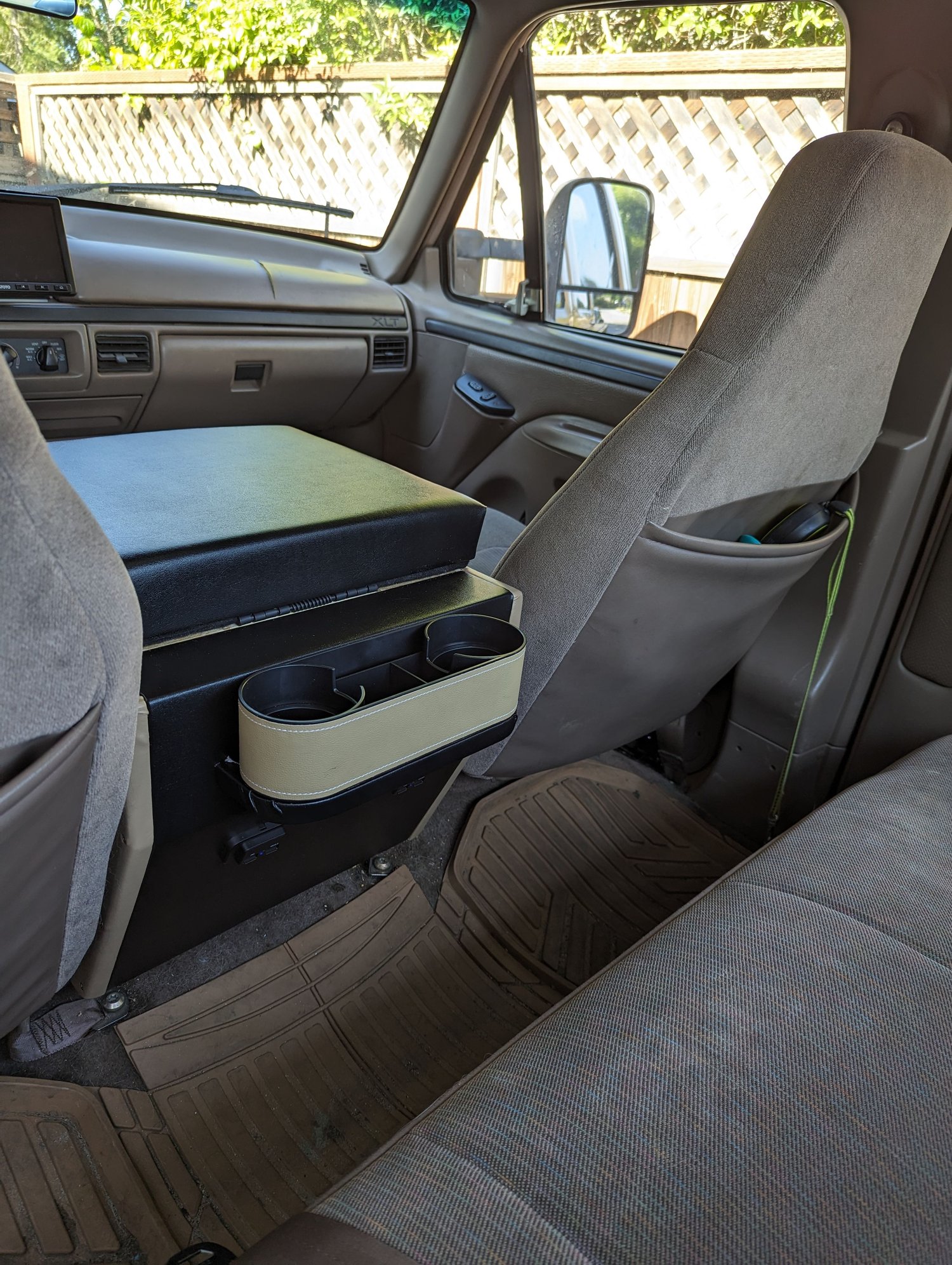

Hey all,
I thought I would share some pictures of the center console I just built for my 97 F350. It originally came with the folding jump seat which I never like and the seatbelt didn't work. I knew I wanted a center console but couldn't find one that fit or looked right. After getting one out of an excursion and modifying it to fit, I realized that ultimately I would need to build one if I wanted it to look and function like it came from the factory. I ended up using 3/4" plywood, marine grade vinyl, and a piece of textured ABS plastic from TAP plastics. I also installed a switch panel for my lights and trailer camera, a horn button for my train horns, rear cupholders from Amazon and two dual power ports for the backseat. I'm very happy with how it turned out. The only thing I may redo at some point is the pad on the center console lid. I used 2" foam and it's a bit too spongy for my liking. It works for now. I also used the front cupholders and console hinge out of the excursion center console. Overall I am very pleased with the results.

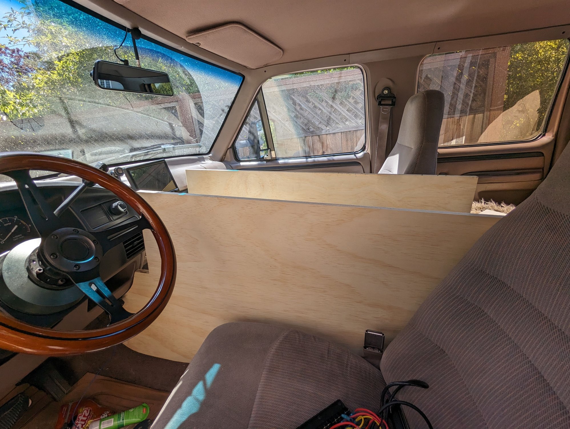

This was the first rough cut of the wood after making a cardboard template. It took several times in and out of the truck before I got the shape and fit correct.
I got both sides mocked up before I cut the tops to size. The floor slants backwards so this is a tricky measurement.
Once both sides were mocked up, I realized I had a pretty big gap next to the driver's seat.
I fixed the gap by offsetting the console but keeping the front inline with the dash. This made sure the console wasn't interfering with my leg room.

First time doing vinyl work and while it was difficult and tedious, I am very happy with the results. You can see towards the front, the pocket I made for storage. I lined it and the inside of the middle storage with black felt.
Final instal. I bolted it to the original seat frame and ran all the wiring. It really cleaned up the center console and I am VERY happy with the final product.
Added two "always-on" power ports for the backseat. Each one has a USB and a USB-C power port because the kids were always complaining about their phones dying on longer drives.
