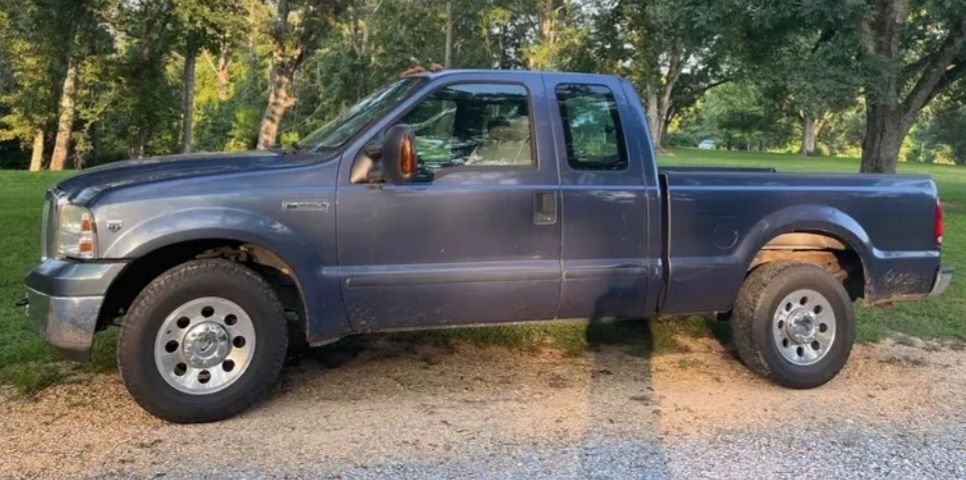

Just bought an 05 V10 super cab with 128k miles. Bad clunking, rattling sound coming from front left. Shocks were said to have been recently replaced and seem to be doing their job but I think the rattle/clunk sound is from the shock. If I grab the shock, it seems the bottom is loose. (The right side shock isn't loose like that.) Can just the bushing and bolt be replaced, is it worth doing that over replacing the whole shock, and if so, where can I find the bushing?

So I just went ahead and ordered two new shocks. Put them on today and found the main reason for the clunking.
Bushing all the way gone. Worse, these are obviously two different shocks of two different ages. I text the guy I bought it from and he said he paid someone to swap them out. I told him that only one was swapped and showed him this picture.
Anyways, 2 new shocks and less clunky noise. Sigh, yes, just less. Still hear something else clunking. Not as obvious but still annoying. Ordered sway bar end links and bushing as that's the next cheapest and easiest to replace.
