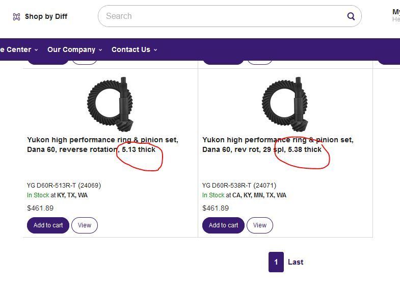

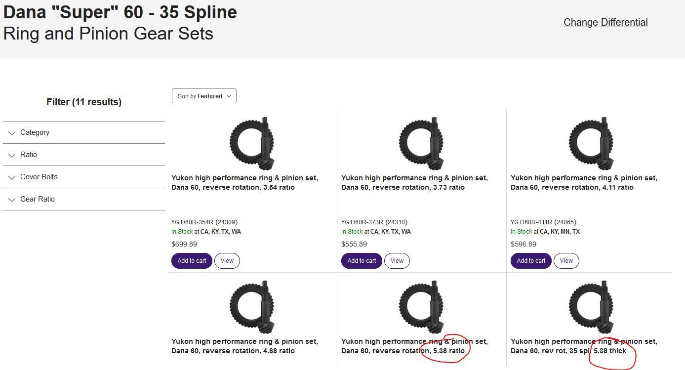

Old Aug 12, 2023 | 07:02 AM
ATC Crazy's Avatar
ATC Crazy
Top Answer: 10
Joined: Jun 2003
Posts: 12,353
Likes: 4,388
From: SW VA
OP must not be looking too hard:
