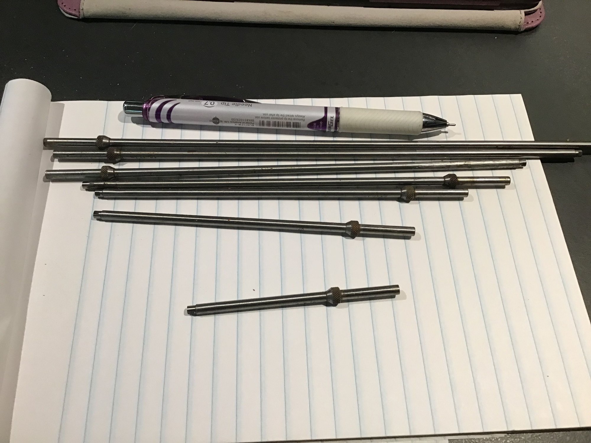

I have a “set” of these tools that were part of my fathers toolkit from when he worked at Douglas Aircraft in WWII.
They appear to be solid stainless with a knurled bead. The ends are relieved and have two flats 180 apart.
Any idea what they are and how they were used?
Zeke. Central Oregon
Different lengths same diameter

Looks to be part of a depth or width gage set. The head may have a dial gage or linear scale.

They look like part of an inside diameter telescoping micrometer set. Do they screw in to change length?
I used those in A&P school to measure cylinder diameter.

They are solid. And appear to have length markings on them. I have cylinder bore measurement tools but they are self contained.
thanks for the input, guys. I’ll look for some sort of “end gauge “ to complete them.

Confirmed……. They are extending rods for inside measurement. The flat faces turn in a recess to spin the dial. Sorry I do not have a pic of the readout. But you guys were right on the money. Thanks
