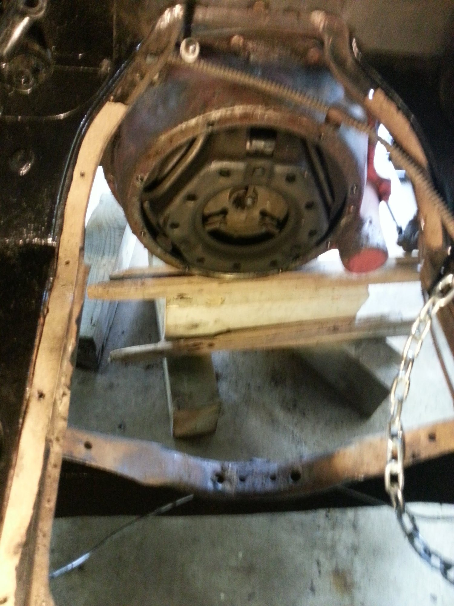

You'll also need to brace the bell housing.
