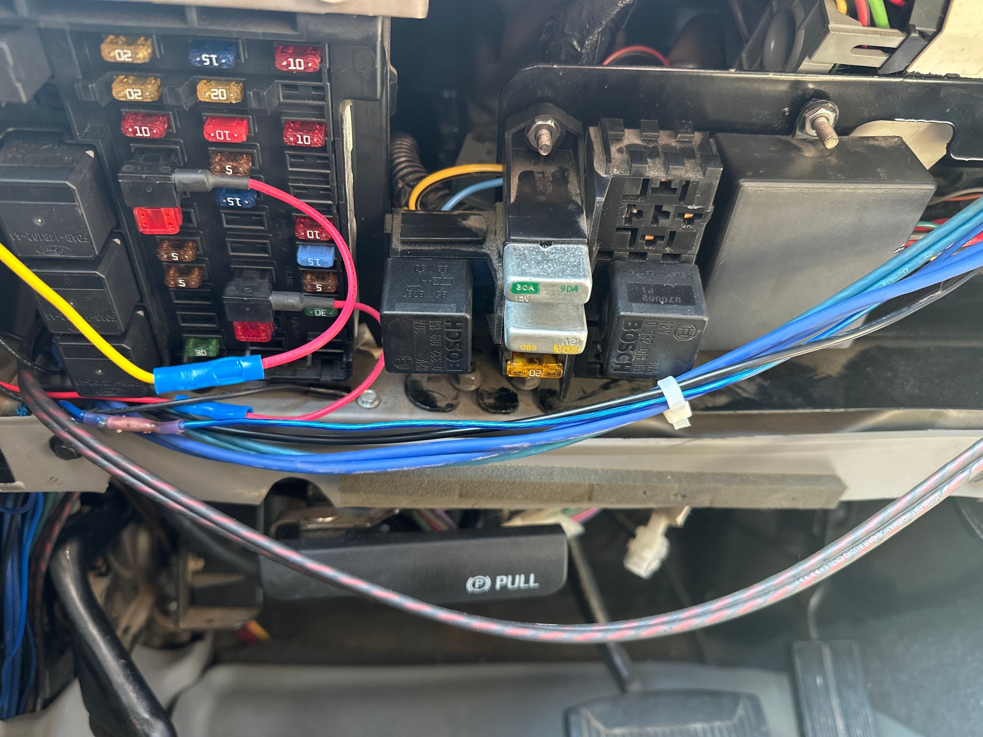

Hello, I have a ford f350 2000 with a centurion package. I need help with the infinity lights, police scanner, and dome lights not working. I have checked all the fuses and relays and all seems to be good but the lights won’t come on. I need help in figuring out the problem.

Do you have the added on fuse panel for the Centurion package electronics? My e99 had an add on fuse panel under the steering column.

There is the Main fuse panel and another right besides it. There is a black box mounted next to it with wires coming out of it.

Does your secondary box that centurion added have power to it?

Yes it does. Ever wire has power except for the purple And the pink is running with low volt with 2.88
