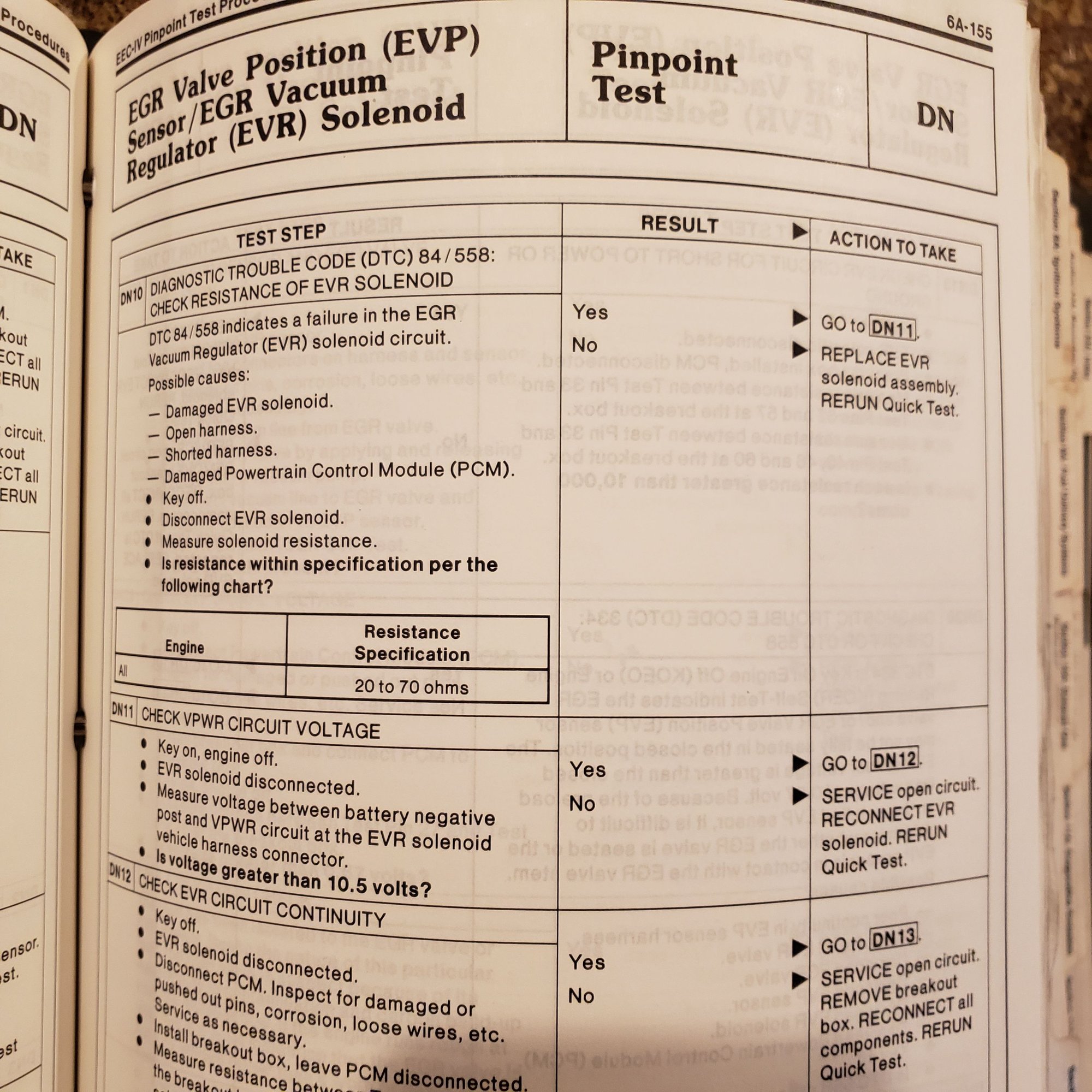

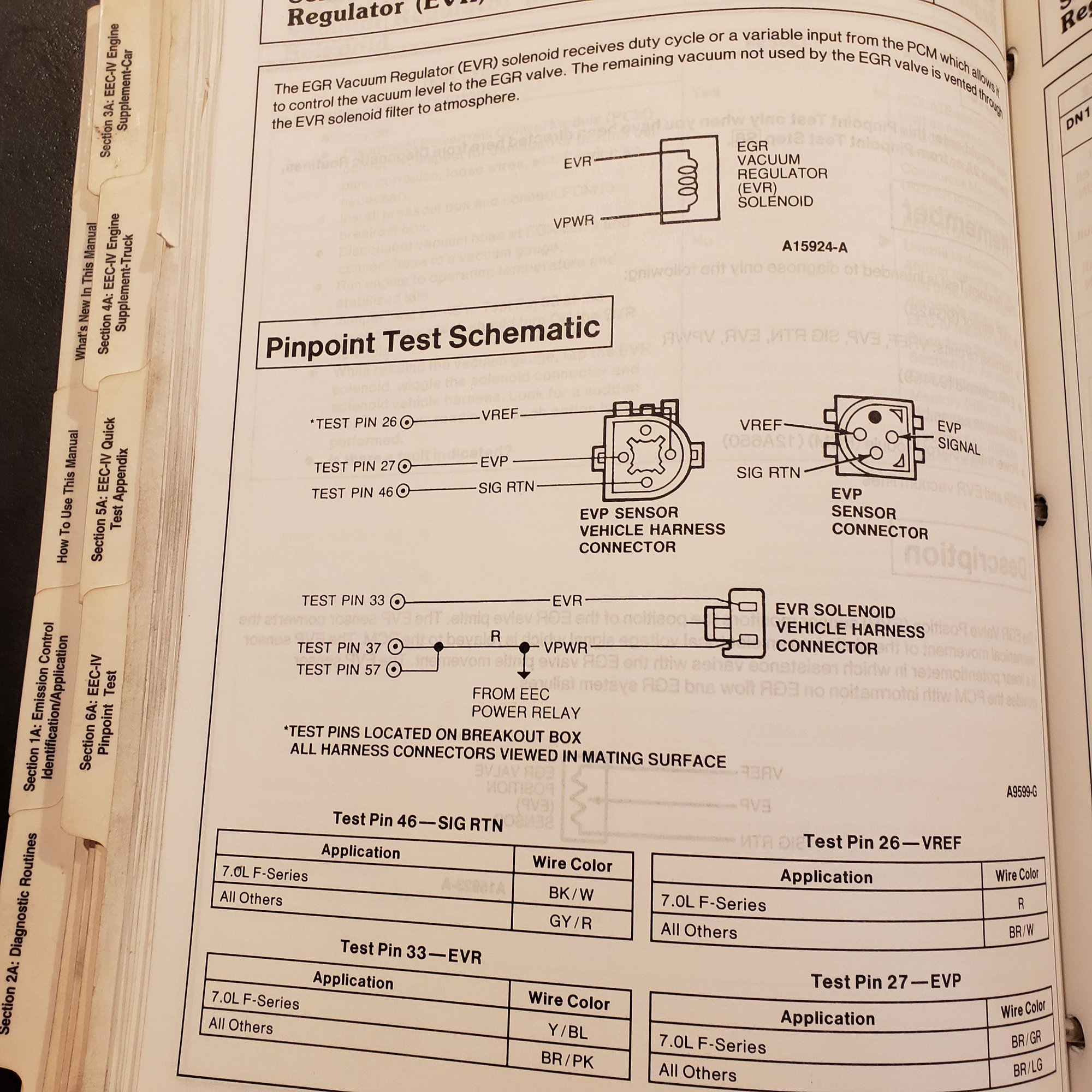

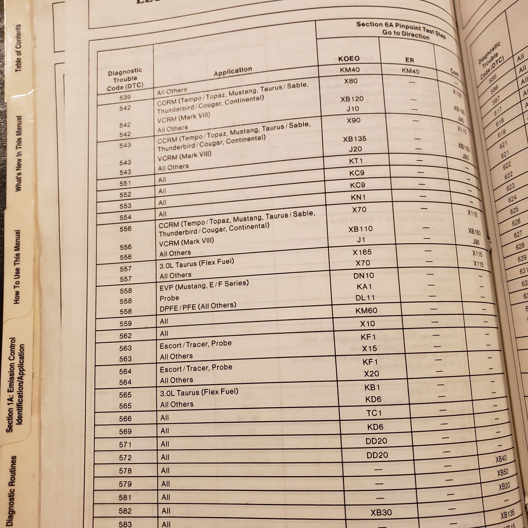

I've rebuilt the computer (replaced capacitors) and no significant change other than it runs even better when the SPOUT is unplugged. As mentioned early on I have code 558 which is the EGR solenoid circuit failure. So, now I'm going to chase that down. Is there a pretty straight forward way to check that and does anyone have a schematic on the wiring for the EGR solenoid?
Old Aug 25, 2023 | 07:52 AM
  #41
rla2005's Avatar
rla2005
Posts: 20,786
Likes: 1,751
From: Kentucky
This is for a 1990 model year, yours should be similar.

That EGR solenois circuit failure can make it run like crap
Get that fixed
Most likely needs a new solenoid
The EGR vacuum regulator they call it the EVR, vents EGR vacuum to atmosphere untill the processor says go for EGR
So, a failing EVR causes EGR to be sent at all times
I have the pinpoint tests for a 1994 with 3 digit codes that should be the same or real similar

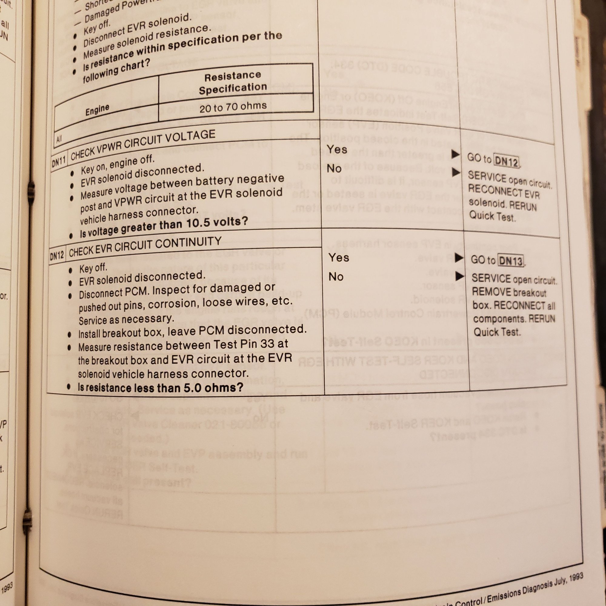

Thanks. I'll run through this test and see where it gets me. In the last pic it says that if the EVR circuit continuity is less than 5 ohms I should go on to DN13. Is DN13 relevant or should I simply run through what's here and see where it gets me?

Sorry,
I kinda thought you would be done by 11
if you made it to where you need to run through DN 13...
You will need to back probe connectors and read between the lines as 13 it requires the dreaded breakout box
Here you go
