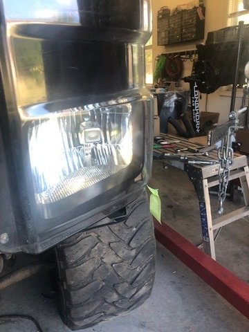

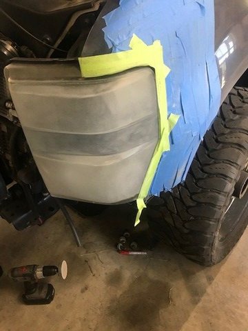

I like the 3m kits although I do deviate from the instructions a little and start with some 100-grit sandpaper on a DA to get the crap knocked off, then some 220, then I start following their instructions. It’s worked pretty good for me a few times, here are some Ford Superduty examples.
2005 Excursion
2010 F250
Every year when I renew the registrations I go over the headlights again with one of these wipes to keep them looking good, been working for three years so far in the harsh Texas sun.

Whoa, that looks awesome. There's my mistake - I thought I didn't want to scratch the surface, that there was a magic chemical that would take the yellow off, lol. All these kits sand the heck out of the lens. And if I can do several vehicles with one kit, that's a great value. I got bunches of yellow headlights. Thanks, guys. I'm working on the Prii this week, trying to get everything I need off my parts car so I can get rid of it. That's 8 yellow headlghts right there.
