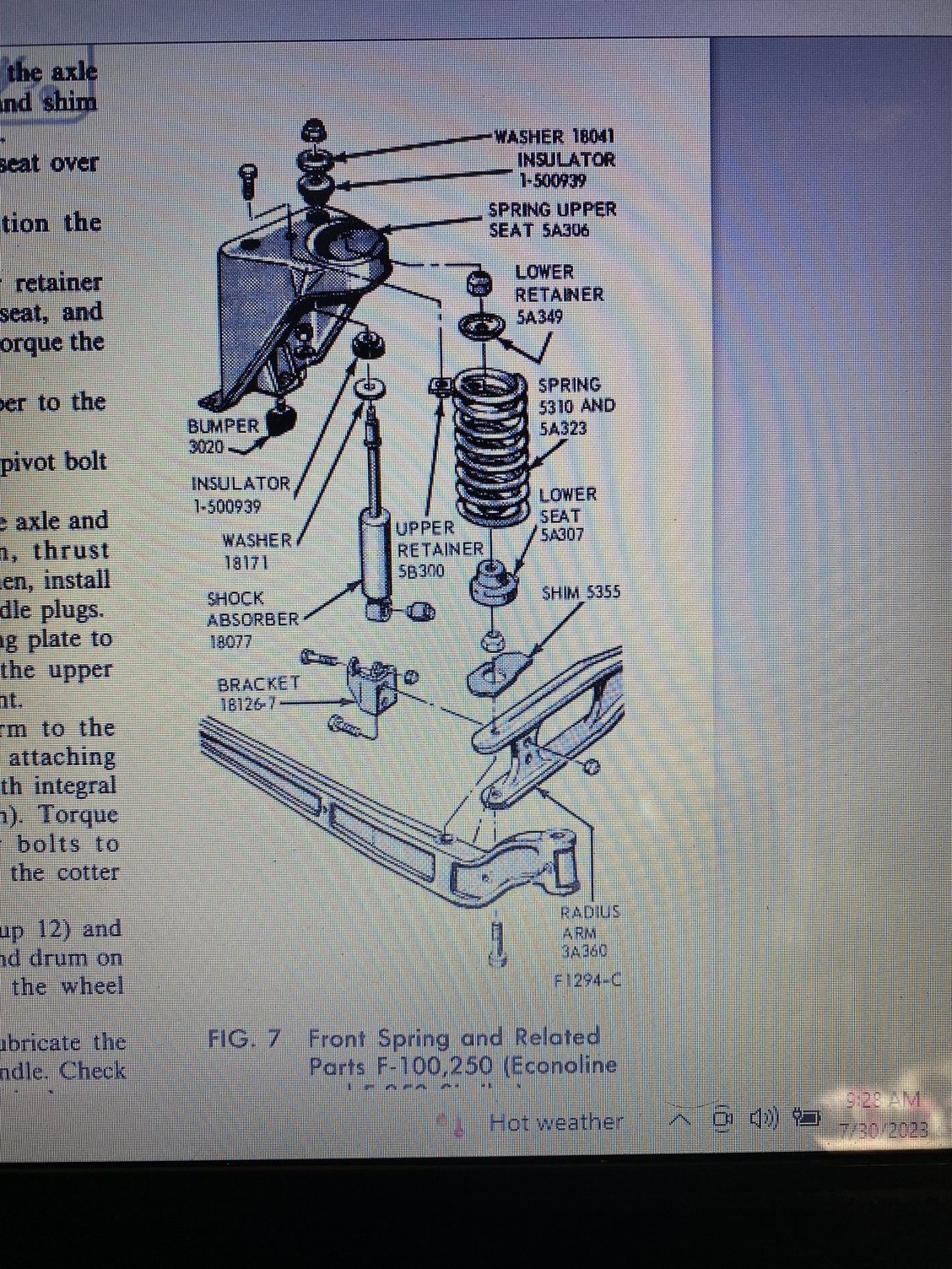

attached image from 73 service manual is all I have for reference, prefix seems to follow to late radius arms.
https://www.ford-trucks.com/forums/1538403-1979-f150-2wd-radius-arm.html
