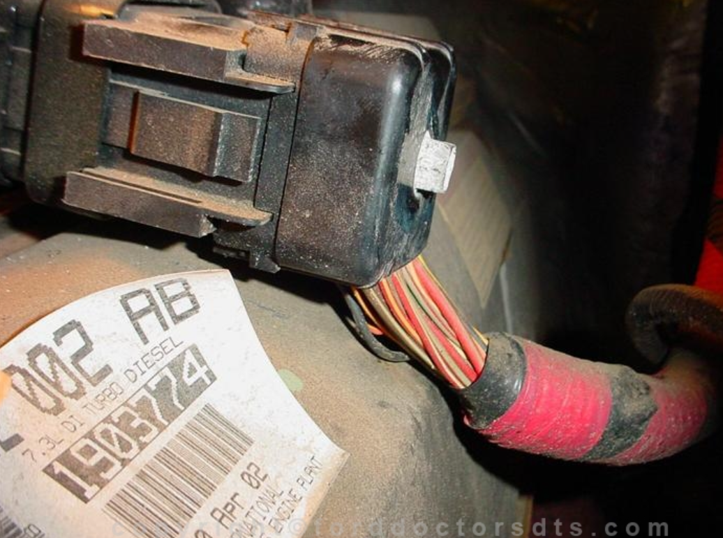

  • Have you checked the bundle of wires that rests over the driver side valve cover that is coming out of the 42 pin connector? This is a known chaffing spot as the bundle sags and rubs on the valve cover. Below is an image I borrwored from Google Images.

I have unplugged, wiggled and looked at the 42 pin connector on drivers side, but I now say, foolishly didnt try and rotate it to see the bottom valve cover side of wires... I see where that could be a rub point. The passenger side has those clips that almost look like 3/4" hose clamps that also have fairly sharp plastic edges. I looked and didnt see any chafing there where I could see anyway. THIs last time when we were stuck a the restarea, I unplugged wiggled and shii=mmed about all with, but again and maybe foolishly didnt try and start with ICP disconnected.
