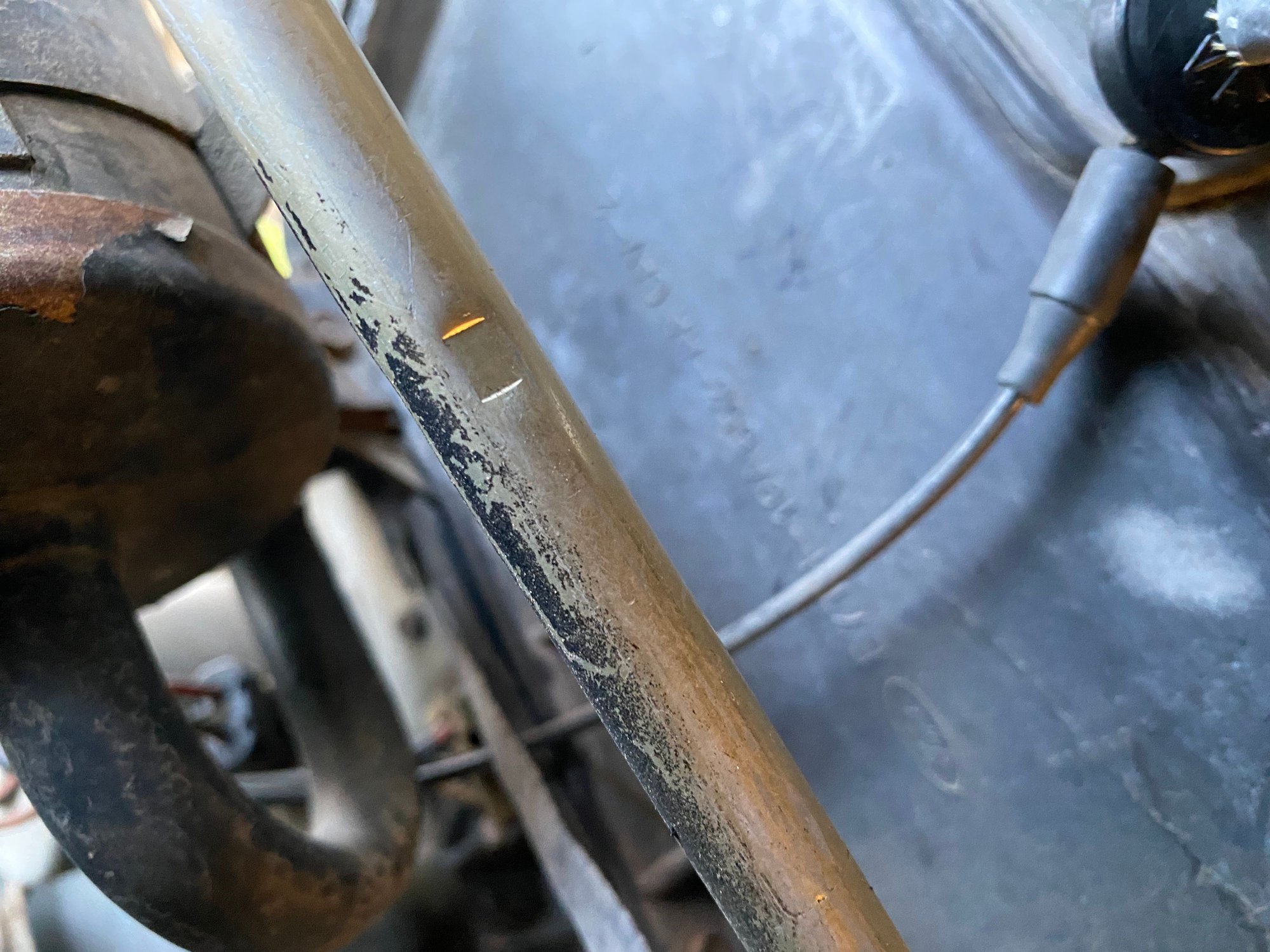

I do believe the ac’s low, it’a got a leak I found while checking trans fluid, I touched the metal hose and it was cold and the rest of it was hot. And in that spot there were indents in the metal.
Or is that supposed to be there? I don’t think it is but may be wrong.

You found the orifice tube...the indents hold it in place. Supposed to go from hot to cold there. I am also considering an auxillary cooling fan in the front. My pickup has an external transmission cooler, so I need to look at it and see if I can have that fan help the trans cooler out as well.
