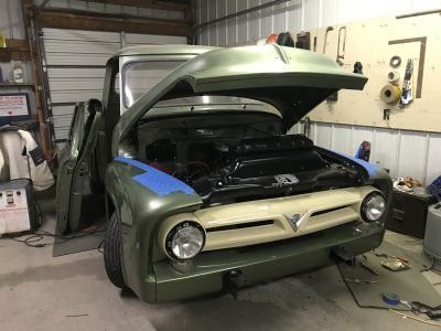

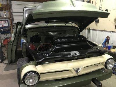

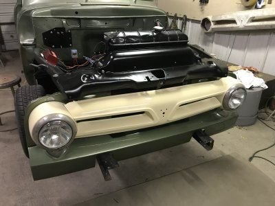

In Order:
Cab, Starting Point
1. Radiator Support. 2. Air Deflectors. (Ignore the big holes in the Air Deflectors. Long story)
3. Inner Fenders. 4. Hood Latch Panel.
5. Grille. 6. Front Splash Pan/Lower Valance/Whatever.
7. Hood.
8. Front Fenders. 9. Fender braces/struts.
The blue tape was to protect the fenders from contact with the hood during the alignment phase of the process.
Edited to add: This sequence worked for me. Your mileage may vary.
