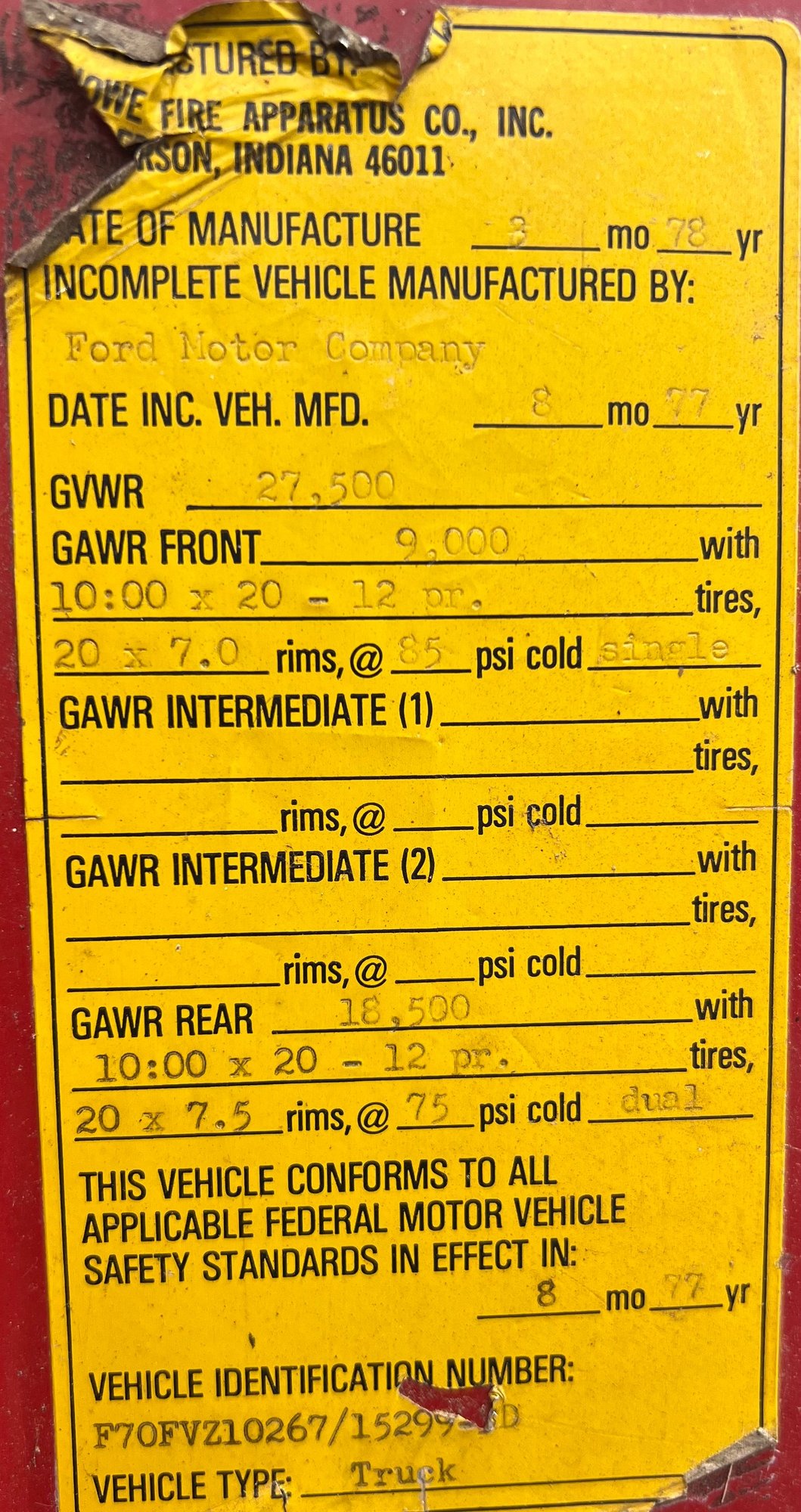

Hoping this is the correct place to ask this question, have a 1977 F700 pumper from a local VFD that needs some attention. Finally found someone willing/able to work on it and looking to help them with some research. Any help is much appreciated.
Believe the full number is F70FVZ10267/15299-3D

Welcome to FTE!
This is the place for the bigger trucks:
F70 = F700 gas
F = 391 4V XD FT gas V8
V = Kentucky Truck Plant
Z10267 = 1977 numerical series, July 1977 production
176 = 176 inch wheelbase
J6
J = Rangoon Red
6 = Not shown for '77, but was blue, bright red, dark brown in prior years, and dark cordovan in '78/'79. I don't see anything but red in your pictures.
F709 = F700 gas, 27,500 lbs GVWR. (This code is indicated for '78 and up. Since your truck was a late production vehicle, maybe they started using that designation late in the '77 production)
DA6 (?)
DA = black knit vinyl
6 = Custom Cab
M = Clark model 285V five speed direct transmission
GHN
GH = Eaton model 17221 two speed rear axle, 18,500 lbs capacity, 6.50 / 8.87 ratios
N = Ford 9,000 lb capacity front axle with power steering
27500 = 27,500 lbs GVWR
22 = Charlotte District Sales Office
Depending on usage, you might be able to license it at 26,000 and avoid the CDL issue.
What kind of brakes?
You have Dayton type wheels, so even with hydraulic brakes, it is said you can get brake drums and have them cut for your shoe width.
Also with that style wheel you can get tubeless 22.5" rims that slide right on.....
The added "15299-3D" on the VIN was added by Howe and probably pertains to their equipment. Nothing to do with the original VIN.
