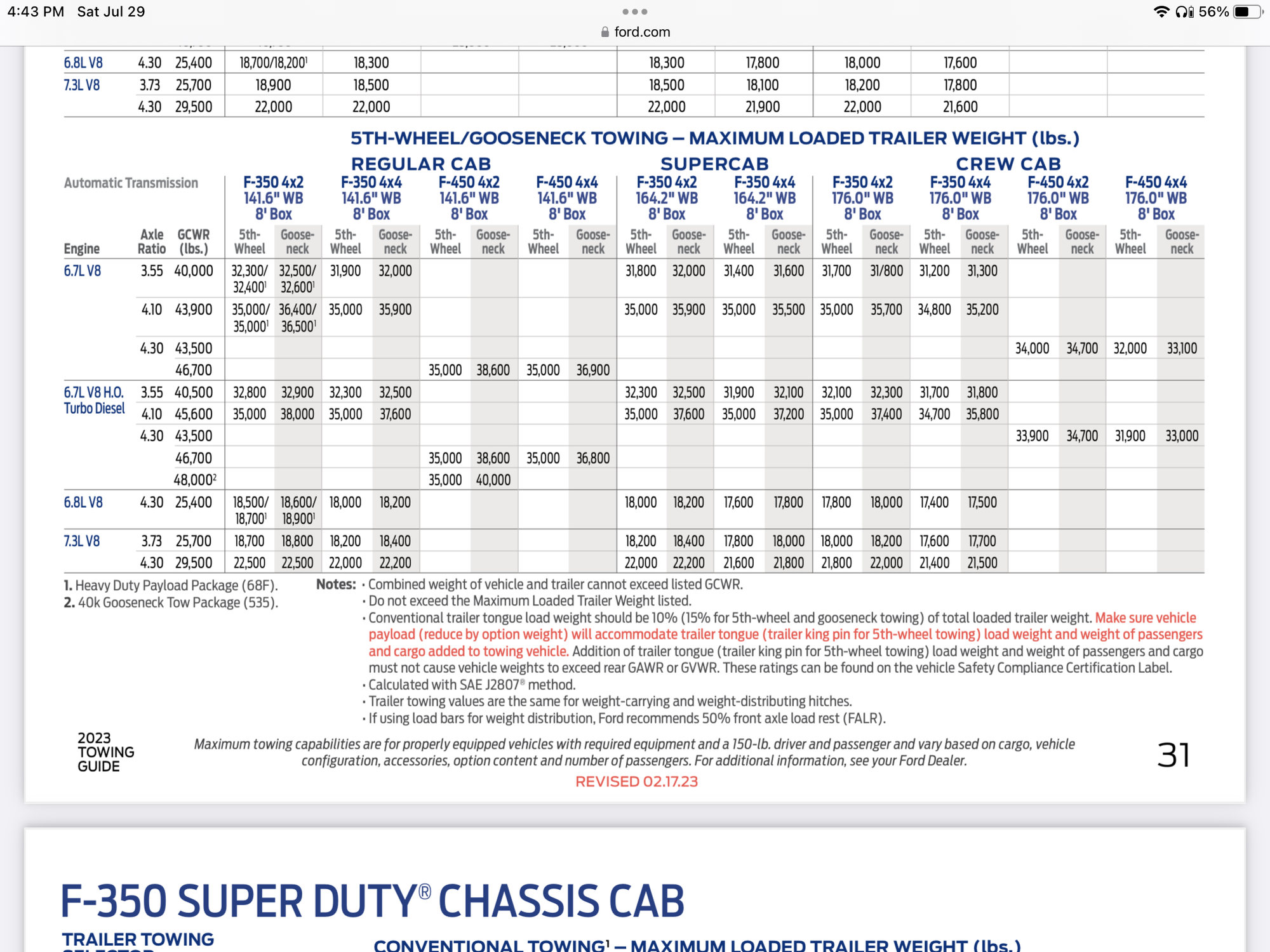

And where does one find this GCWR you speak of?
Old Jul 29, 2023 | 06:26 PM
  #28
dp23's Avatar
dp23
Joined: Jun 2023
Posts: 314
Likes: 107
https://www.ford.com/cmslibs/content...wing-Guide.pdf

So you see how it’s full of gotcha’s? You’ll never have max payload and max tow capacity simultaneously and stay under GCWR. I think they even have a derate for altitude somewhere. Anyway, you exceed the GVWR or GCWR and break something, good luck. Ford probably knows the GCWR from fuel flow, AFR, pitch, acceleration. I am pretty sure they have all the sensors they would need to calculate it. It’s a new era where the trucks can tattle. The high end models calculate payload. For all I know, they might all have that capability, but you have to pay for the readout.
Old Jul 29, 2023 | 06:48 PM
  #30
Desert Don's Avatar
Desert Don
Joined: Oct 2006
Posts: 10,188
Likes: 8,071
From: Texas
OK. So why does a vehicle equipped with the 6.7 PSD have so much more GCWR than an identical vehicle equipped with a 7.3L gas V8?
Same frame, transmission, brakes, wheels, tires, axle capacity, etc. What is different in the vehicles other than power output of the engine?
What makes the PSD safer than the gasser?
or is this GCWR just advertiseing about who can pee the furthest?
