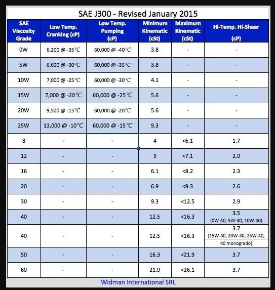

The SUS Viscosity and cSt viscosity lines:
SAE J300 has cut offs for high temp flow of the oil. A 11.64cSt at temp (100*C) falls into the 30 weight range
Oil can thin out from shear forces (see HPOP's on 7.3 and 6.0 PSD) or fuel dilution amongst other things, the former is better than the latter.
