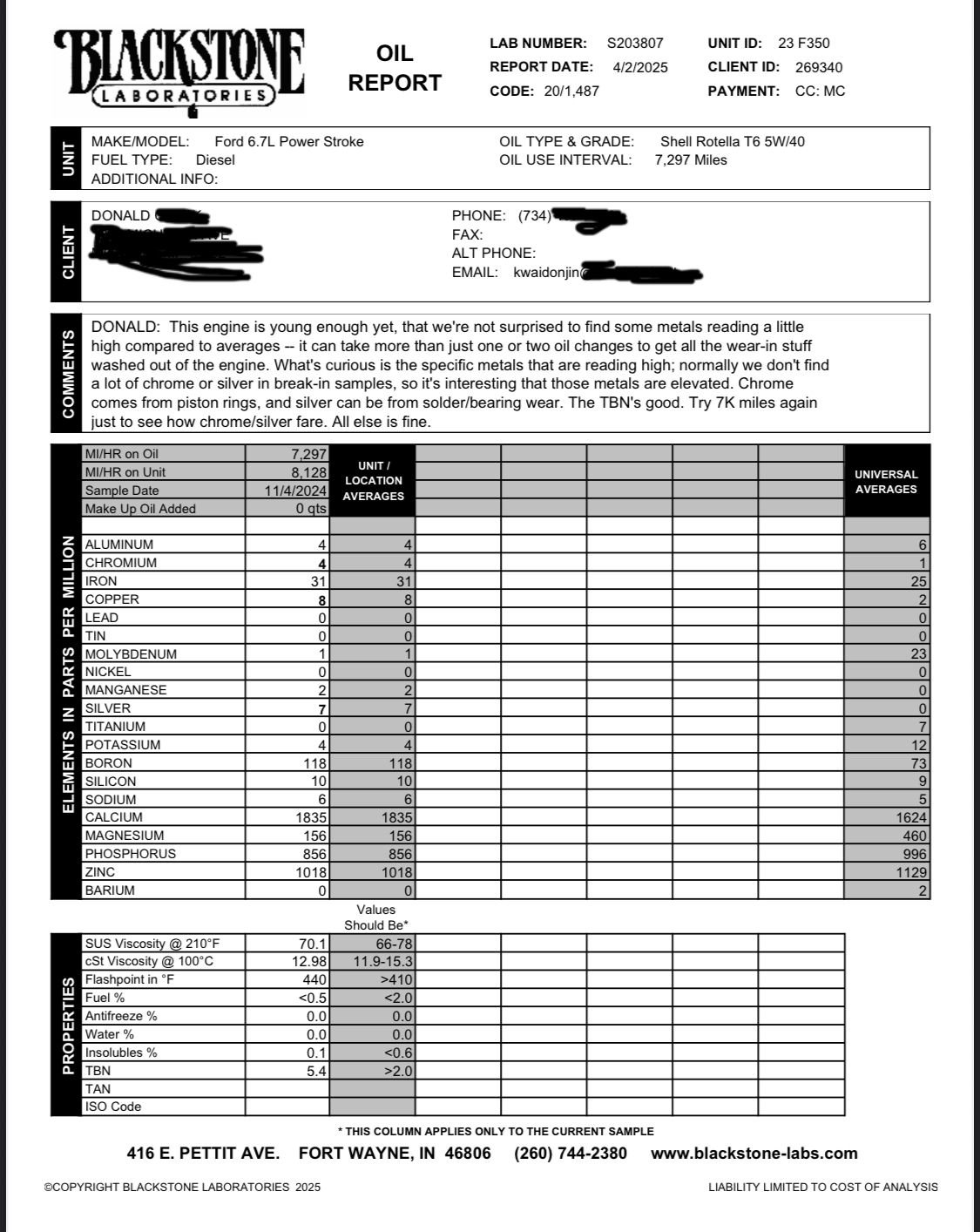

did you ever do a follow up analysis??? I have similarly high numbers my first one out !

Just curious how many miles are on your truck? If Iron is under 100ppm and other wear metals are under 40-60ppm in a new engine, your fine IMHO.

here is the Analysis
This was at 8k with about 7200 on the oil.

For a pretty much brand new truck this looks great. You have single digit wear for most of them and pretty low iron given how new the engine is. Viscosity is within grade, no material fuel present, good flashpoint, low insolubles. Can't ask for much more IMHO. I think it looks totally fine.

thank you sir! I’m currently running valvoline premium blue, I have about 4k on that. Gonna run it out to maybe 6k then change and see what the numbers say on that. If it looks better than the Rotella T6 , I’ll probably then make the Valvoline my permanent oil.
