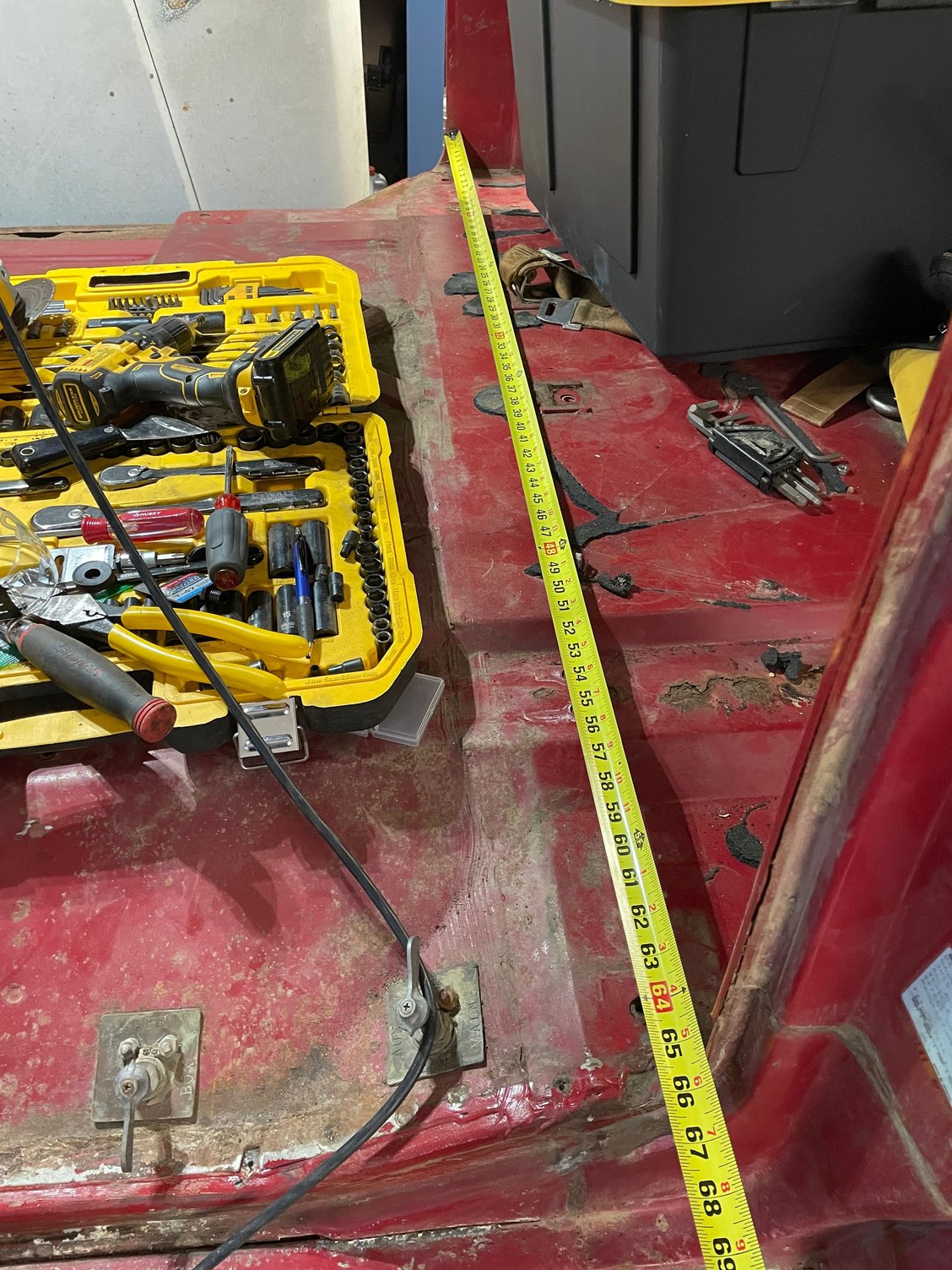

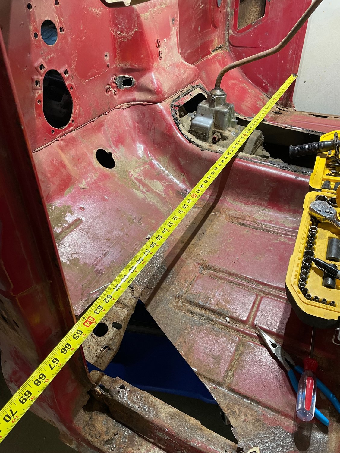

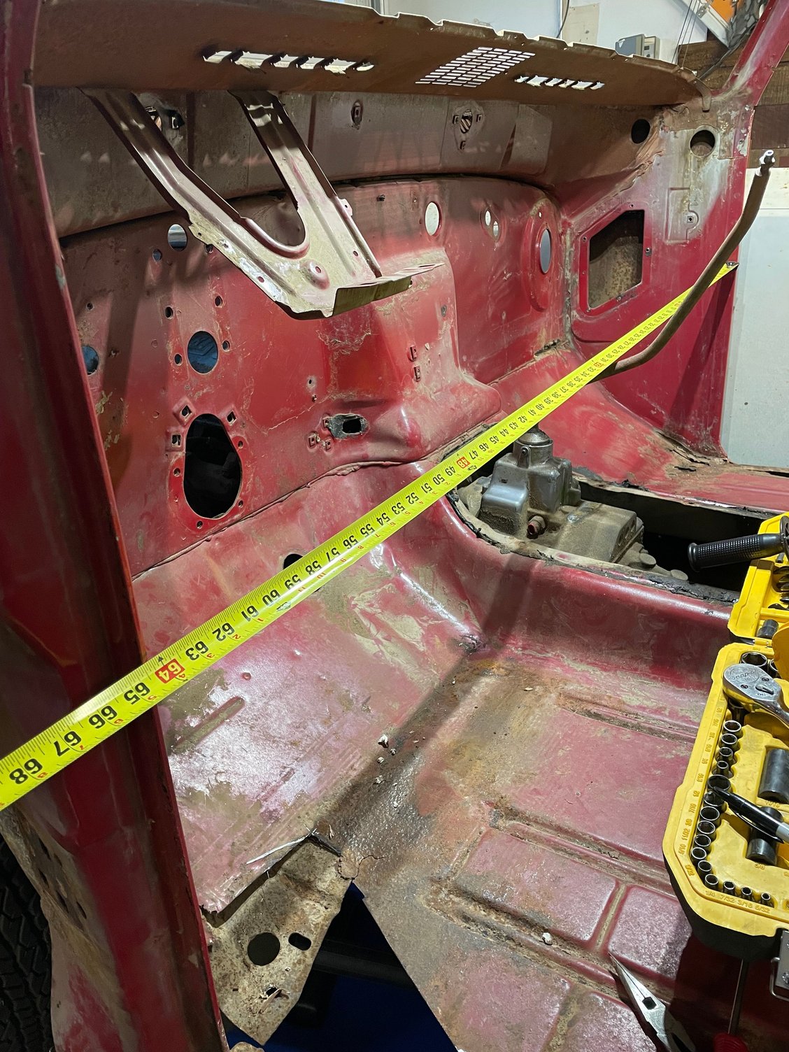

If anyone has any measurements handy for their cab I'd like to compare my numbers to yours.
I took 5 sets of measurements, 3 in the front and 2 in the rear.
1) Just above the trans tunnel, inside measurement, 64 and 7/16 inches
2) Right in the middle of the indentation one each side of the cab, inside measurement, 64 and 1/4 inches
3) Up at the top of the windshield right where the posts start to bend, inside measurement, 63 5/8 inches
4) Post behind driver seat, as close to the floor as I could get, 65 and 5/16 inches
5) Top part of the cab 56 and 3/4 inches
I took some pictures to help you guys visualize where i took my measurements, feel free to let me know where else I should be pulling measurements from too.
