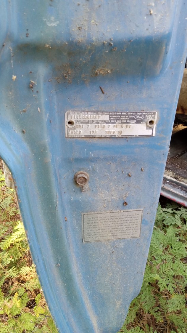

Help please what can someone tell me about this truck I'm trying to sell for parts
F11yrd01467 131 7 f110 2 81 AE9 05600 172 3800 51
the outside of the truck says it's a f250 camper special so I'm a bit confused by the f110 on the door plaque/ plate

Well I think you got 2 things going on here.
1 - the truck is older than an 1980 as our doors dont use that door tag set up.
You are in the 1980 to 1986 truck area and we cant break down the numbers with our system.
2 - because the tag is on the door lets say the door got crunched and was replaced with a used door.
Now the tag no longer matches the truck the door is on.
Not seeing the truck and not enough of the door edge I am guessing that is a bump side truck so try there for the info.

This is what the truck looks like if that helps an. From the difference in colors i'd say your prolly right about the door not matchingthe bodyoriginally
thank you for your help

I'm thinking that might be a late 70's or even a early 70's
You can look at the tail light lens, and see a date on them.

That is a bump side, see the "bump" running down the side of the truck.
It would be 1967 to 1972 truck.
Post your info question here https://www.ford-trucks.com/forums/forum39/
