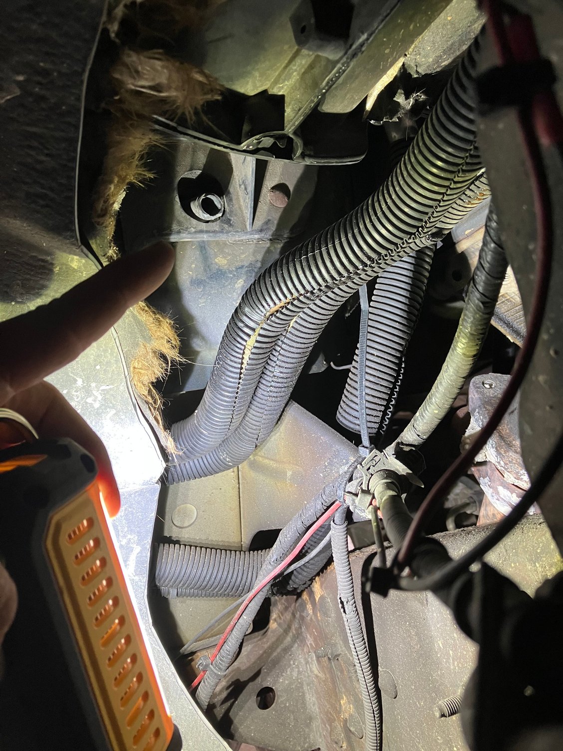

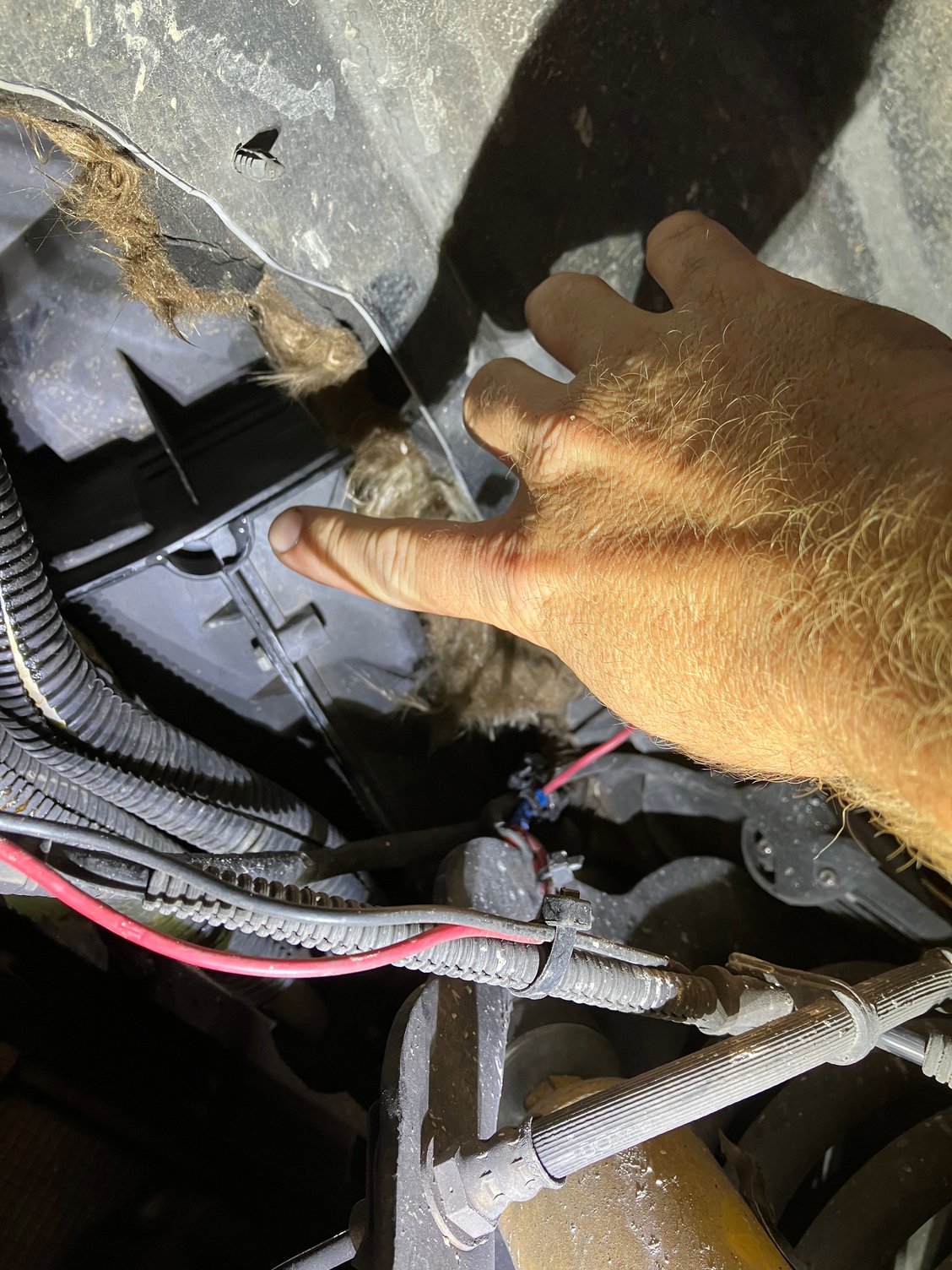

My 2000 v10 excursion is leaking cold air and cold water from the bottom of what I assume is the blower motor housing. There is also a small 1/2 pipe that is protruding from the fire wall and blower cold air into the wheel well.
the truck has cold ac when driving. Not ice cold but cold enough. When idling/ sitting, it’s barly cold.
i live in florida to the outside temps are usually 95-100
here are pics

So the half circle opening that's wet, is the evap drain. the round hose is the heater core drain.

So is it normal for cold air to be coming out of both ?

Yes. It's also a way to help push the evap water out. Both sides of the evap are pressurized by the fan motor, so it's inevitable that air will bleed out.
