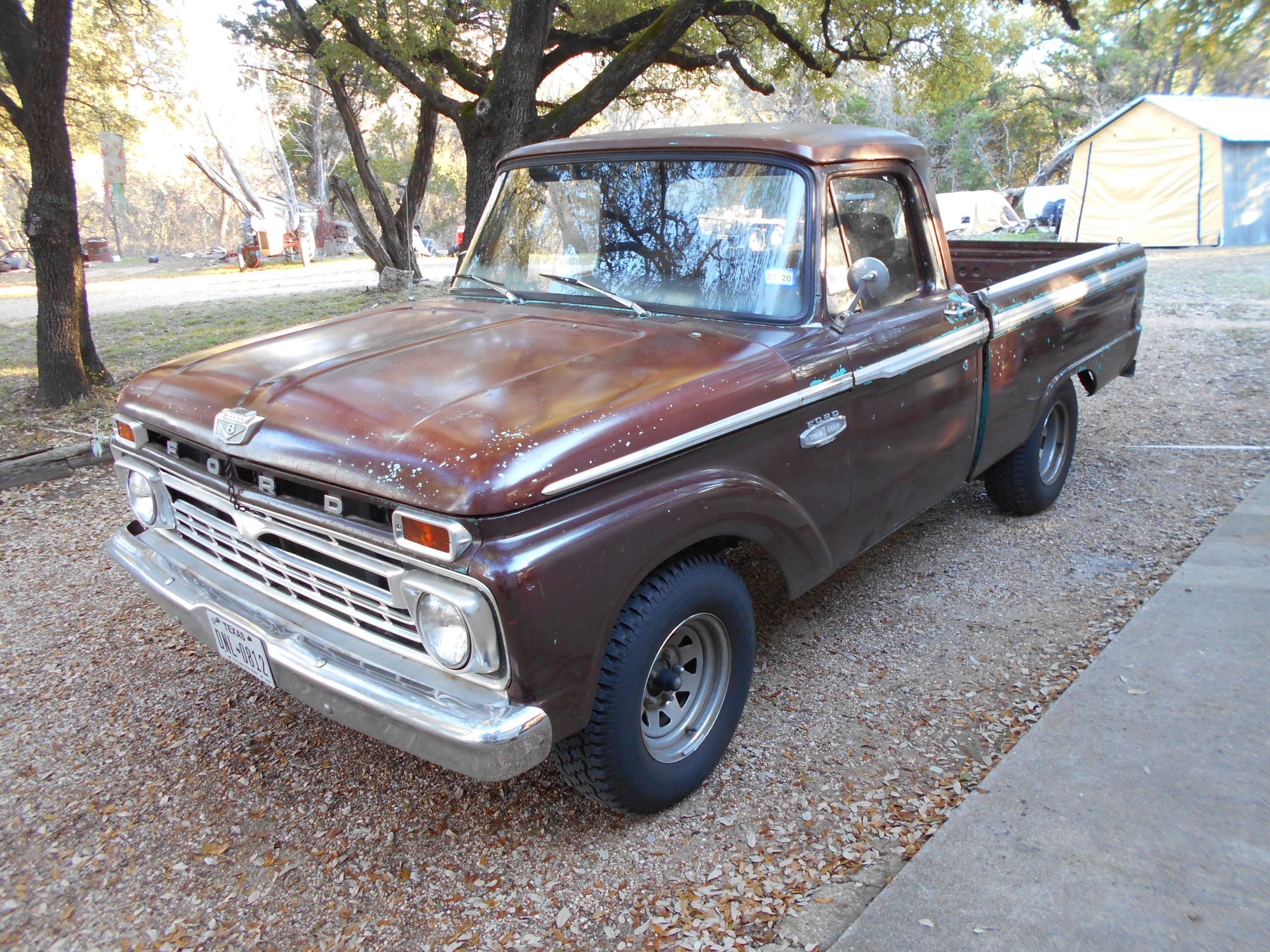

Woodsmoke,
I usually don't comment on custom touches, but --- your hood securement chain HAS TO GO!
Your truck is SWEET with nice vintage patina, but please tell us you are also looking for a hood latch so you can loose the chain.....
BarnieTrk
Old Jul 23, 2023 | 06:02 PM
woodsmoke's Avatar
woodsmoke
Joined: Jun 2008
Posts: 345
Likes: 23
From: WACO
Originally Posted by BarnieTrk
Woodsmoke,
BarnieTrk
Thanks for the observation. A little history on my F100. I got it around 1981. I could go into a book of back story. Picked my wife up hitch hiking in this truck. We had our son. This was the only transportation we had. My father-in-law loved this truck so I traded for a Chevy station wagon he had. He and his son was driving it one day and the hood flew up. Scared the bejesus out of them. Thus the lock and chain. He passed away last year. He willed the truck back to my wife. So. The lock and chain on the hood is kind of a tribute to him and his memory. It has a perfectly good hood latch. My apologies if I offended you.
