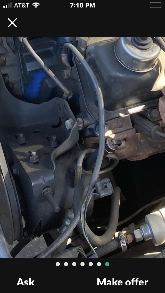

Thank you guys I was able to get it on the shaft a bit more and am using a pulley installer to do it. I will get the number and post up here. I found a 77 f350 for sale online locally and had him take pictures of engine and it had a spacer behind ps bracket.

Not my truck

Originally Posted by 79calicruiser
Not my truck
That picture does not look right either. Going by memory but Ford did not use what looks to be a large nut combined with a round spacer as a power steering bracket spacer. The bolt also looks to be a common hardware store bolt so someone has been messing with it. I wouldn't trust the originality on this pic.
Anyone please chime in but I recall Ford used a round aluminum spacer on non-AC trucks in place of the (absent) AC bracket.

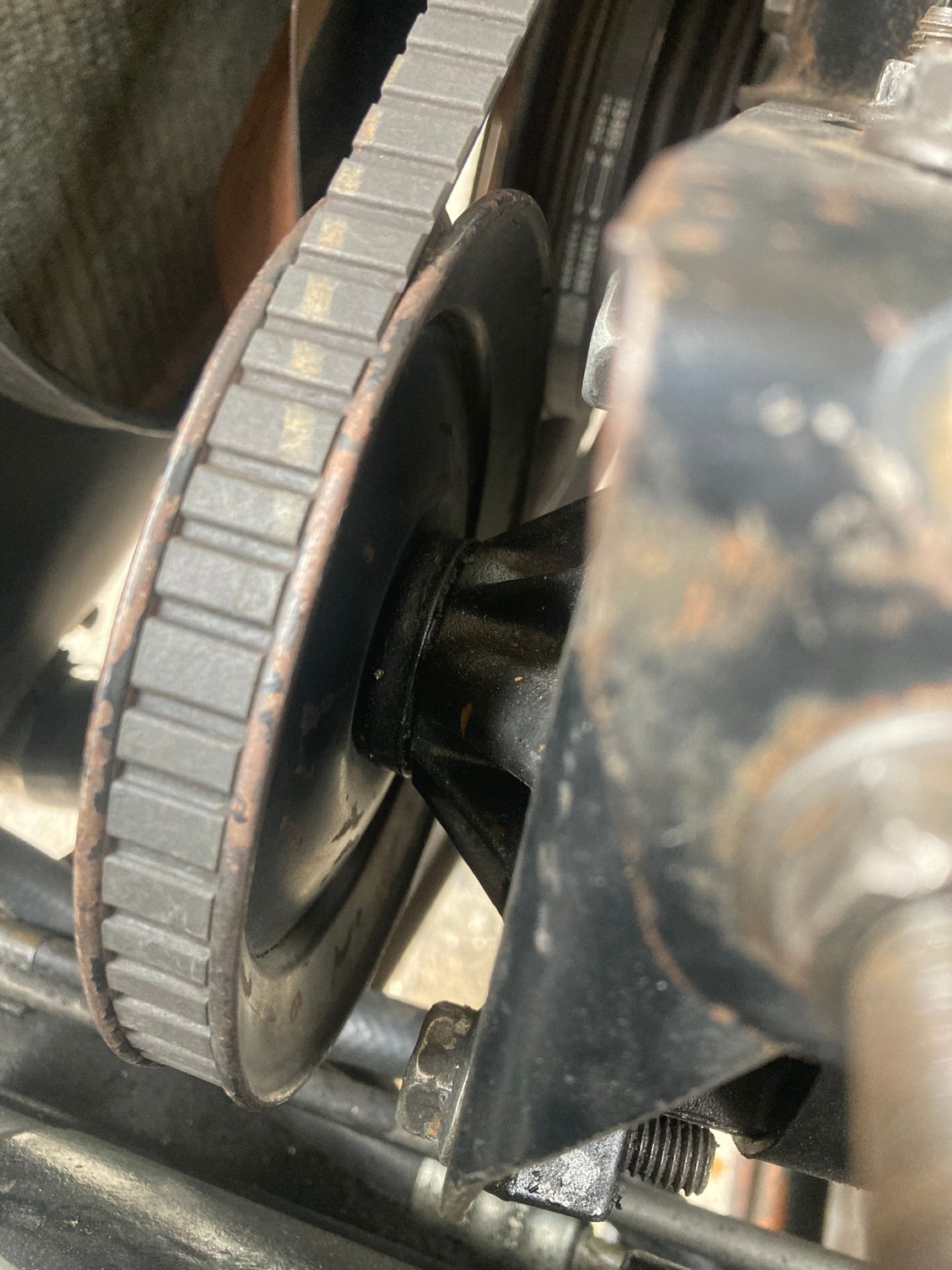

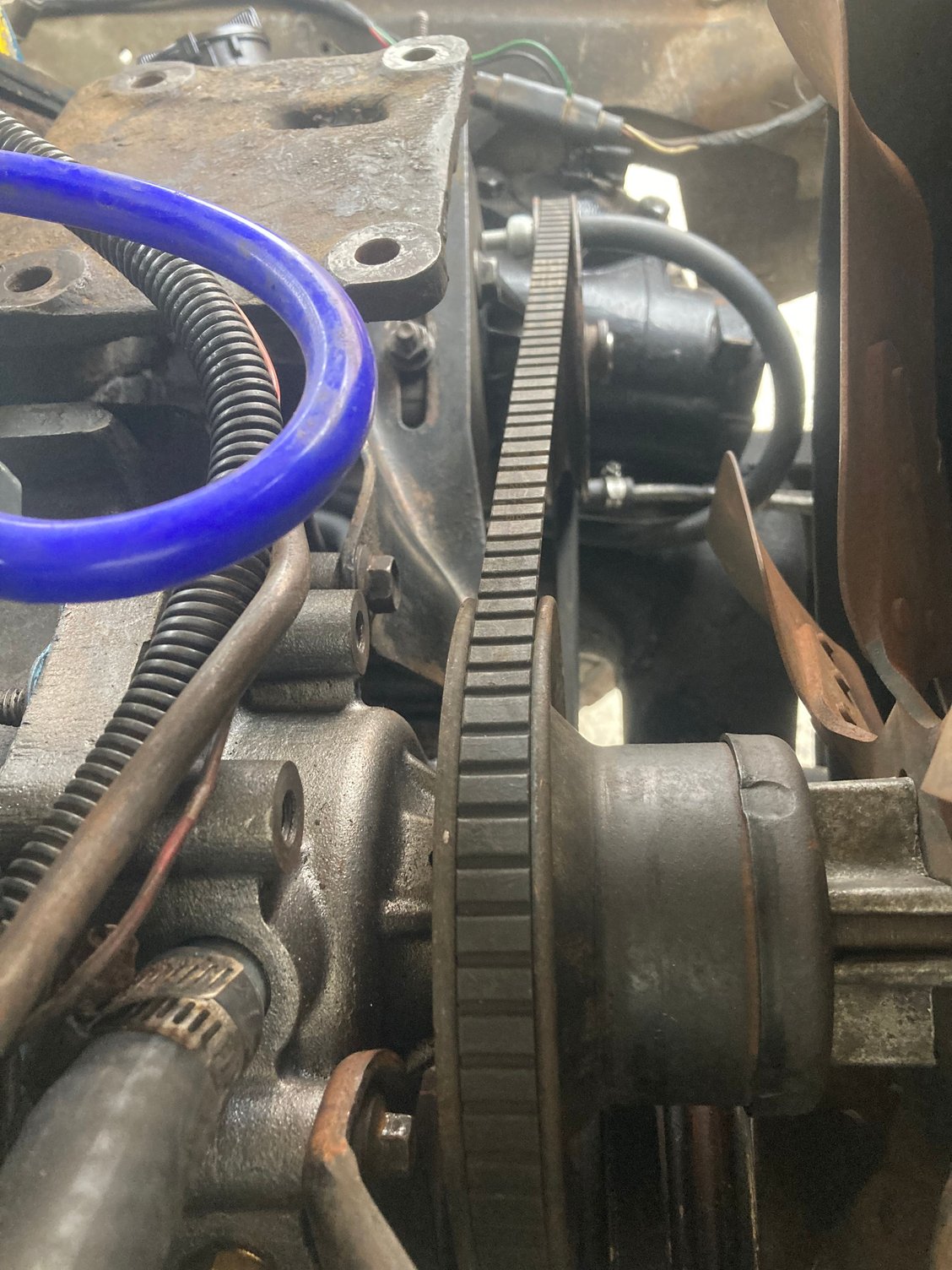

Old Jul 23, 2023 | 08:00 AM
79calicruiser's Avatar
79calicruiser
Joined: Aug 2021
Posts: 256
Likes: 71
Old Jul 23, 2023 | 08:02 AM
79calicruiser
Joined: Aug 2021
Posts: 256
Likes: 71
M2
S2
Only markings I see other than ford logo

I don't think that is the correct pulley but my experience with Ford power steering pump pulleys is that there are many of them and sometimes there isn't much for markings.
According to the Ford parts manual 1978/79 the 351M/400 power steering pump pulley part number is D0AZ-3A733-A and I would expect to find it marked with D0AR-A.
The Mustangtek site shows one here D0AR-A
In the case of your truck it does seem that the pulley you have does not have enough offset, but hard to tell conclusively from the pictures. Is the pulley just too far ahead of the other ones or is the face of the pulley actually crooked (or slightly angled) in relation to the other pulleys?

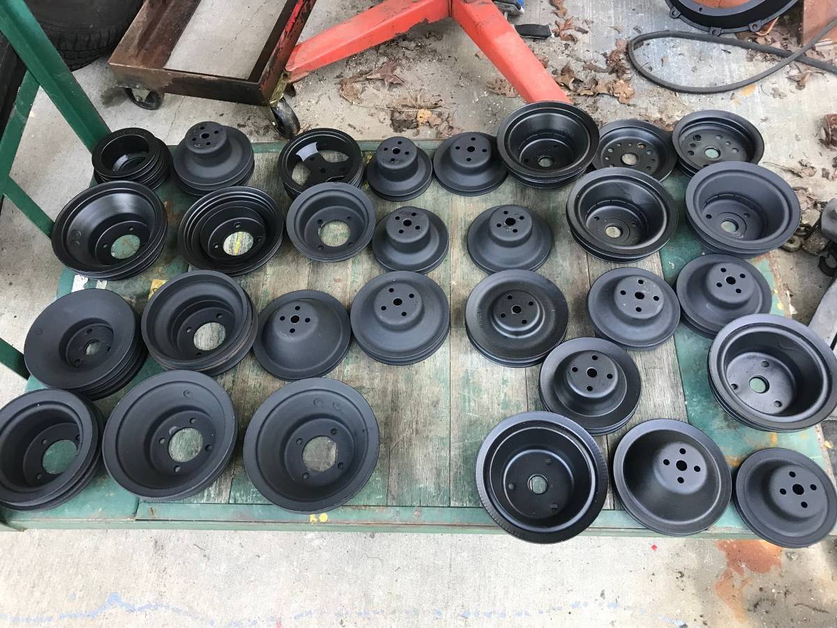

Just to give you an idea of how many pulleys there are for these trucks....
