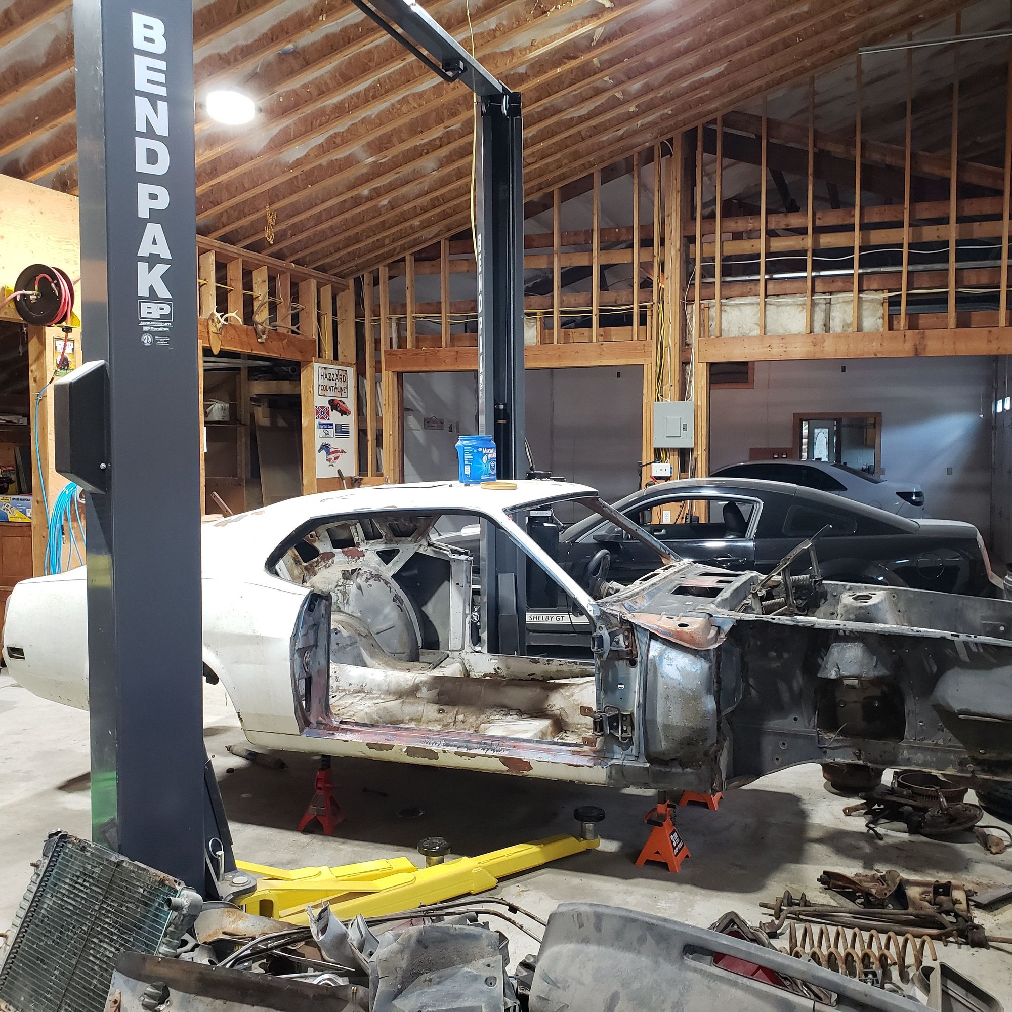

Working in the shop with my son on his '70 Mustang getting ready to blast. Thinking about crushed glass - any of you have experience with this media?
