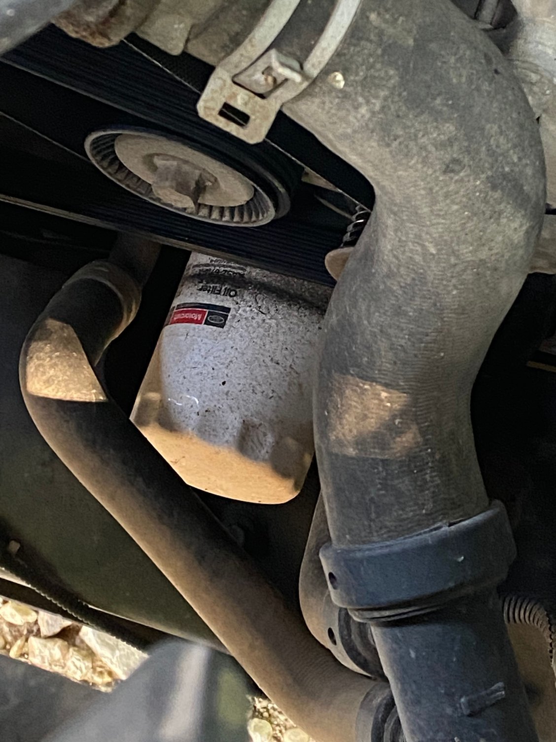

I have a 2016 with the 5.0, I bought in August of 2022 with 46k miles on it. When I bought it hadn’t had a service inspection or been checked into inventory at the lot yet. I noticed the coolant was low but still quite a bit over the minimum mark. The other day I changed the oil and noticed it was quite a bit below the mark. I bought a gallon of coolant, and topped it off ( took about a quart I’d say to put it just above the minimum mark. I made about a 400- 500 mile trip, it is now below the mark with about 2” of coolant in the degas bottle. The only wet spot I’ve noticed, is on the thermostat housing. It doesn’t look like it would leak enough to be noticeable. When I changed the oil I noticed the had stuff flung across it. All the plastic fittings appear to be dry and oil and coolant are clean.
Truck now has a little over 66k on it, and couldn’t find any active leaks while running or not while the engine was at operating temperature, will look again when it’s cold.
I was just wondering if there was any known issues other then the plastic “T” fitting. I’ve also never noticed any spots under it either.

Originally Posted by dlburch
my vote is for water pump. I started smelling coolant after driving...I didn't get around to checking it out and withing a couple of weeks the water pump bearing completely failed and dumped all the coolant (2016 5.0 with 65,000 miles)...
I will have to look at it closer, do they still have the weep hole that starts to seep on the bottom like the older stuff? That could explain the stuff on the the filter, assuming it’s dripping out the bottom onto the belt. Definitely quite the bummer at 60k, but what can you do.

Other than what’s being flung by the belt, the only signs of coolant is a damp spot on the pump right behind the pulley. The truck has coverage on it, so I’m going to call the company and a local dealer to see if they’ll cover it.

Figured I’d give an update, took the truck to the dealer and they put it under pressure. They said there were no signs of a leak, at the water pump. The only leak they could find was the o ring for the thermostat housing, bought the o ring and procrastinated putting it on. The leak started to get a lot more noticeable, as it turns out the thermostat housing itself has a crack in it. So now I have that sliding around the back floorboard. Hopefully I will be able to get it on and the coolant flushed this weekend. I’ll try to post a picture, when I get the old one off.
