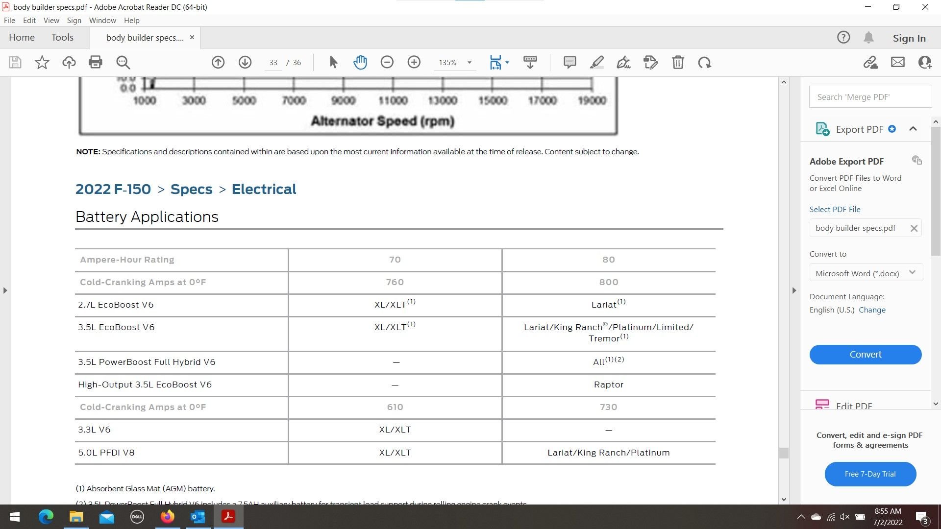

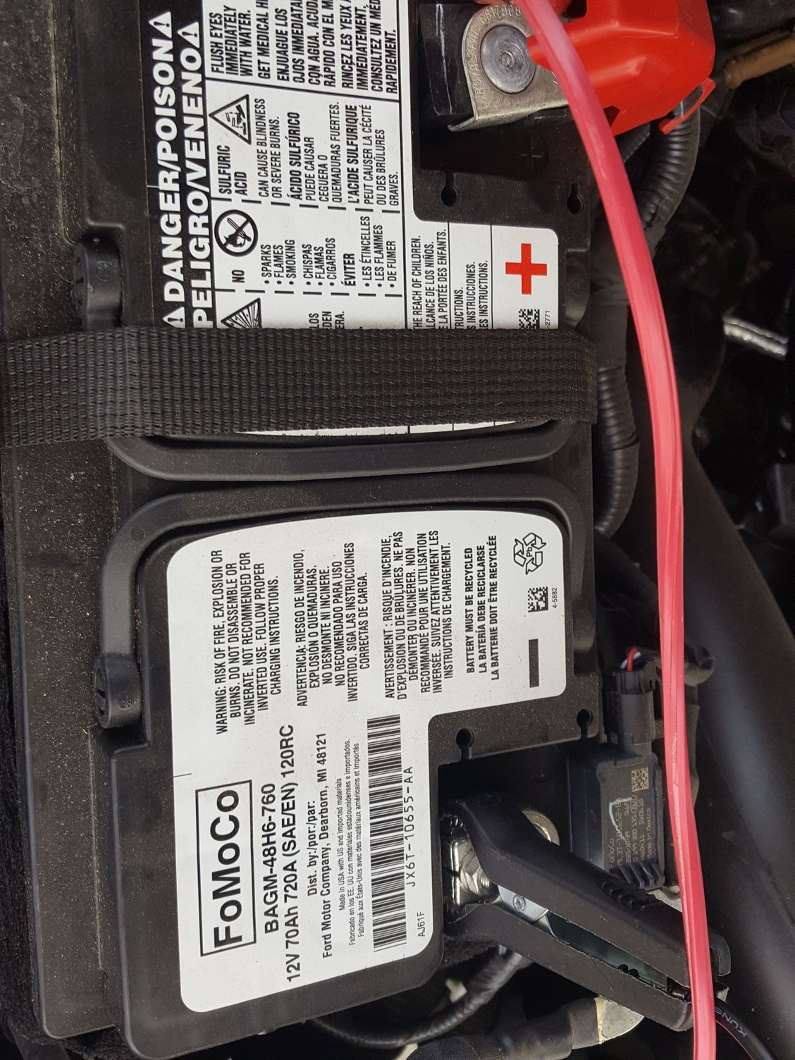

i had battery issues on my 22 and it had the lesser of the specified batteries that should have been installed
dealer put in the correct battery and i used forscn to boost SOC level to 95%
battery size required
so far , now i only get low battery stuff if i dont drive for a week or so and open up truck alot to get stuff and running boards run down battery

So, the fix was bigger battery with more CCAs and change setting in Forscan?
Old Jul 17, 2023 | 05:42 PM
powerboatr's Avatar
powerboatr
Joined: Apr 2021
Posts: 2,020
Likes: 752
From: Texas
yes for me
