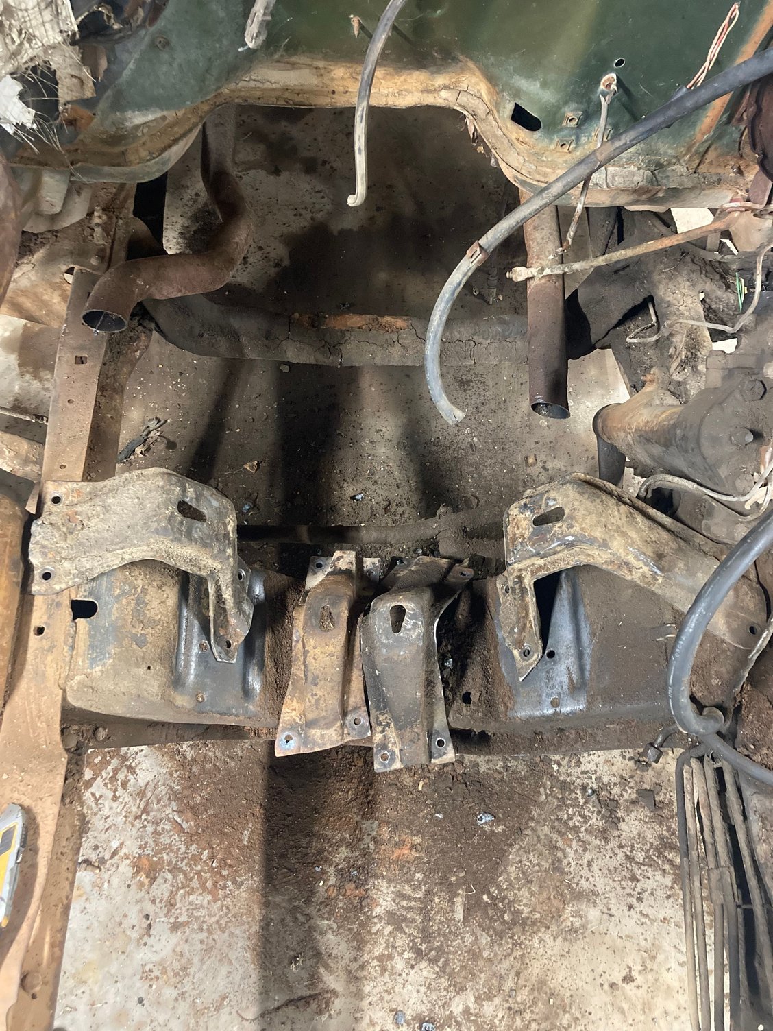

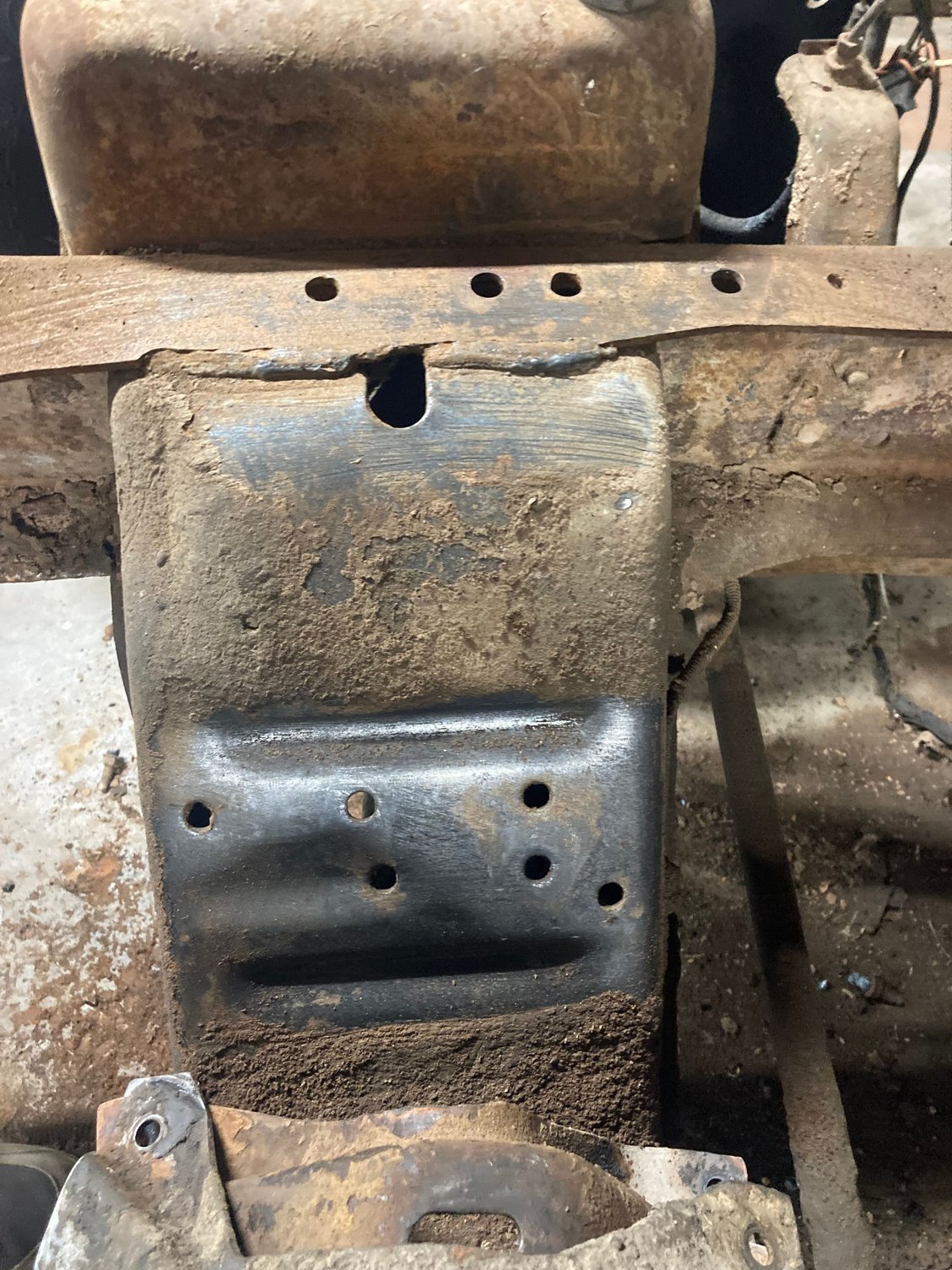

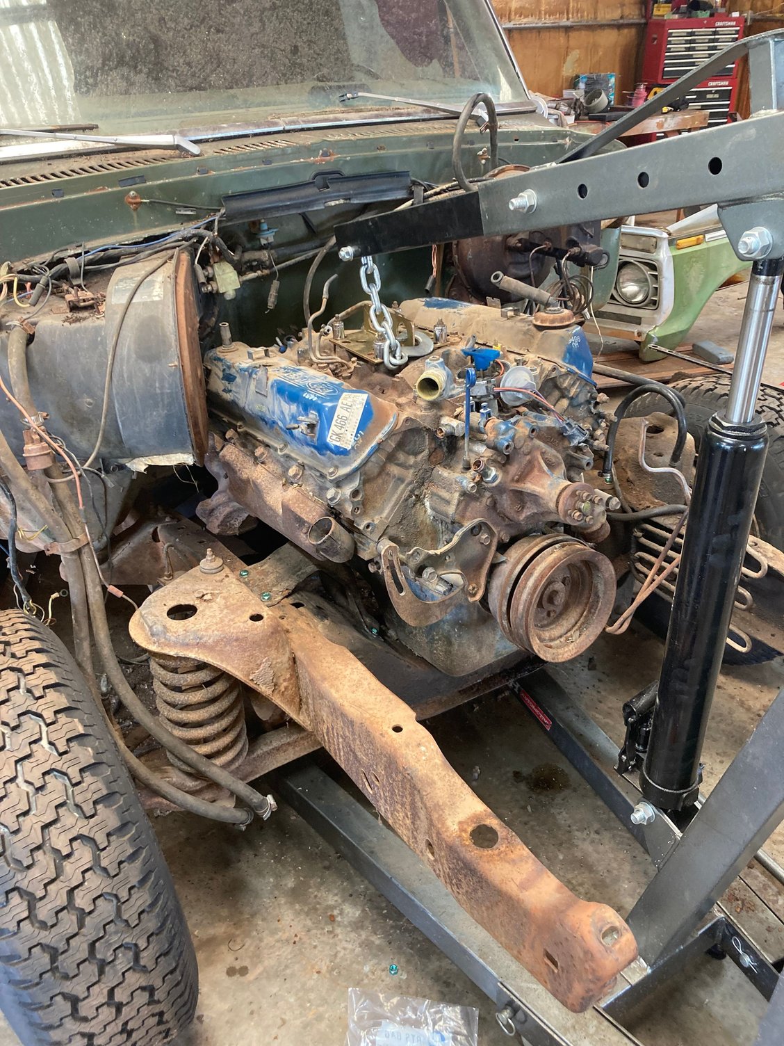

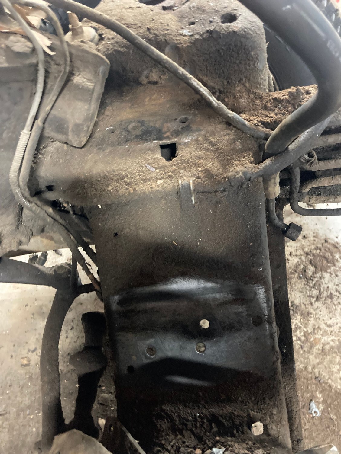

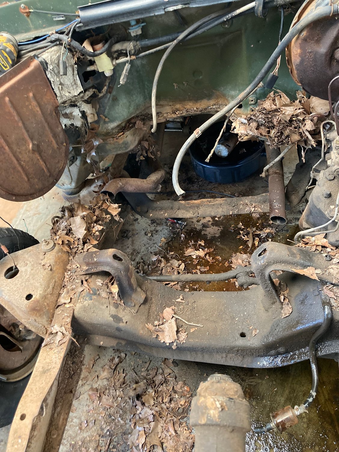

Pulled the motor today and have been doing some research. There are lots of options for swapping at 460 into a truck that had a 351 or 302, but not finding any “ bolt in options” to go from a 360 to a 460. Does anyone know of any that would work or am I going to have to cut out the old truck side mounts and replaced them with 351 mounts?
Don’t mind the mess, truck was outside since 07 before I got it lol

Those "side mounts" as you called them are bolted in. They are a PITA to remove. I know this because I removed a pair from my '77 sCab parts truck with a 460/C6 that I will be using in an upcoming project ('76 F-100 that had a 360) where I also removed its 360 mounts. The 460 units are definitely different from the 360 units. Not sure about 351/400 mounts. Perhaps another FTE member has direct experience comparing the 460 to 351/400 mounts.

Bullet Proof Motor Mounts | 460 EFI Guys I think JBG might have them also.

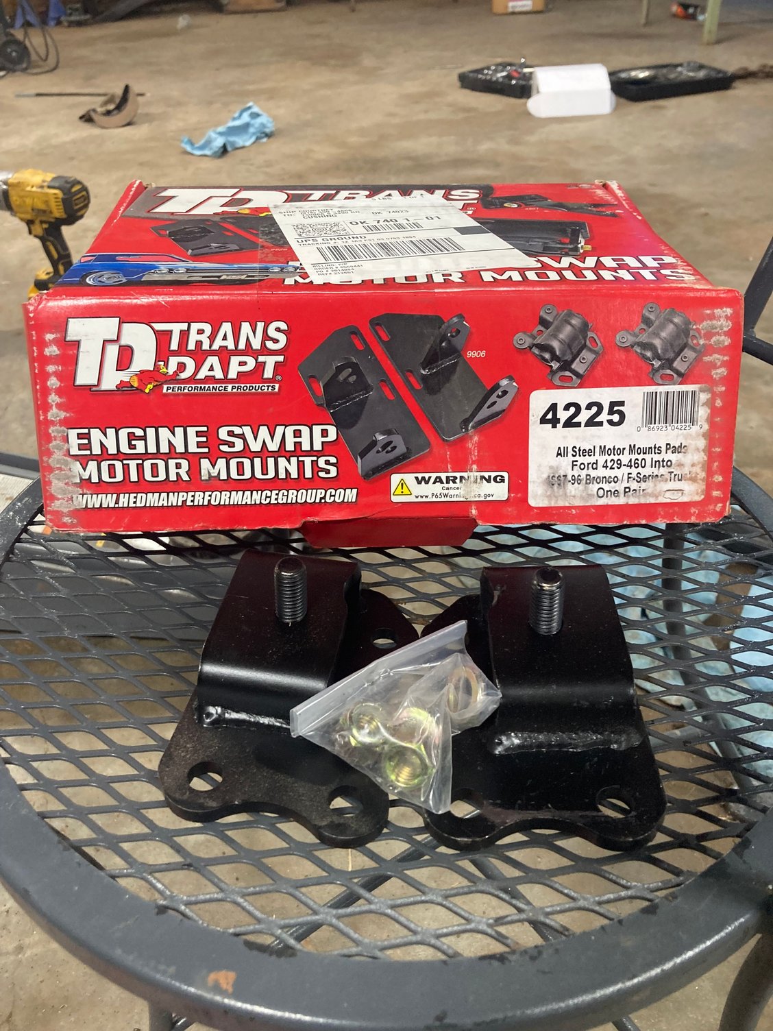

Sorry it’s been a while since I have updated you all. Got busy with work and then took a while to source some parts but working on it again now. got the motor perchs out of a 79 302 truck and I am going to bolt those into my truck, then ordered the transit dapt mounts for swapping a 460 into a 302 truck now just need to bolt everything in and start worrying about drive shafts and all other BS.

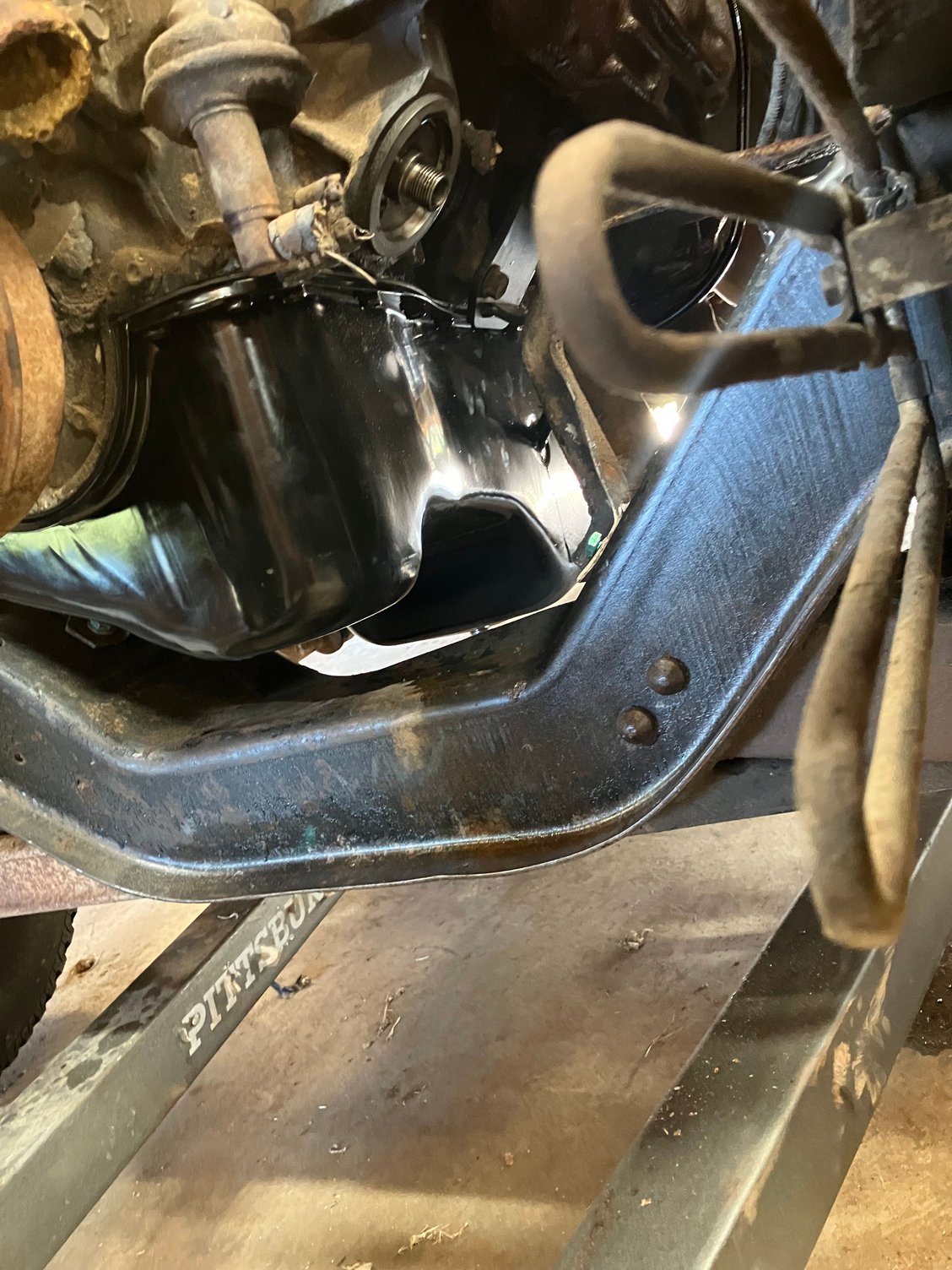

I think I found a pan that should work but dose anyone known if it will for sure clear my crossmember? I think it will but hate to spend the money and it not work.

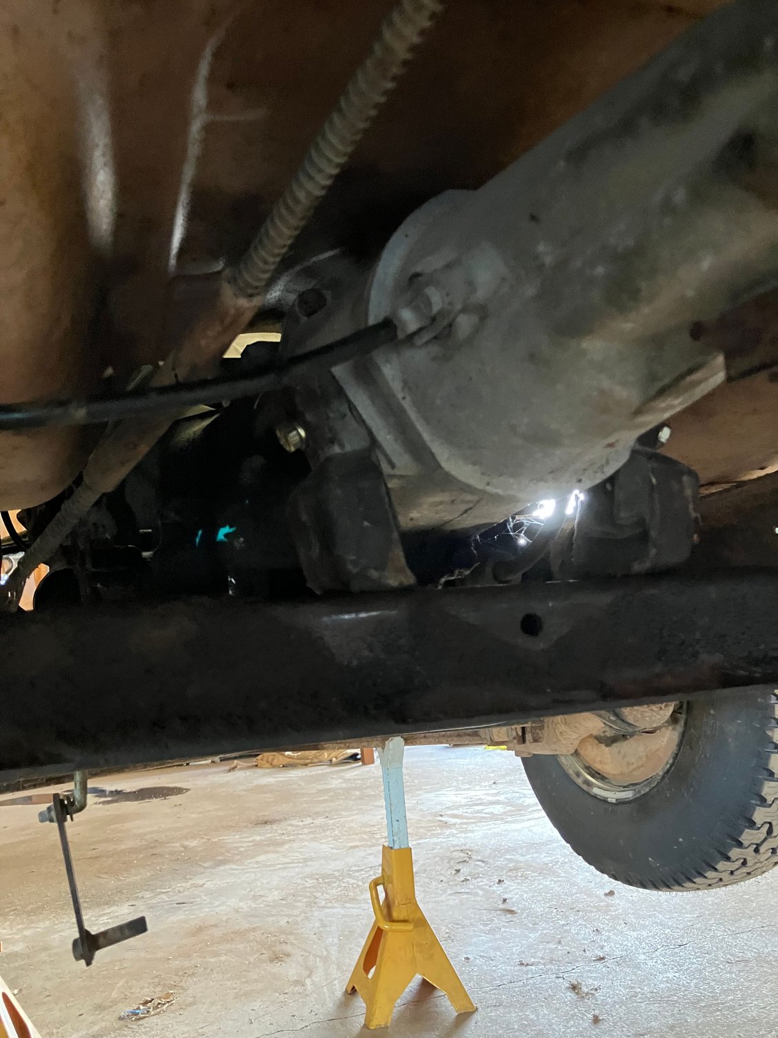

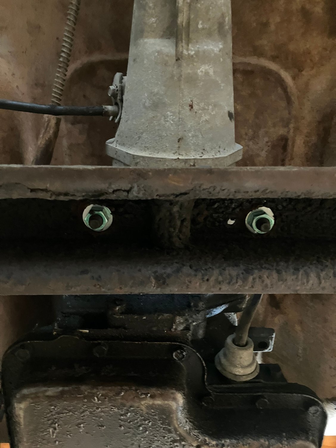

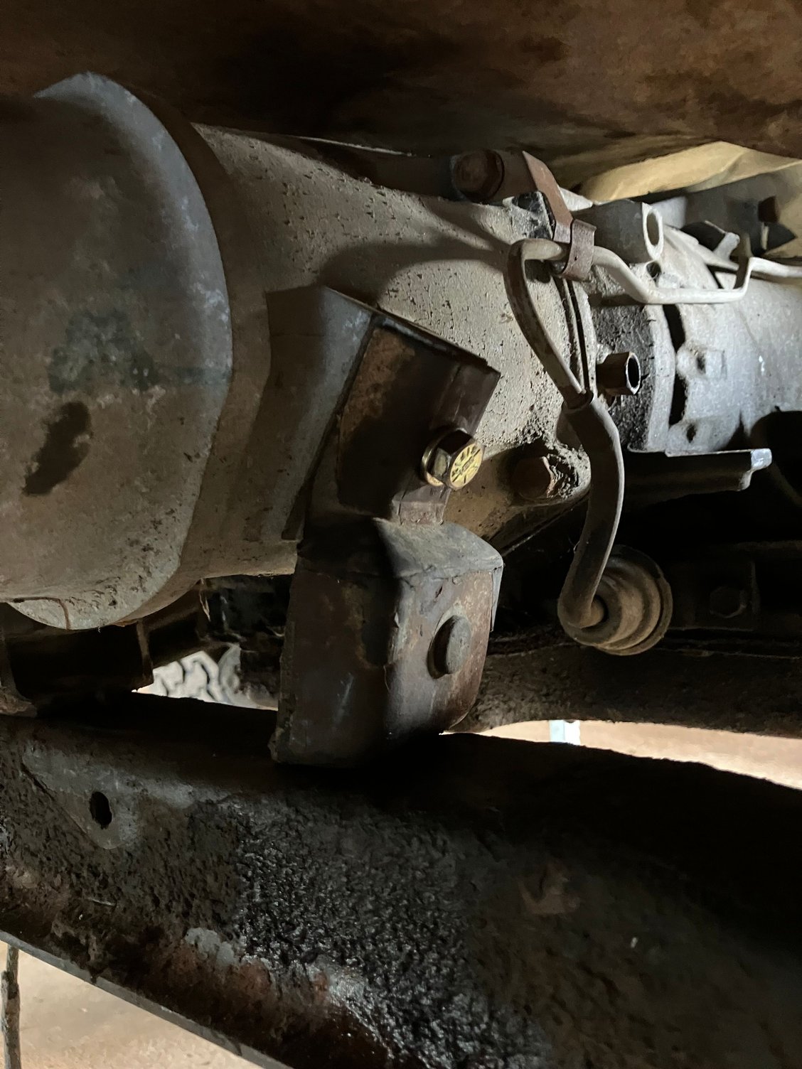

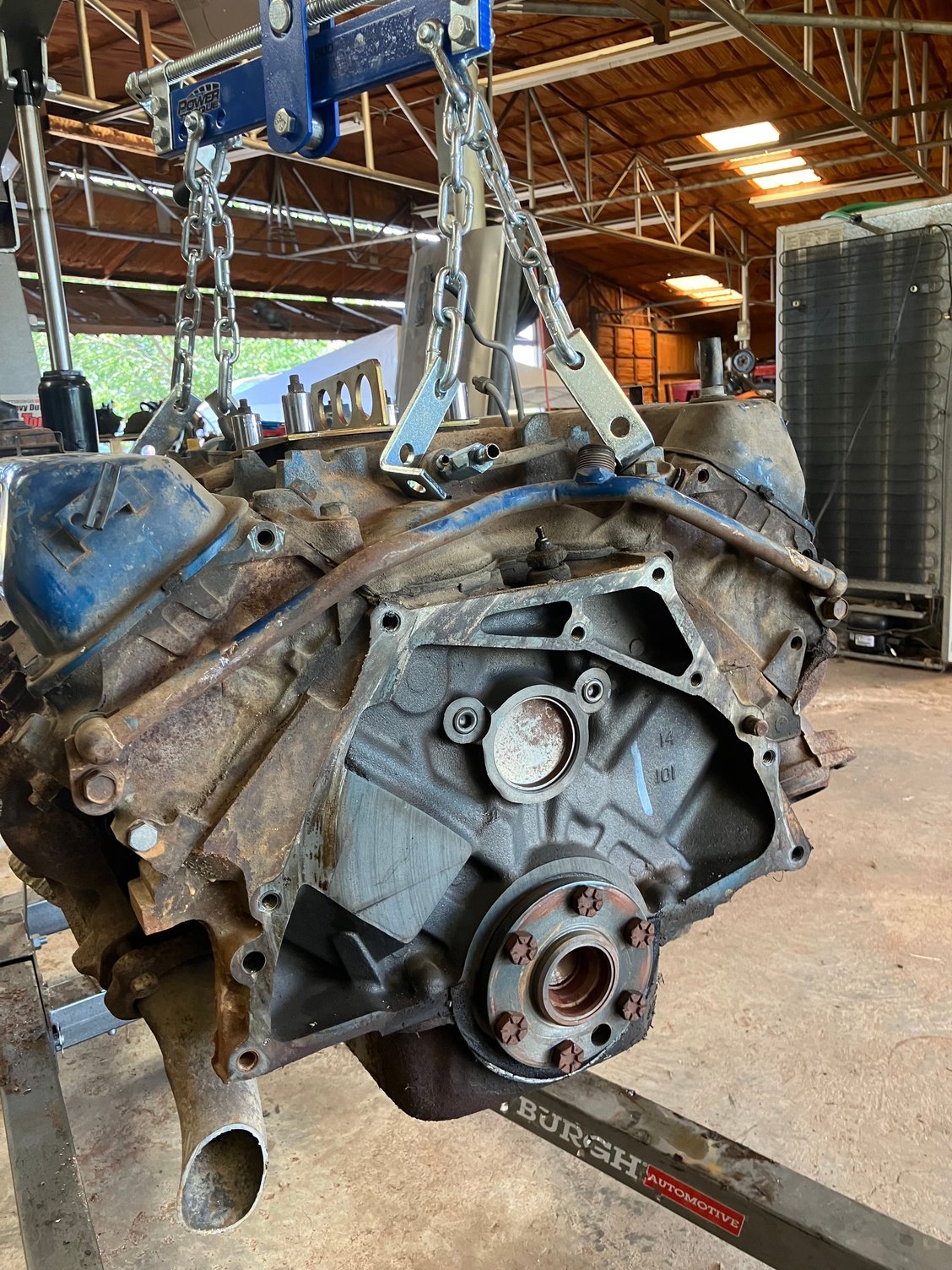

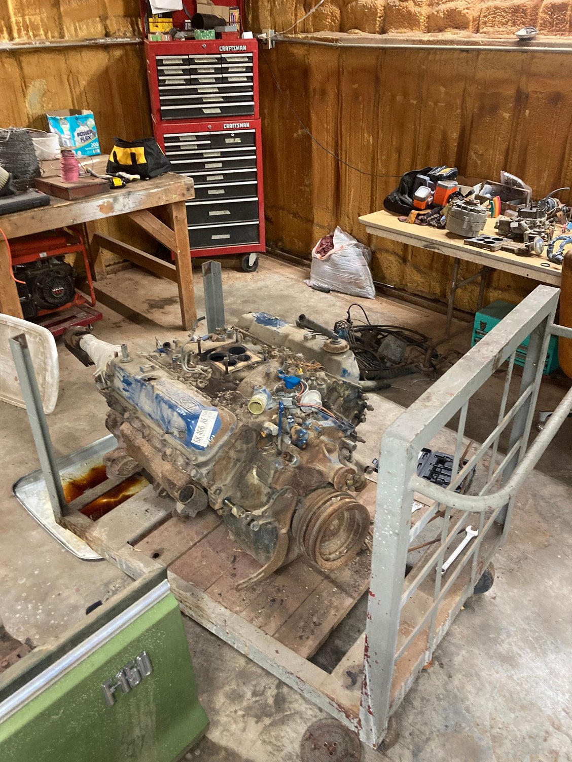

Ok, once again its been a while since i have updated you all i have made some progress, bust have been left with more questions lol, the oil pan i mentioned in an earlier post did indeed work, though i did have swap my oil pump as the new pan is rear sump, (ill have pictures at the bottom of post The motor I'm using also had a smog pump, dose anyone know how i can delete that, can i just cap it? i also just used the factory trans mount from the Lincoln, its not elegant but it should work.
