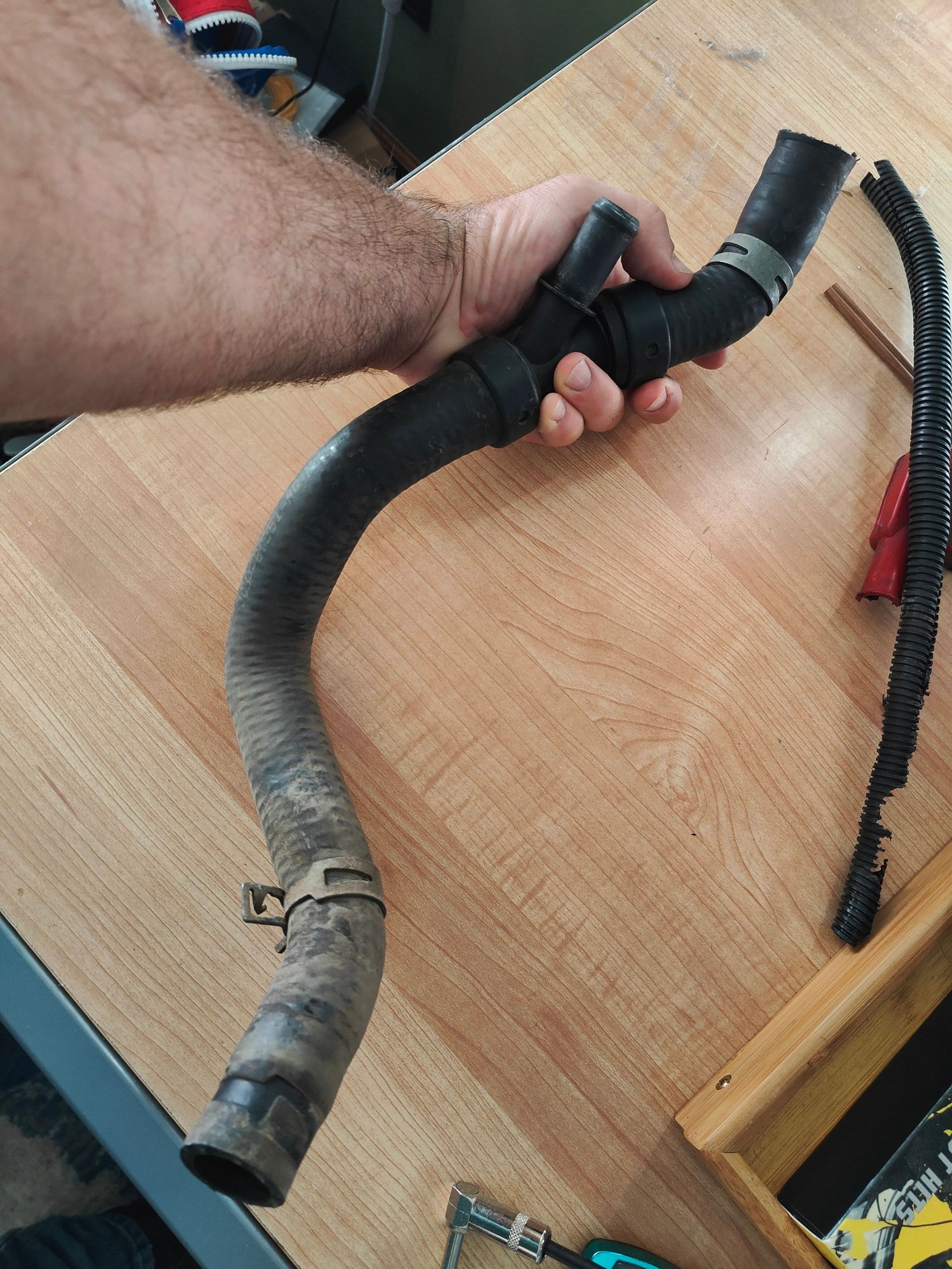

When I pulled my degas bottle to get at the squirrel mess this plastic three way connector piece snapped off. Kinda glad it did it now because it's is extremely brittle. Not sure how long it would have lasted if it hadn't broken now. Better while the hood is up than on the highway.
What do I need to look for to replace this?

Never mind. It appears to be a coolant recovery tank hose, Motorcraft KM4848. Special order of course.

Picked up an off brand version that looks like it will work from O'Reilly's. Also grabbed a new degas bottle/reservoir while I was there. I've been trying to soak mine in degreaser and water all day and it's just not coming clean. I also noticed some cracks in it on the bottom so I figured it's probably best to get a new one.
