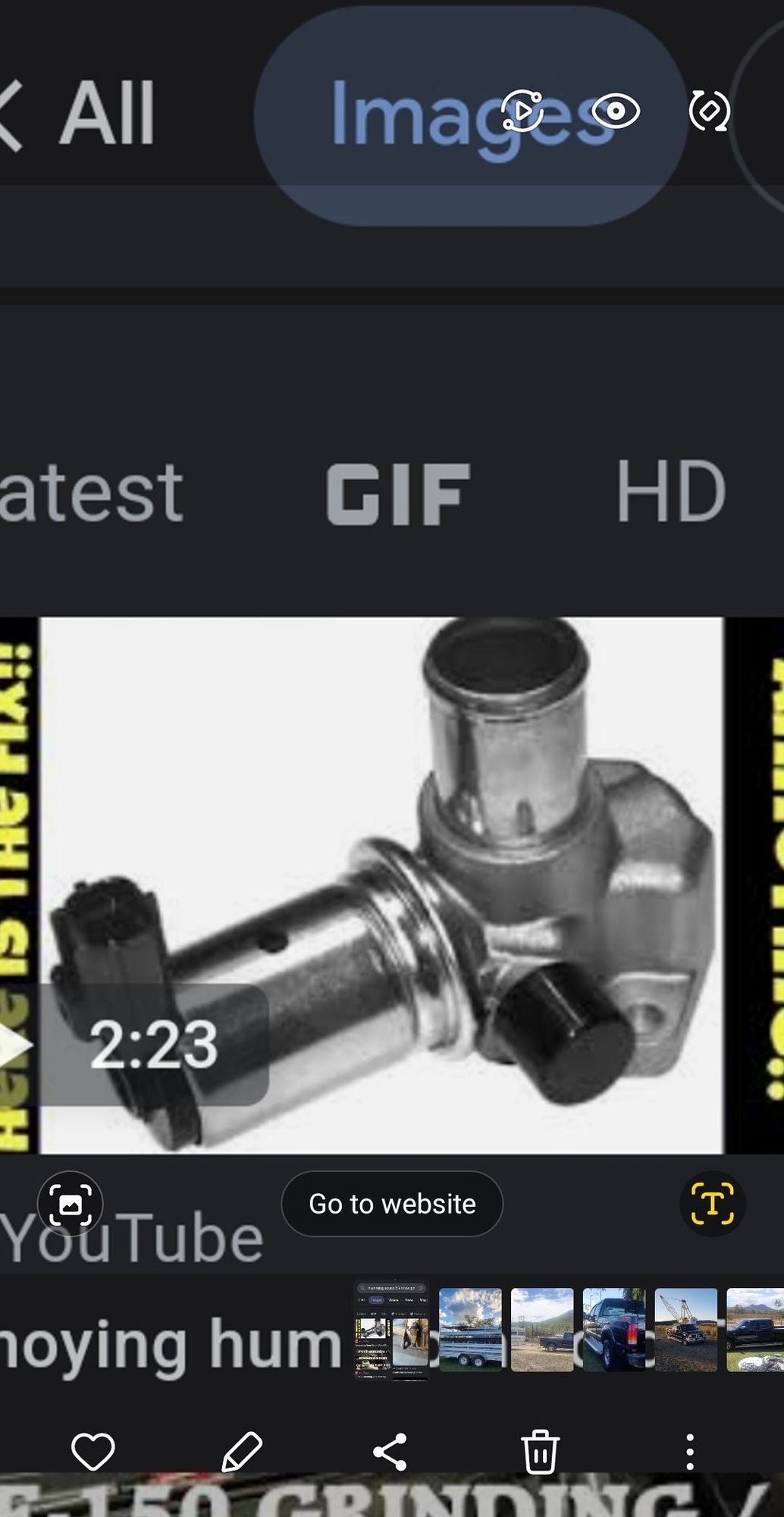

A 2006 F-250 5.4L would be a 3V engine. A 3V 5.4L wouldn't have an IAC. Is "2006" a typo?

Thanks for your reply. 😀 Photo attached is what we replaced. Definitely a 2006 petrol 5.4l I will have to check but a while ago i needed to know if it was 2v or 3v and i remember checking the marks on the air intake that is suppose to indicate 2v or 3v and ours was 2v. I will have to double check that now. 🤔
Edit: So it doesnt have 3V on the air intake box and the coils have the bent/angled rubber boots.
I did buy it second hand so maybe they swapped the motor out? Might be worth a VIN check.
This would explain why the listings for parts are all wrong at my parts store. 🤣

Super Duty gas pickup trucks 2005 and newer came with 3V engines, the 5.4L V8 and the 6.8L V10. 1999 thru 2004 were 2V engines, on pickup trucks anyway. E series vans, different story, as are motorhome chassis vehicles. F150s got the 5.4L and 4.6L 3V engine in 2004. Non US/Canada vehicles can have just about anything.
