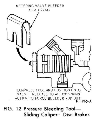

Did you address the metering rod on the proportioning valve? Some get pushed in, some need to be restrained in the out position. Mine has the one that needs to be held outward prior to / during bleeding.
I have this explanation and fig 12 for mine.
I don't have figures 7 & 8, but maybe this gives you a path to explore?

I pulled it out with vice grips and tried to bleed with the same results. It is directly below the Master Cylinder on my truck and not on / near the frame under drive seat like someone previously mentioned.

Some get pushed in. Mine is always out, but if I were to try bleeding with out some how securing it, it will pop in. The difference in brake pressure will trip it. Throw a red light too.
I don't know which disc you have, nor if sliding calipers or fixed calipers? What is the GVWR on the door tag?

6200, so I need to pull it out. Which I did with vice grips and a large screwdriver wedged in to keep it from popping back in.
