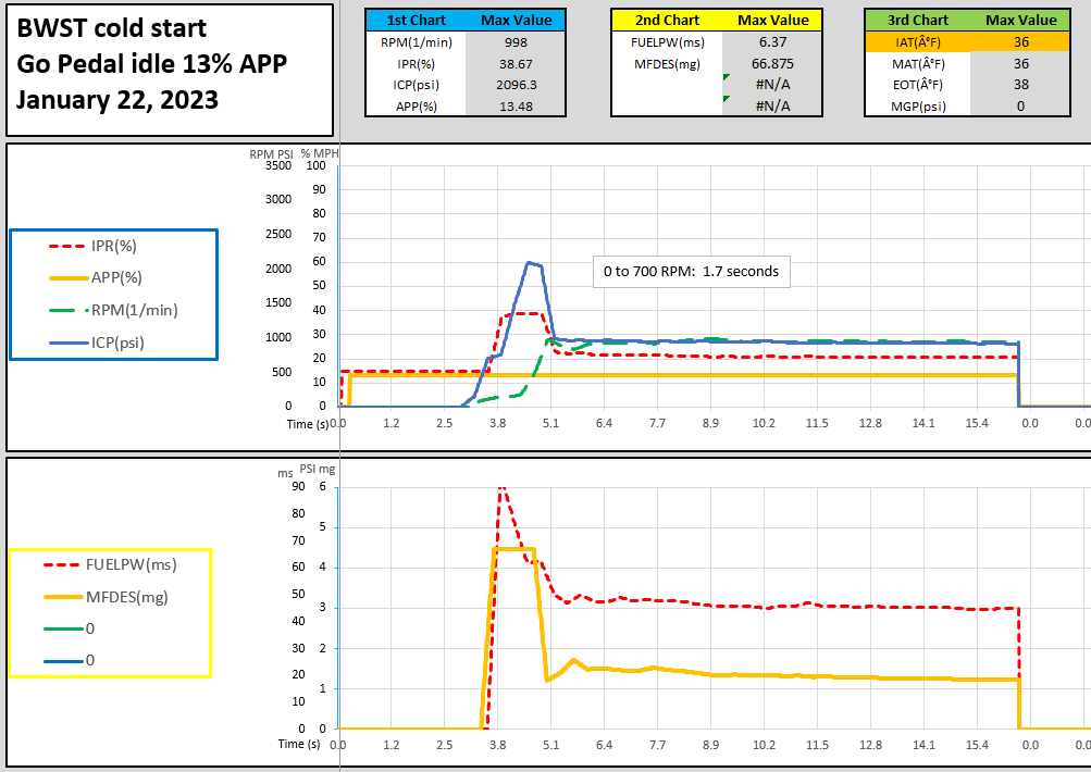

Take this data with a grain of salt - I was curious and gave this a try this evening. Just one test at 20% APP, and one at idle (13% APP). I should do a few more to see how variable this experiment is.
Moved the go pedal to about 20% first, watching APP on FORScan, then cranking the cold engine. As expected, RPM exceeds idle for just a bit until I let off. I used time from start of crank to reaching 700 RPM as a benchmark for a running engine. Results below:
Waited about an hour, and tried this again with the go pedal at idle. There was a measurable difference in start time. Note the max values. It is interesting that ICP peaks about 50psi less, and FUELPW peaks at almost 2ms more than the 20% APP test. Not sure why peak PW would be higher for an idle start.
Here is a cold start chart from January - outside temps much colder at 36 degrees F. RPM at idle is higher than 700 on cold start, as commanded by the PCM. IPR is higher, ICP is lower, and PW is much higher than the previous charts. Time to 700 RPM is same as having the pedal down a bit.
Sorry about the different horizontal scales - the charting tool autoscales depending on how many data points come in.
So what to make of this? The data seems to say that giving a bit of pedal results in a quicker start.
What is not intuitive is that the first chart with the pedal pressed a bit should have had a larger FUELPW, similar to the January cold start, but it does not. I will do a couple more tests to verify this data tomorrow.
