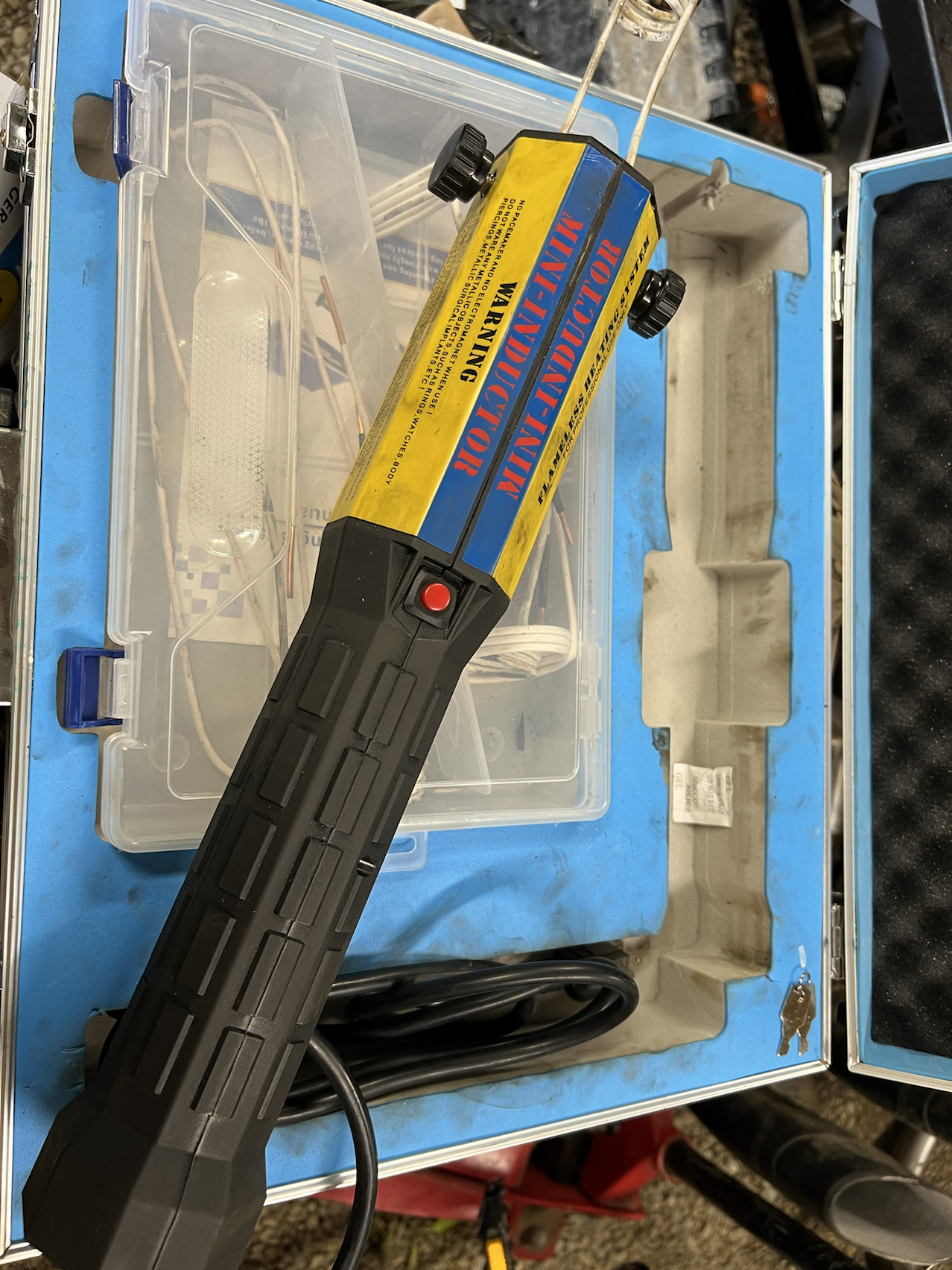

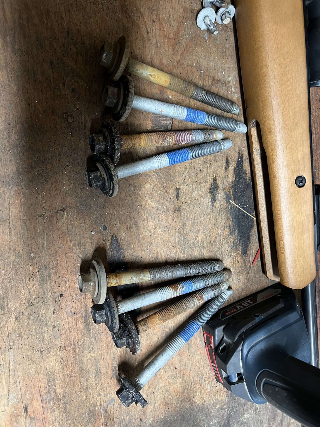

I found using a mini inductor WAY easier then a torch. Every bolt came out without any cage nut spinning.

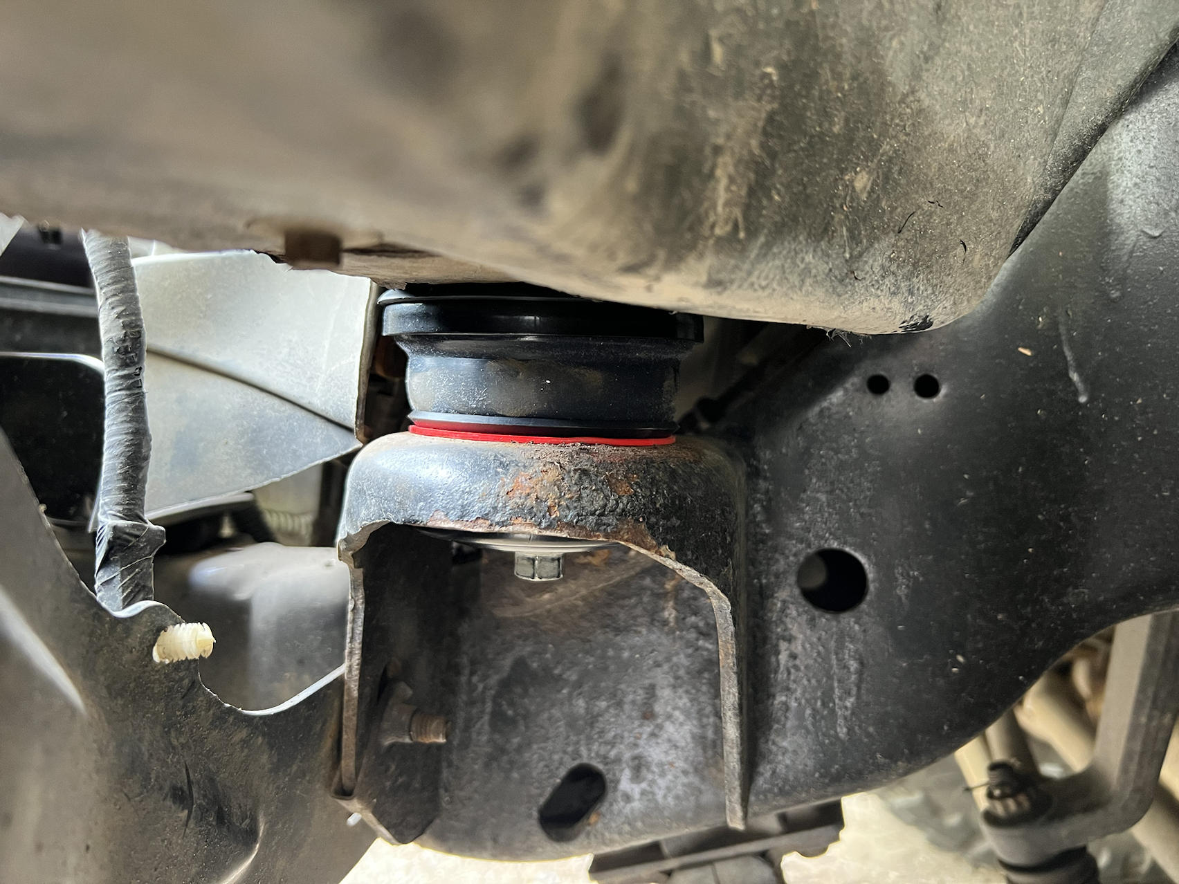

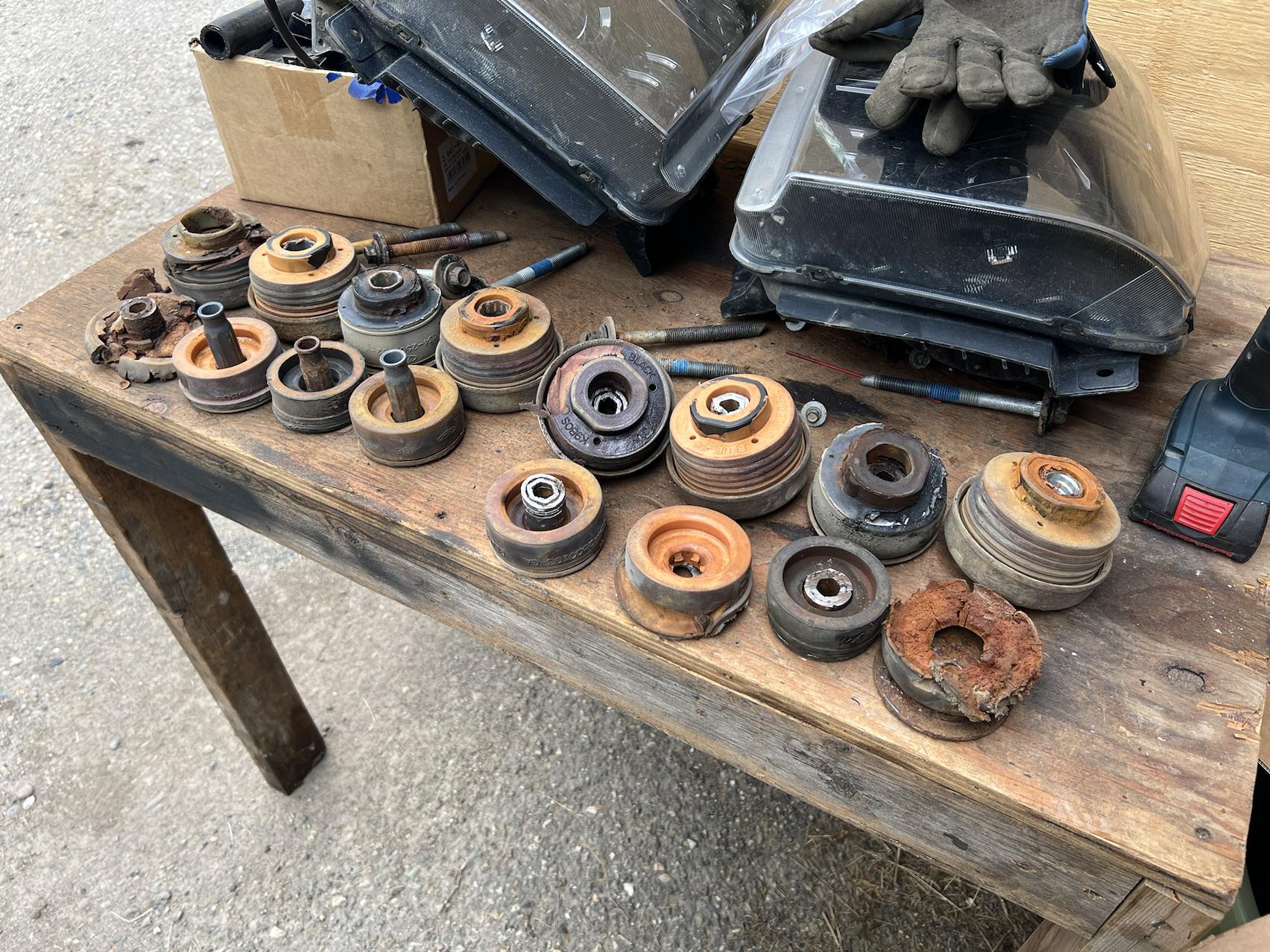

Just finished up today, overall I'd say I had 6 hours total, which isn't bad for a job like this on a northern truck.

Haven't taken it out for a ride yet to feel any improvement.

Never used one, only an acetylene torch when working on rusty vehicles.. Do you have info on the inductor? Sounds like a good alternative if you can avoid some slag & fire.
They're on Amazon for about $250-400 CND. The wire coil goes around the bolt or nut and will turn it red hot in a quick fashion. Definitely safer than using a torch.
