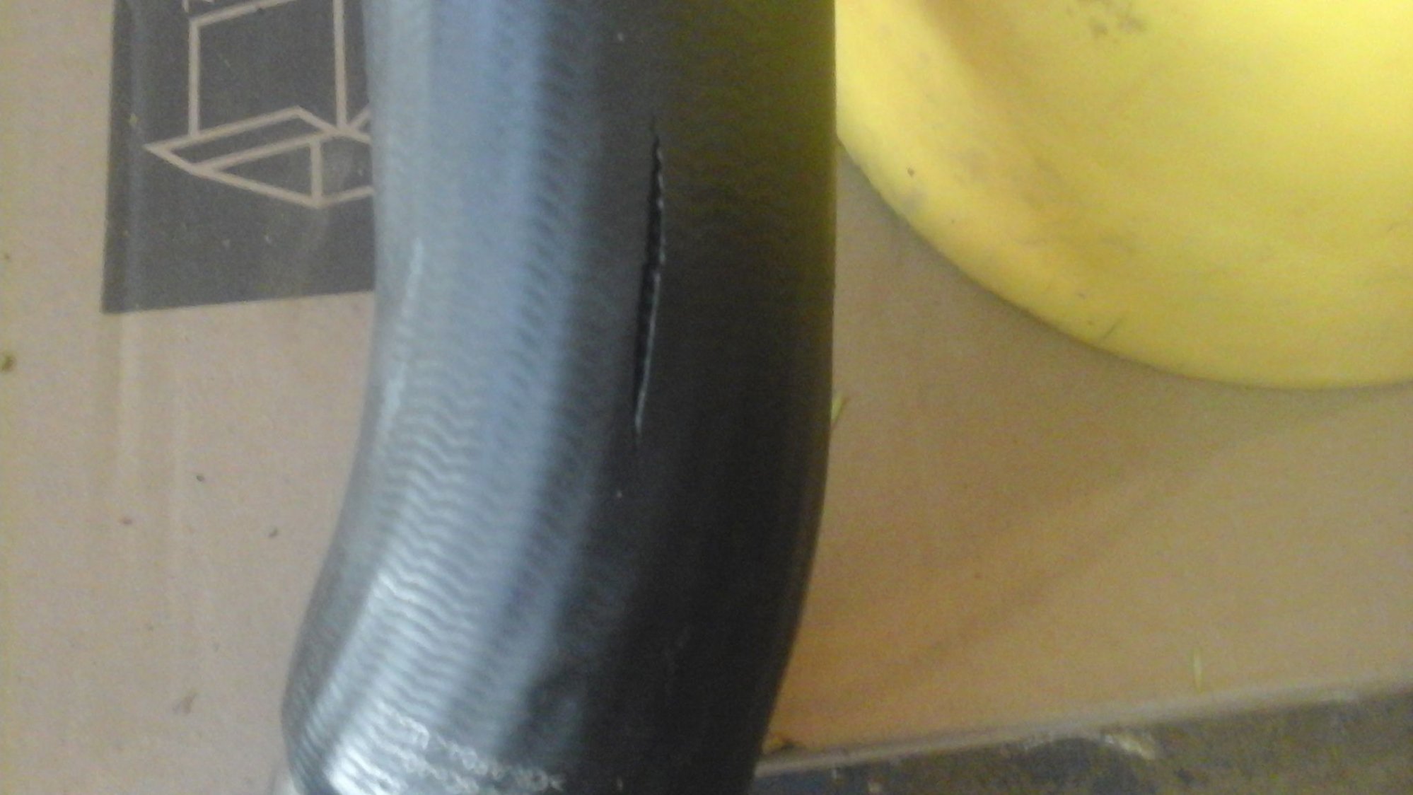

Found a slit in my 17 while doing a dpk.

So it looks that instead of the plastic pipe of the 11 to 16s popping, the rubber hose of the 17s plus popping...
Better off going aftermarket with either metal pipes and more solid silicone couplers or go with a full silicone pipe replacement with the metal adapter for connection to the EGR valve body and for the IAT sensor...
