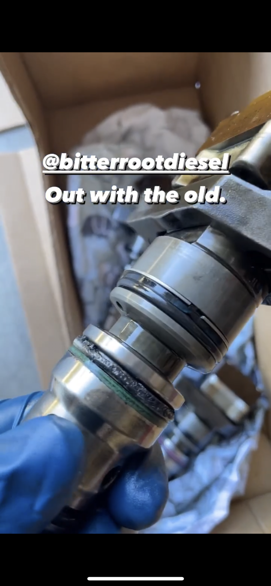

As the title states. When I start my truck in the morning it’s very Smokey. It has been consuming some oil and seems to have a slight misfire when cold. so I’m hoping I don’t have deeper issues. Temp is 55°F
I have MANY pictures of this truck doing this in the mornings. I bought it in December this year and chalked it up to cold weather (-30/+30°F throughout the winter) glow plugs or o rings. Both have since been replaced
so I threw in a set of injectors over the weekend. My thinking was the burning oil and Smokey startups were just bad o rings or something to do with the injectors. When I pulled them 3 of the o rings were visually shot.
I bought BDP 160/0. I’ve put 75 miles on them so far. But the last 2 mornings the truck is still smoking. fresh oil and filter. Fresh air filter. Fresh fuel filter.
Glow plug system has been replaced already with OEM ford plugs from riffraff. I did use a Napa relay so maybe that’s part of the issue?, but it tests ok voltage wise. SD UVCH didn’t help or change anything either. I’ve also gotten custom tuning since to help with towing but that didn’t change anything on startups.
im hoping after some more miles the smoke clears up on startup (maybe the air in the oil system is affecting this?) But I’m thinking it’s not going to. Any ideas?

I can’t tell. It burns the eyes like unburnt diesel. But I was losing some oil before the new injectors. 3/8 injectors had chewed up o rings also. So I thought I had found my problem then and there
