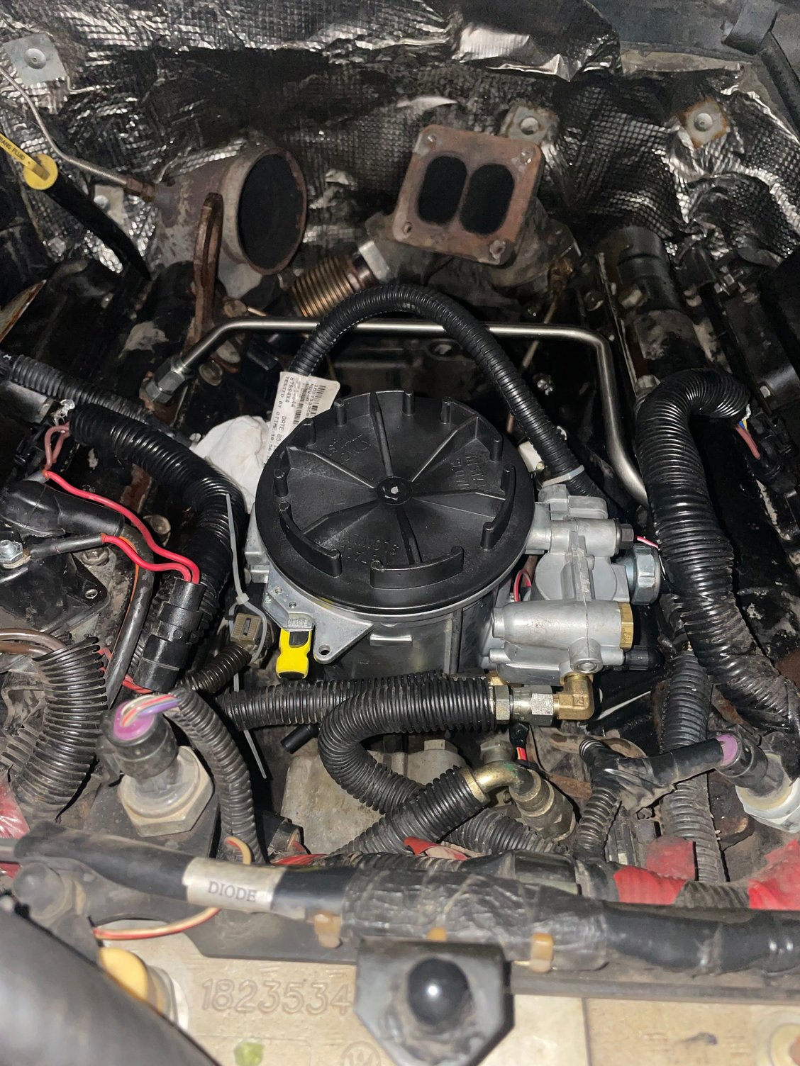

Making progress on my way to putting the turbo back in. New fuel filter housing and fuel pump. OEM from Riffraff. Not sure I routed the harness correctly. But I don’t feel like pulling it back out at the moment. Cleaned out the valley of the engine. Just waiting on turbine housing and heat shield to arrive tomorrow. Will put truck back together after work i hope. See what happens.
wish me luck reinstalling the t-4 to the back of the turbo. Those lower bolts are gonna be a B.
Also this winter on a different OBS I replaced the pump and fuel bowl. It almost didn’t start due to the air in the system. Could I just fill the fuel bowl up with diesel manually before starting to crank on it?
Out with the old
New fuel filter housing. ( I find it easier just to buy a whole brand new setup.) RR Diesel was out of stock. Believe it or not Home Depot had OEM motor craft in stock. So I snagged one and had it shipped to the store last week.

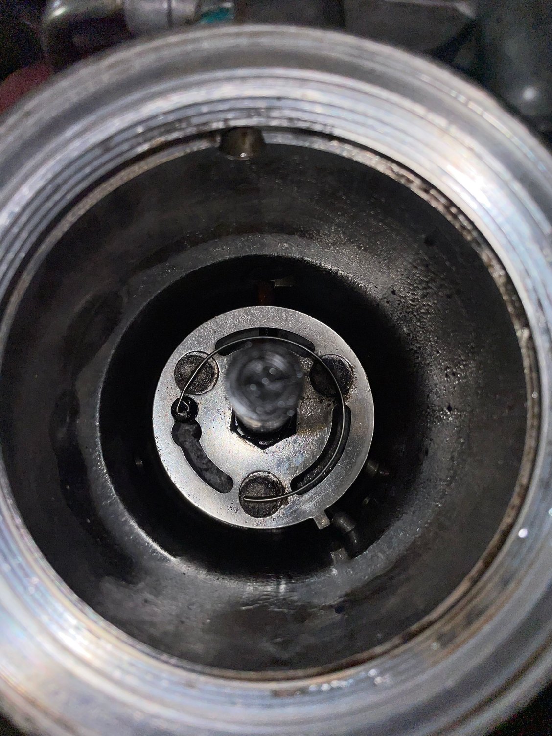

New fuel pump (fuel lines were replaced earlier this winter. I should’ve done everything back then with the fuel system. Just didn’t have the $$$)
FPR Screen on old fuel bowl COMPLETELY BLOCKED/CLOGGED

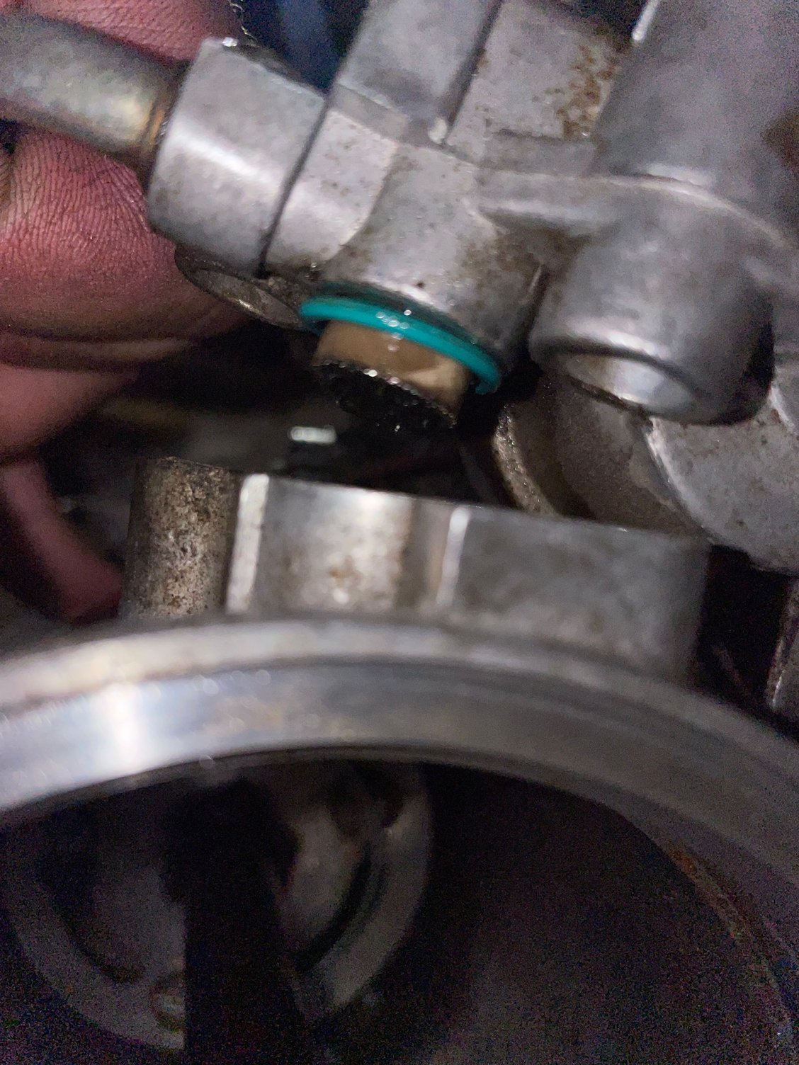

Another angle of FPR
Fuel bowl somewhat dirty and gritty. I cleaned it out a few months ago. But couldn’t get it all. I believe this was the OEM fuel bowl and fuel pump. I had a diesel leak in the valley also

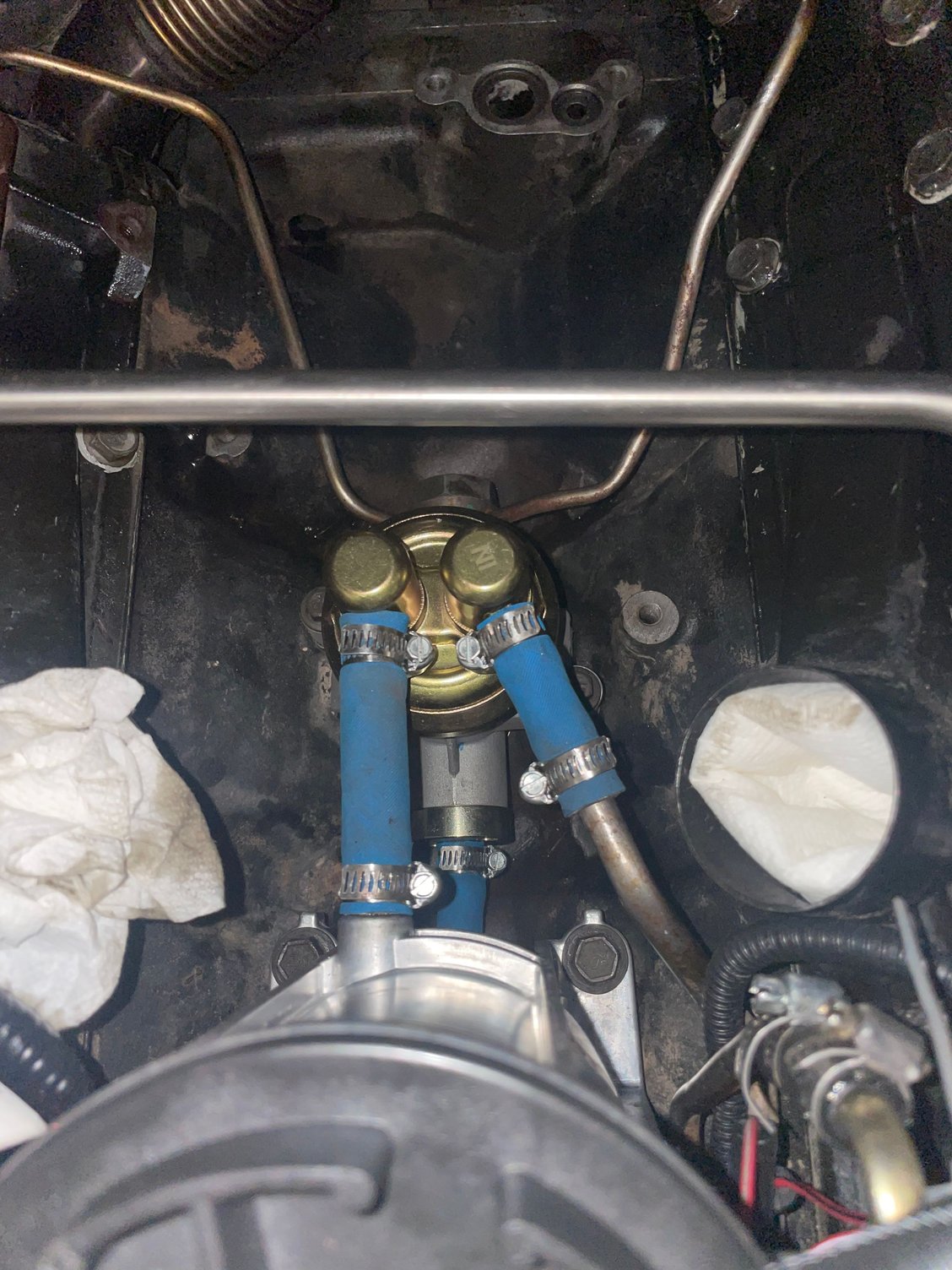

ID highly recommend replacing the fuel lines from head to bowl if they are original(they appear to be) while you are in there.
These are getting old and brittle at this point and seem to be more failure prone once disturbed. Riff raff sells both the motorcraft lines and a coted stainless braided version of their own.
It’s on the list of to do’s. Can’t do it all right now financially. But hopefully that doesn’t bite me..my funds are dwindling 😳 I thought about doing that. I’ve just dropped so much $ into this thing lately. I hope it holds up. My luck they’ll fail now .. 😱

Yup on the lines, my son's 95 had a fuel leak Wednesday, I touched the driver's side line and it broke in half. Lucky for him I keep a pair in stock, now hopefully he replaces my stock!

$70ish for riff raff bout the best deal out there

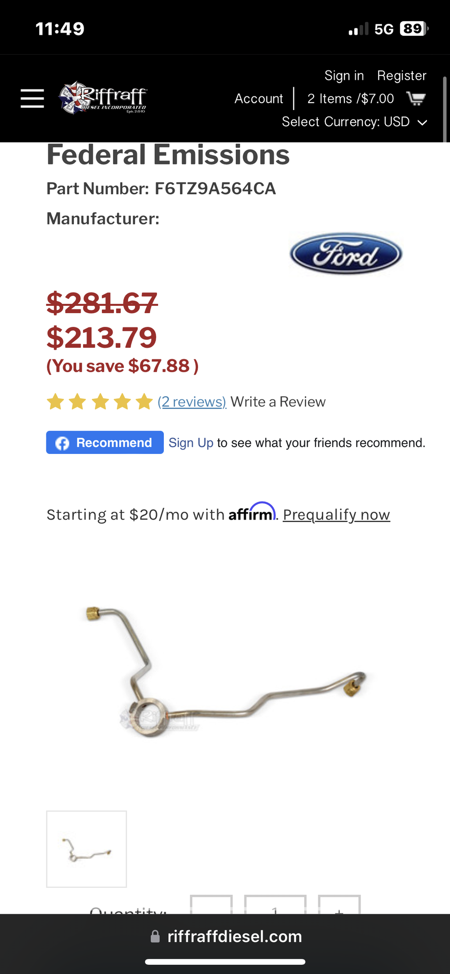

https://www.riffraffdiesel.com/fuel-...sleeves-hoses/
link didn’t work
*Edit* sorry I didn’t see the arrows. Yeah. They probably do need replaced. I thought you were talking about the steel ones
You’re talking about this aren’t you?

Originally Posted by DanielT28
link didn’t work
I was referring to these
sorry, should have made the arrows bigger
Driver Side SS Braided Fuel Line 94-97 (RDP-FFL-OBS-DS) (riffraffdiesel.com)
Passenger Side SS Braided Fuel Line 94-97 (RDP-FFL-OBS-PS) (riffraffdiesel.com)
