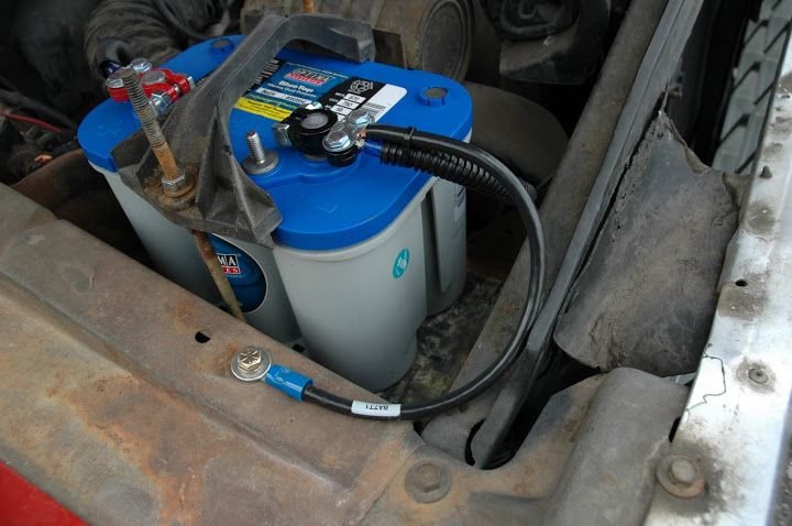

Well since you have a MSD distributor, NO telling what it might be. But hard to start issues I'd check both battery terminals. Get the ones you make, NOT the all in one molded ones. Check and clean ALL grounds and add an extra one.

I hear them battery clamps are the worst and only good to get you somewhere to get a proper cable / clamp.
Because they "clamp" the cable it can raise the resistance at that point and it is open for acid to do the nasty and raise the resistance.
Yes I know you dont have that issue with acid with that battery.
I hear you on that one, I just wanted to cover that using the basic ones from most auto parts store, that are all in one molded ones are junk IMO. I had chased a elec issue for quite awhile. Come to find out it was those cheap ol molded cables having an internal failure, that I could not SEE or test for.
How about these for a DIY battery cable ends?

To help with the common corrosion on the battery post/terminal connection area, once all connected I coat/cover the connection with dielectric grease. Silicone grease, even regular automotive grease works to stop corrosion. WAY better than those red/green fiber disks.
