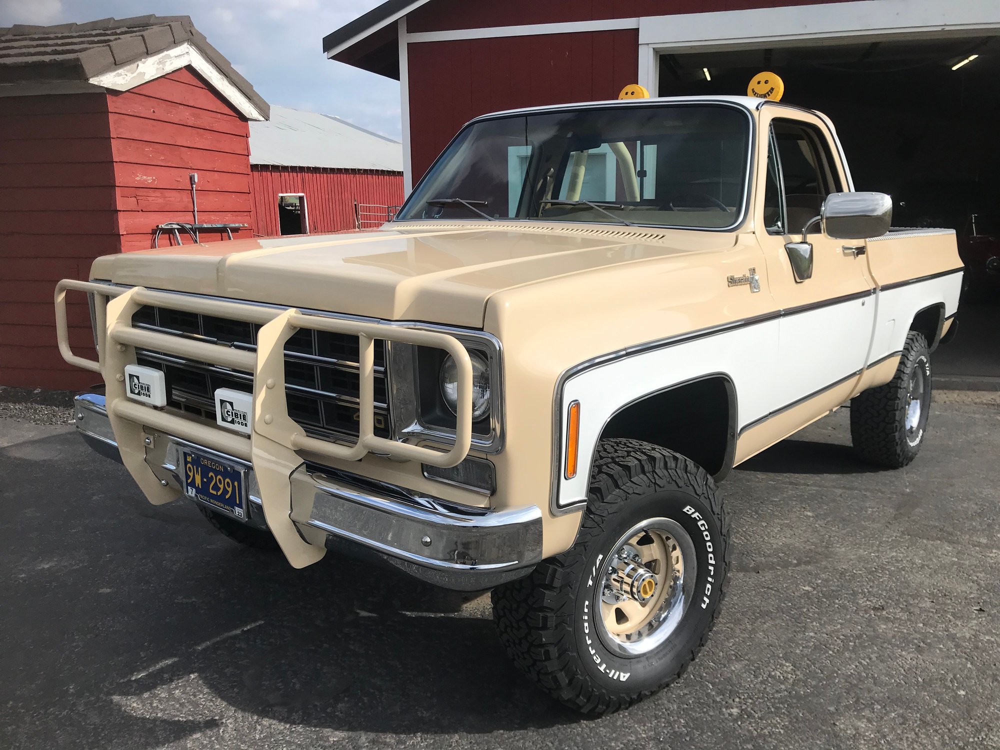

This is a chevy obviously I don't have any Ford 1/2 tons anymore. but I ran the same 32/11.50-15's on it and it looked about the same in the wheel wells. 10.50's are the most popular and probably the best for absolute clearance but the 32's should work if your springs aren't too saggy.
32's on 15x8 wheels , 4.25 offset.
