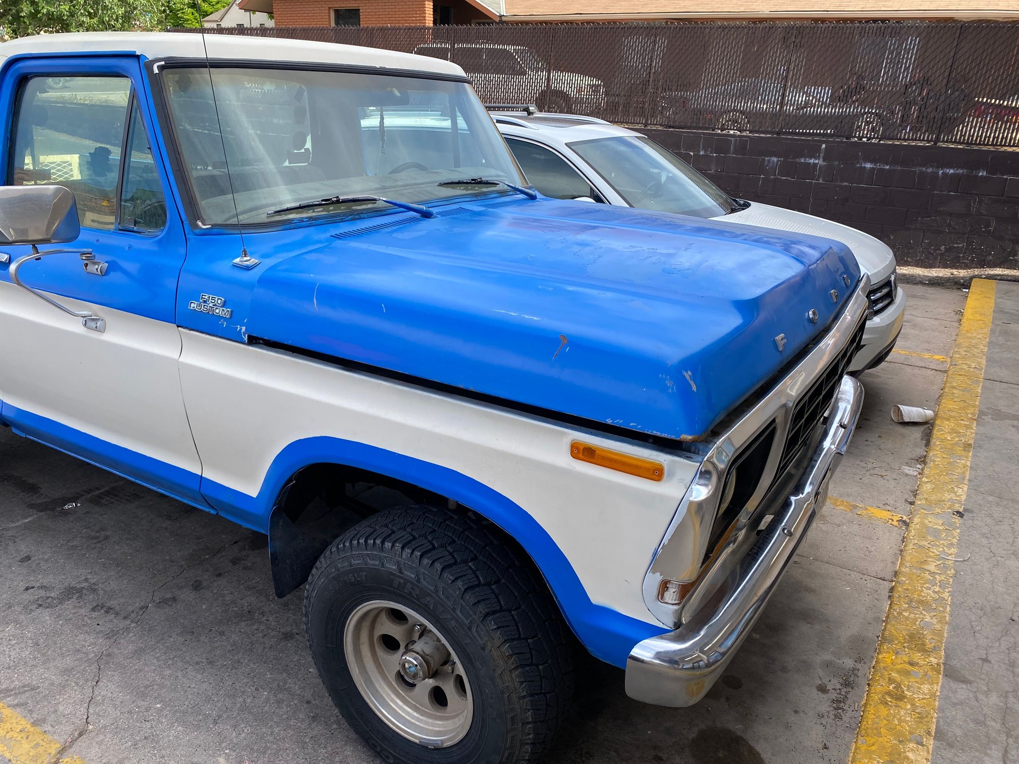

I need some help with good alignment. My drivers side alignment is fairly decent but my passenger side is way off. I’ve tried pushing the hood up while pushing the hood up and I can’t get it to go down further I think the hinge may be bent. I’ve attached images to show the huge gap. Any help is appreciated:

From the way it looks in the picture the hood hinge is too high.
You tried loosening the hinge bolts and move it down a little.

Rear of hinge down, front up to take hood down. Reverse to take it upwards

Right that’s what I did but I physically cannot get the rear of it to go down any further

I take it they are lubed really good?
Hit the hinges with PB Blaster and work it in.
Hoods & hinges bend when the hinge can not move.
The other is what you got going on as it will not relax enough to sit all the way down.
And yes the hinge(s) could be bent but also look at the frame of the hood to make sure it is not bent.

I used a cherry picker (engine lift) and a short length of rope to lift the hood from center front where the U-shaped latch is. This allowed me to manipulate the hinge on both sides (down in back, up in front) and then tighten it down before anything shifted.

I got the hood mostly fixed. Turns out where the hood bolts to the hinges needed adjustment. The passenger side of the hood was about 1/8 inch closer to the cab than the driver side. I loosened the bolts, closed the hood about halfway and gave the passenger side a good pull and it dropped right down. Still needs a little adjustment but way better than it was.

#1 To get the back of the hood down to line up with the cowl, loosen the 2 very back bolts on the hinge flange where it bolts to the inner fender and then have someone push the hood up standing in front of the truck while you tighten them back down. Not a lot, might take a couple of movements to get it where you want it. Close the hood slow, DON'T SLAM IT, watch the back while it close's. Next, to get the gap the same all the way across you loosen the hood bolts on only the side you want to move, if your closing the gap, tap the back of the hinge arm with your ratchet handle and the hood will move on its own, if you want to widen the gap, loosen the bolts and pull up on the back of the hood and tap the hinge arm on the front side and the hood will slide forward, always close the hood slow after any adjustments to make sure it’s not going hit anywhere.
To tighten the front of the hood, theirs 2 bolts on the hood latch that are slotted, you can see the slots if you look, loosen them and tap the latch down, if you go to much the hood wont latch, bring it back up, I have to slam mine hard to latch so the hood down bounce on the corners.
#2 Hood: Often the hood sits up above the cowl. To fix this, adjust the hinge where it mounts to the inner fender. Up at the front, and down at the rear. Reverse procedure to raise the rear of the hood. The hinges should be lubed with a good lubricant to operate properly or your alignment wont work no matter how long you play with it. (you should be able to almost throw the hood open with the flick of a finger)
#3 Set everything in the middle, hood hinge to inner fender bolts and the hood bracket bolts.
I like to remove the latch at first so I can easily swing the hood open and closed.
If the rear of the hood is sticking up when it is closed you actually adjust the hood to open MORE. Either by lifting the front of the bracket or lowering the rear of the bracket. Sometimes both in combination. The center bolt acts as a pivot.
Once that is done, and it can take a while to get everything nice and the gaps decent you then set the latch height.
If the hood is maxed out forward and is still interfering with the cowl you'll then need to loosen the inner fender to firewall horn bolts, inner fender bolt and radiator core support and move everything forward.
If you're hood is high compared to the cowl loosen the middle bolt and the rear bolt, then open the hood and it will push (rotate) the hinge down and towards the cowl.. Look for the clean marks that the bolt head will leave behind for reference
