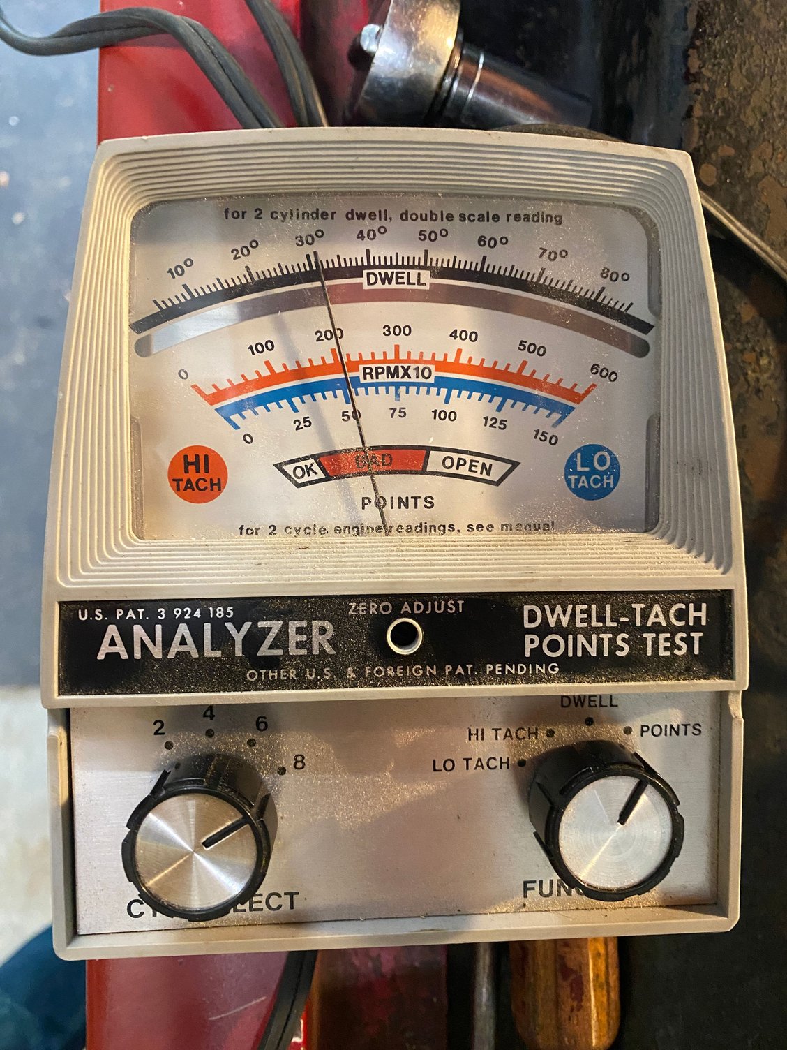

I honestly don't believe we set the dwell. I do have an old school dwell tester that I never used, had it passed down to me. The timing is set at 9* anything more or less the engine didn't seem to perform as well. I could be wrong on the 15/16 with the vacuum, but I can check again (I should've written this down, as I've been checking values all last week). The advance port is on the carb.
The timing light wasn't jumping all over the place so I'm not too concerned its related to the chain. Like you said, with less than 30k rebuild it should be good still.

I have a dwell tester but aren’t dwell and setting points with a feeler gauge the same thing? We set the points prior to timing but with a gauge. My fuel tank has emission on it so the book calls for .021 on the gap. I believe it was set to just under that. But I’ll test out my dwell tester and see what it says. I would need to readjust timing if anything changes here correct? Any tips on how to do this without a timing light available right away?
Old Jun 23, 2023 | 12:02 PM
sevenoneranger's Avatar
sevenoneranger
Joined: Apr 2023
Posts: 37
Tried to hook up my dwell reader. The only thing is its old school, I dont have instructions and got info off the net. Says to connect black to ground, red to positive, and yellow to neg of coil. I wasn't able to get readings when it was set to "dwell" but switch it to "points" and the needle started to move, this is what it looked like. I double checked gap prior to starting and it was at .021. This time around however, the truck didn't want to start on restart immediately after running to operating temps and shutting it down. Had to feed some fuel to it and rev to idle. Felt similar to the engine flooding thought I didn't give it much fuel.

I am to lazy to get my Motors book to see tune up spec (guessing) 70 with a 360 motor but found this on line.
The plug gap should be .035
The timing 6 degrees btdc
dwell 24--29
point gap .017
I also found for a AMC v8 a point gap of .016 and dwell of 28*
So your .021 gap and looks like 32* dwell is a little much.
When I had to deal with points I set by gap as a starting point but dwell was the final setting.
Also note as the plastic rub block on the points wear the gap / dwell changes as will the timing.
This will throw off smog, that is one reason why everyone went to electronic IGN.
Yes dwell needs to be set before timing because point gap change changes dwell that changes timing.
As for setting timing with no light you can do this 2 ways but it still is try it and see deal.
Vacuum gauge adjust for a high reading but you will need to test drive to check for pinging and for hot start, no kick back.
The other is be ear and again you will need to test drive to check for pinging and for hot start, no kick back.
